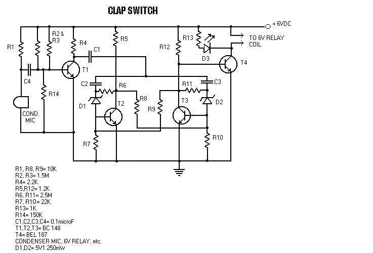

Im new to this stuff, and i tried doin a calp switch. The problem is i dont know how it works, the basic principle, what each component does, and the mechanism behind. I tried looking for it on the web but i found only clap switches based on IC and not Transistors :cry: . Plzzzzzzzzzz. can anyone help me on how a Transistor Clap Switch works?
P.S. : If anyone has a diagram or know whare i can get one, plz, inform me. Plus my e-mail address is briggs77us@yahoo.com.
A clap switch is nothing but a simple bi-stable flip-flop which toggles its output (1 to 0 or 0 to 1) whenever a clock pulse is applied to it. In a clap switch, the sharp pulse created by a clap serves the clock to the flip-flop and ths it turns the connected device on and off.

Long back I had built this clap switch the schematic of which is shown below. Hope this is what you want.
