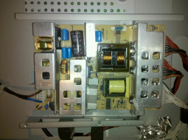

SHELDONTV - the board i replaced was the top one of the two larger in the middle ill try to get a pic up on it tommorow, but it was the one the power connector plugged directly into after hitting the unit

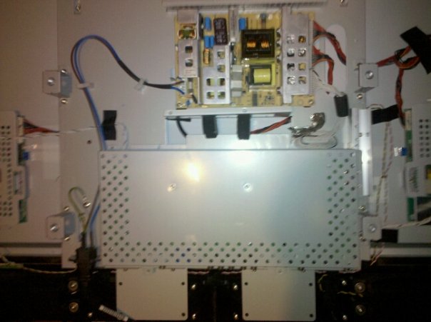

heres some pics, the one from further away is the whole open back of the tv, the closer one is the board i replaced
