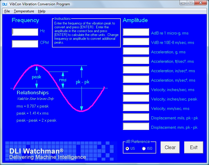

I have a circuits ( vibration measurement ) which is giving output in mm/sec. and displays frequency also.
ex: at 80hz if it shows 10 mm/sec.
with these details i want to calculate acceleration and displacement also.
Can any body give me calculation details in this subject.
thanks and regards
joshua.svn
The mm/s is velocity. Differentiate it to get acceleration. Integrate it to get displacement.
Vibration conversions are valid for sinusoids only - not from broad band measurements. If you are measuring peaks with an FFT or through a tuned filter, you can convert between displacement, velocity and acceleration. The VibCon vibration conversion program may be **broken link removed**

Dear friends ,
thanks for the help but i need formulas for ma thematic conversion and need calibration details also because
the censor i am using is ctc make 100mv/g
thanks and regards

joshua:
Why are we hand-holding you? ctc has what you nned to know here: **broken link removed**
That's the first place you should have looked.
On the same page as VibCon above....
**broken link removed** includes conversion formula. Sorry I didn't specifically point it out.
CTC has excellent reference material too.
