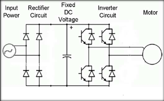

hello everyone.
This is my first post in here and before starting, I embrace everyone with love:).
My project is VFD drive.
The VFD must work on phase voltage and must controll with Spwm. Control signal circuit is working well and the h bridge also good. But the problem is , im not sure to use power supply to my project.Motor of the output is 500VA single phase induction motor. It is working with 230V 50hz nominal voltage and frequency. Project must be small size of component so i desided to not use a transformer for this project. Although high current requirement , as you know the size of the transformer getting much more problem. Because of those issues , im not prefering transformer. Also the risk of the transformerless power supplies known in the past. Is there any possible circuit agains of transformerless scheme?

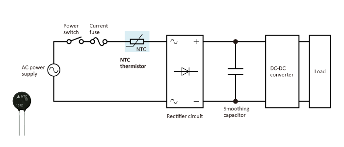

Note that for the power input side, a "soft start" circuit is normal. A power resistor is connected between the input bridge rec and the power capacitors & the controller monitors the cap voltage. Once they are within the allowed voltage range and the voltage stops increasing, a relay links out the resistor so full power is available and the power output control can start.
Some power modules have the input bridge included as well.
Dimmer circuit ojnly regulate average power, to control an induction motor you need to change frequency.
Why would you need a big transformer? If you have the correct voltage input your only transformer will be a small one to power the solid state components. This link gives some information on a chip and the circuit that is used in a single phase VFD, Fig. 6.3 in the link.
https://www.lz2gl.com › data › eg8010_datasheet_en
Exactly.
A three-phase version is just like your first schematic in your first post in principle, but with a third half-bridge added for the third output!
(And a three phase input if it's to run on a three phase supply).
No commercial drive I have ever seen uses a transformer for the main power through the unit. They may have chokes for interference suppression etc., but not power transformers.
The only reason for a high-power transformer is for safety isolation while prototyping - but the internal voltages are still lethal if you touch across the caps or output, so extreme caution is still required, transformer or not...
