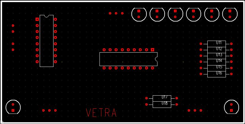

VETRA on it's way!
Krumlink
3v0 and I were working on IR detection, and after some brainstorming, we came up with creating a IR robot, That could explore a room autonomously, and would be able to be reprogrammed through a 2x5 ICSP port on the side of it. I am currently working on the PCB still, but it will be done very quickly.
18F1320 Brain
2 IR Emitters
2 IR Recievers TBD what they exactly are
SN754410 Motor Driver
The hardware would be exactly the same through out the design, but it will come with a ICSP header in case you want to change a part of the code.
More to come soon!!
EDIT: The pic is a VERY early stage in the Board, but the IC's and LED's are likely to stay there.

Krumlink said:
2 IR Emitters
I'll try one more time?, check my website I posted a link to previously for you, you only need one receiver and two emitters - it's not something I designed and wrote, I just used the original designers product.
Yes, I looked at the site, but for simplicity we are going to use 2 sensors and 2 emitters, each easily representing Left and Right side. Maybe you mean 2 sensors and 1 emitter, but the emitter better be pretty bright!
Besides, It will as i already said represent the left and right sides better.
No, one sensor and two emitters, it's all that's needed - brightness of the emitters can be altered to increase the range, but it's basically only short range anyway, and highly dependent on the IR reflection properties of the object.
No it wouldn't, but feel free to use two receivers if you like :)
Oh i get at what you mean now, just in the software tell when it left side is on and right side is on?
That would not work very well (cyclops robot) because, this robot wants to tell if it is going to hit left side or right side at the same time. It would only be a limiting factor.
Not at all, the 8 pin PIC outputs signals for left and right, both together mean an object directly in front - as with anything electronic it's far, far faster than the mechanics involved in the robot - it works extremely well, and just as good (if not better) than a double sensor solution.
By using a separate 8 pin PIC all you need to do is check the L and R pins from it, I even added LED's on the output so you can see what's happening.
1. I don't have any 8 Pin PIC's nor do I want to deviate from the 18F series (You used a PIC12F right).
2. A 1 Sensor 2 LED design does not make sense, unless you sent a signal through the LED's, even then it does not make sense.
3. For ease of programming, a 2 sensor design would be superior, because all you have to do is when it detects an input it reverses, when it doesnt drive straight.
4. A "cyclops" robot has a disadvantage over a 2 eye robot.
5. From your description how would the sensor be able to tell what side from what? remember that I am learning C, and I am not going to use Assembly in this robot, and It will just make it more complex.
It used a 12C508, it long pre-dated the 12F series - a 12F would make more sense though now.
Makes perfect sense, and is dead easy to use - you simply send 38KHz pulses out one LED and check for a reflection on the receiver, then send 38KHz pulses out of the other LED and check for a reflection on the receiver.
Exactly the same as you do with two receivers, except you only need one.
Exactly as a single sensor does, you check for both left and right objects and reverse the appropriate motor(s) - BTW you can't just reverse if you find an object ahead, you need to turn as well - my original code turned either direction at random.
It's not a 'cyclops' robot, it detects from both left and right independently, but just doesn't waste an extra IR receiver - no disadvantage at all.
Explained above.
It makes it incredibly easier for you - just use an 8 pin PIC like in my project - this connects via two pins to your 18F PIC, one for left, and one for right - all your C program needs to do is check if the pins are high or low.
Like I said previously, I didn't originally write this - but it's fairly complex in operation, because it uses a voting system to reduce false readings - certainly I found it extremely effective.
its not looking straight ahead! Both sensors are looking at a 45 degree angle, that way if left detector senses a wall it backs up the opposite side of the H bridge, but if right side does not detect it goes straight, making it turn.
With a 1 sensor design it can only look straight ahead without favoring one side.
That's fine for an object either side - but what for an object directly ahead? (like a wall) - if both motors reverse what does it do next?.
No, it looks both left any right - IR receivers have a wide acceptance angle - hence why you only need one of them - you position the LEDs for the actual beamwidth you want.
I am going to use a 2 sensor design since I have experience with 2 sensors like that. Also because the sensor is actually bulging out of the packaging slightly, it is a very wide angle reciever. I will be able to see in front slightly , and it will most likely be around 30degrees from straight ahead. I could add a switch if I wanted to. if it detects both, it will back up for a few seconds, and advance.
The software is still being wrote to, but the actual hardware will be the same, so we could adapt to what we need.
Like I said, feel free to use two, but it offers no advantage whatsoever.
And what good would that do?, it spots a wall in front, so it reverses - it then goes forward again and hits the same wall - repeat until battery is flat :p
Which is why I said earlier, it needs to turn to avoid the wall if it finds an object directly in front. My first solution was to reverse for a certain time, then always turn the same way (can't remember if it was left or right) - but that was a bit boring and meant it could get stuck. So I altered the routine to make it turn a random direction if it found an object if front - this was far more fun, and makes it behave much more 'alive'.
