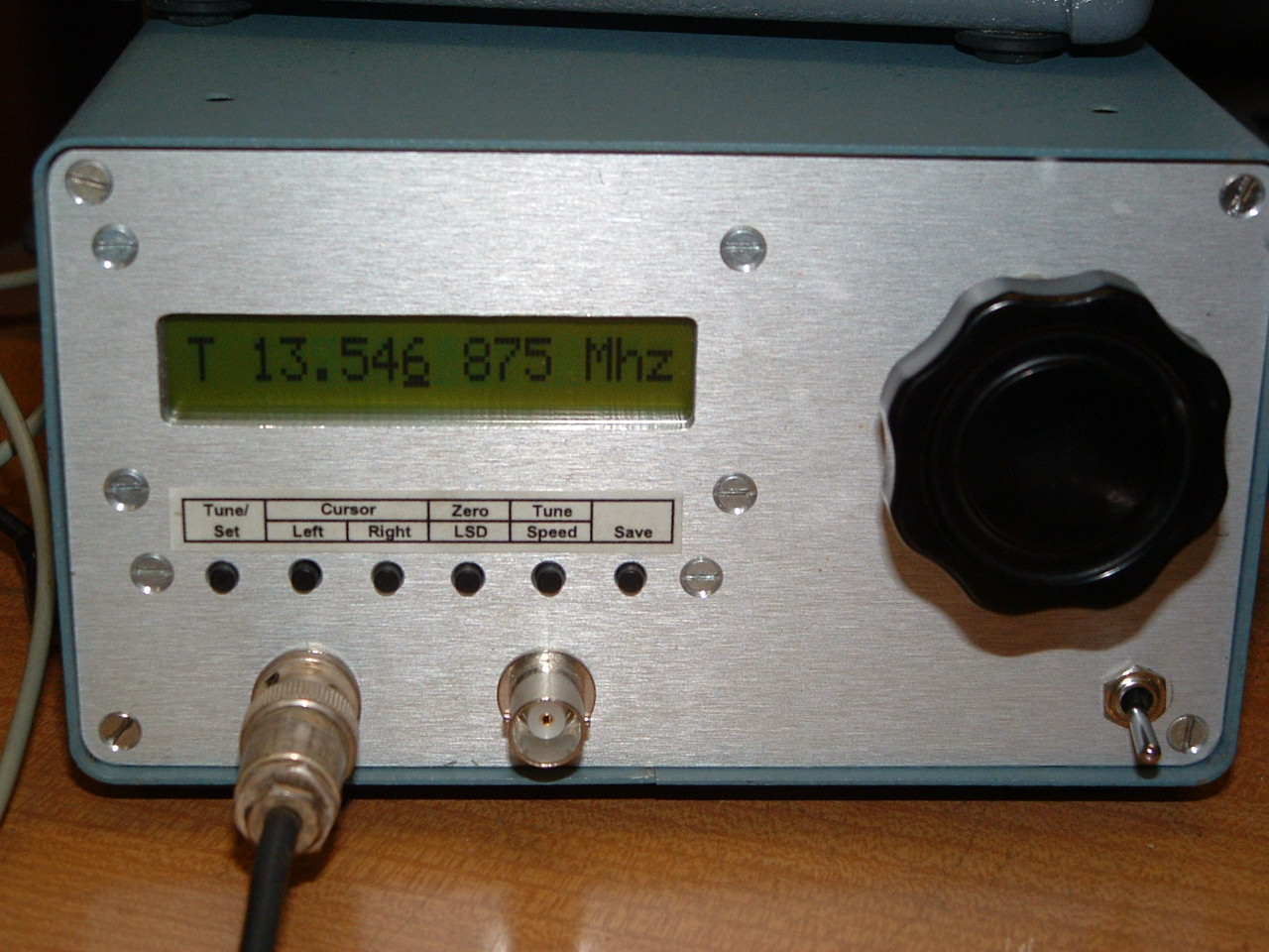

As an example, this signal source which I made, uses a PIC 16F887.
The PIC does the following:
Reads the pushbuttons.
Reads the quadrature encoder.
Writes to the LCD display.
Writes 40bits of configuration and tuning data to an AD9851 DDS chip.
The progam occupies less than 1.5k of memory.

Thank you both for the compliment.
However, it could be better. Inside was built simply to work as a high level signal source (1 volt or so). RF niceties like rigorous screening were ignored while concentrating the efforts on getting the programming right.
One day I may get around to rebuilding the analogue side of the thing.
Still looks nice, and the only difference between 1V and 10mV is an attenuator :p
Quite correct.
But, if the 1v source is not correctly screened so that the only place for RF to come out is via the connector to the (correctly screened) attenuator, then you have not got a 10mV source, it could be anything between 10mV and the 1V you started with.
Not only that, but 10mV is a rather big signal when playing with radios.
A signal less than 1uV is often called for, so the screening and the attenuator has to be good.
