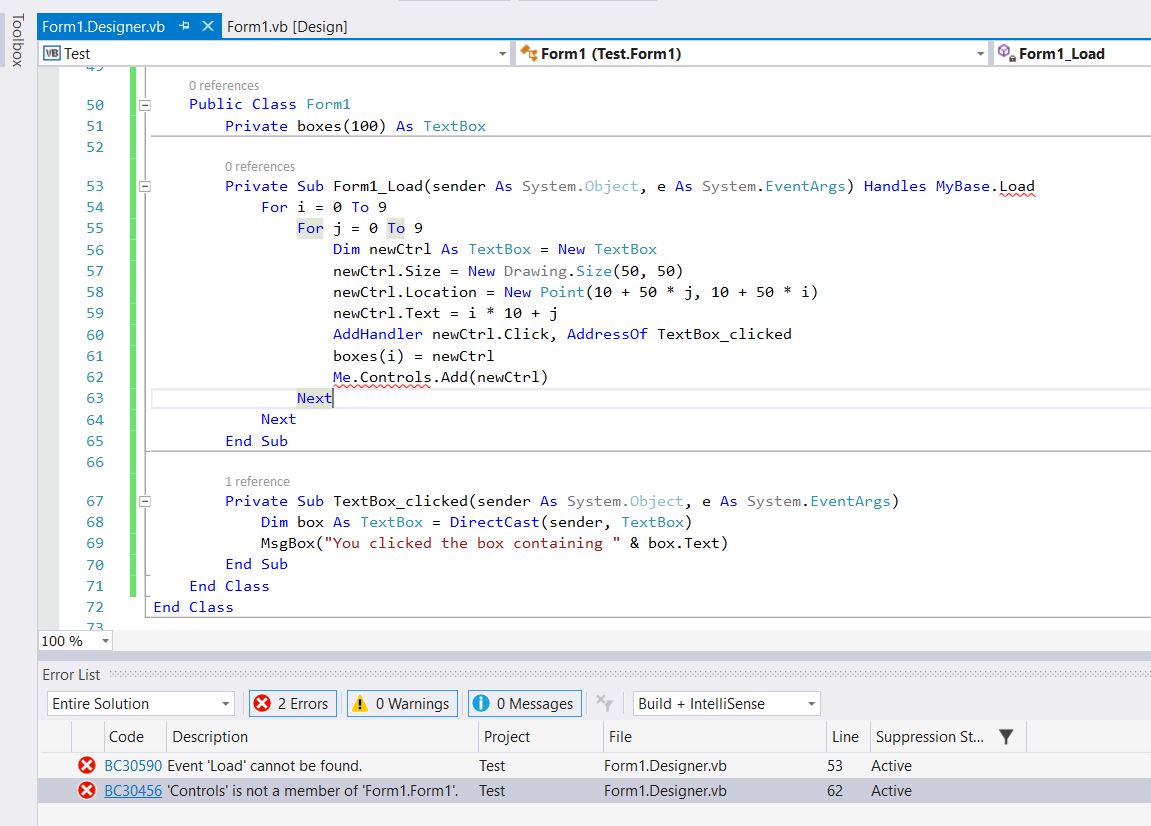

Hi Mike Thanks for the nice piece of code.
I got this error when I building....:(
It looks like you're using a later version than me (I'm on 2010). I'll look tomorrow to try to work out how to do it in later versions. It's 2AM here and I definitely need beauty sleep even though it doesn't seem to be working.
Many Thanks.
Just installed VS2017 and the only change needed was to the form1_Load line which is auto generated.
