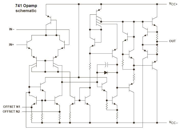

T terrapinlogo Member Dec 26, 2008 #1 hi i dont know much about op amps just there basic operation and was woundering if someone could point me to a scematic of an audio amp thanks
audioguru Well-Known Member Most Helpful Member Dec 26, 2008 #2 There are thousands of opamps. Nearly every datasheet has the spec's and the schematic. What does the schematic of an opamp got to do with a variable volume?? Here is the schematic of Texas Instruments uA741 opamp: Attachments 741 opamp schematic.PNG 29.6 KB · Views: 1,012

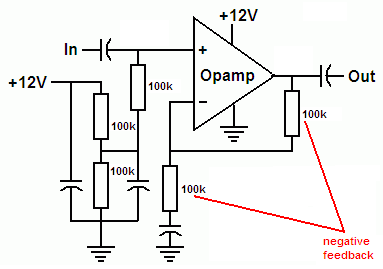

T terrapinlogo Member Dec 26, 2008 #3 no i want to use an op amp in an amp. i tried to connect the input and out put direct but it was distorted so i guess i need some extra parts.
audioguru Well-Known Member Most Helpful Member Dec 26, 2008 #4 You need to learn about opamps. An opamp has a voltage gain of about 200,000 so it needs to have negative feedback added to reduce it to a reasonable amount. Two resistors make the negative feedback.
audioguru Well-Known Member Most Helpful Member Dec 26, 2008 #6 terrapinlogo said: can you supply a scematic? Click to expand... I don't know what is a "scematic". Maybe you don't know how to spell English words. I attached the schematic of the uA741 opamp from Texas Instruments in my first post here. Maybe you want a schematic of an opamp that has negative feedback. Look here, its voltage gain is 2.0. Attachments opamp.PNG 7.8 KB · Views: 366
