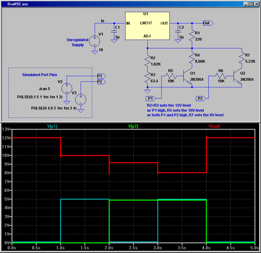

Basically I need to have three voltages (8, 10 12). I then need to use a PIC to control which voltage is outputted from the variable voltage regulator.
I am told that I need a LM317 but I havent been able to find any information on schematics that use the PIC to control the output voltage.

Look at the LM317 data sheet where is shows how to make it adjustable. Note that this is basically a voltage divider consisting of two resistors; the upper one doesn't change (usually 120 or 240Ω, depending on which version of the 317 you have), and the bottom one, the voltage drop across which adds to the intrinsic 1.25V reference inside the 317.
For your purpose, choose a bottom resistor to give you 12V out. Now calculate a resistor which when paralleled with the resistor above would drop the voltage to 10V, and do this a second time with yet another resistor which when paralleled with the previous two would reduce the output to 8V.
Use open-collector NPNs with a suitable base-current limiting resistor to "ground" the two additional resistors to put them in parallel with the original 12V resistor...
This will take two port pins; 00 gives 12V, 01 gives 10V, 11 gives 8V, and btw: 10 would give a fourth TBD voltage.
Try the math yourself. If you get stuck, write back.

The NPNs are used as switches.

There is no connection to 0V (Gnd) on a LM317, not unless you want it to deliver 1.25V, in which case Adj is connected to ground. Another way of saying that is that R2 (the bottom resistor in the normal voltage divider) is zero Ω :D
For your purposes, just hook it up the way I showed....
Depending on how much current you need at the three voltages, you might have to consider that the LM317 will have to be mounted on a heatsink, in which case you will have to insulate the heatsink, or insulate the tab on the LM317 from the heatsink.
Also, as another poster pointed out, you have to consider the minimum input voltage, which will have to be Vdo (the drop out voltage of the LM317, ~2.2V?) plus the 12V you want...
Right ok. So the C1 + C2 as well as the bottom of the adjust circuit are all connected to the circuit boards 0V rail?
The output pin on the LM317 will connect to the pump positive connector, and again is the 0V pump connector connected to my boards common 0V rail?
Pump, huh? How much current does it require?
Yes to both questions/

With more than 1A for starting, I guessing that the LM317 may go into current limiting to protect itself, and pump will labor on start up. You should have stated your current requirement up front (and I should have asked).
If the unregulated input voltage is 15V, at 8V output, the LM317 will be dissipating (15-8)*1 = 7W, so it will have to be on a large heatsink. You are planning to use a LM317T (TO220 version of the LM317), right?
