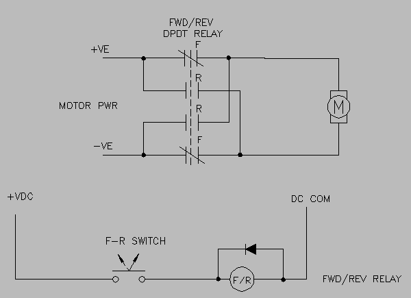

Yes, the MC2100's etc would need a reversing relay on motor output, I have used a common DPDT relay for this,
Preferably you would either need some way of preventing operating the rev SW when in either FWD or REV or ensure the motor has stopped before operating the SW..

So, Max, is there any schematic for the reverse feature you could provide? I am asking in the hope that you'd accept to take me - let's call it "under supervision", while I build/test this adaptation (this way you won't waste your time with the build itself and your knowledge can be put at work). Don't worry if it wouldn't work out of the bat, I like tinkering and going back and forth for a purpose and learning.

The relay I used was a K10P-11DT5-12 this has a 12v coil

Here is the rev relay, if needed, as already mentioned, do not throw it in reverse or fwd when running.
