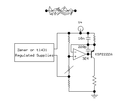

It is quite small current. Using LM317 like that will cause unstable, as it using a large feedback.
Here simple schematics of current source, you can also switch the variable resistor with 4066.
