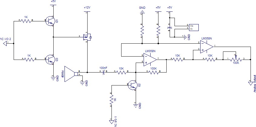

In a couple of months I am going to need to make a circuit that utilizes a 50W 200khz underwater ultrasound transducer, and I thought it would be wise to get familiar with a 40khz transducer first. I am trying to utilize a lm358 opamp to amplify the signal from the sensor. I am aware that it is probably not the best choice of an op-amp for this application, but I would try to use it if possible.
The MOSFET will deliver the pulses to the transducer and Q2 will serve to route the 12V signals to ground when it is in transmit mode. Why haven't I seen anyone drive a ultrasonic transducer with an h-bridge? Wouldn't it would be the easiest way to get the element to move 2 times better?
If you could glance over the schematic and let me know if you see any major flaws or possible ways to make it better I would appreciate it. If you can't tell it is my first attempt to use op-amps in any sort of circuit, hence that is why I am asking for advice before I make a PCB.
Thanks!
Edit: the two unlabeled resistors on top will be of equal value. Probably 10K or 100K

Do you plan to use the 200KHz transducer under water or in air?
You will get very little acoustic energy from a 50W 200KHz transducer if you drive it with only 12Volts.

Looking at your opa's I would check what gain you are expecting, check the
opa negative feedback connections;)
Regards
Eric
Also, the transducer is capacitve and therefore requires a push-pull driver, a common source switch won't give you much power.
Also that MOSFET is connected up incorrectly, it will be on all the time as (being p-channel) it needs 12V to turn off.
Your PNP transistor is upside-down. Q1 and Q3 don't do anything so what are they for?
Your opamps have positive feedback causing them to latch, instead of negative feedback so they can amplify.
The very old LM358 has a max frequency response with a 15V p-p output of up to only 6kHz. At 40kHz The output would be a low level triangle-wave if the opamps were connected properly.
I agree that the Mosfet won't turn off.

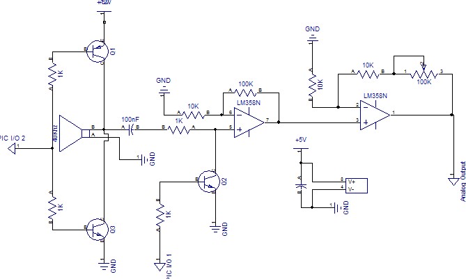

Well anyways, I updated the schematic with the stupid backward transistors problem, and the sensor now has a push-pull driver. This again brings me to the question wouldn't an h-bridge be good for driving a ultrasonic transducer because it is similar to a push-pull driver but would give it twice the voltage between peaks?

I am glad you got rid of your Mosfet, made the transistors emitter-followers and used the correct negative feedback for the opamps.
But the first opamp needs to be biased at half the supply voltage.
The old 741 opamp has a max frequency response of only 9kHz at 26V p-p. A TL071 has a max frequency response of 100kHz at 26V p-p. Its minimum recommended supply voltage is 7V.

AG, look again. Those aren't emitter followers. Those are push-pull common emitters that will draw huge current spikes on each transition of the input, due to storage time. Emitter followers would certainly be better. The base resistors are unnecessary, in that case. The input needs to swing zero to 12V in either case.
I suspect that the transistor switch (when he gets the bias right) that is intended to block the transmit signal from the amplifier will still allow more signal through than he will get from the transducer in receive mode.
Is there any better way you can think of isolating the opamp and transducer on the transmit mode? I saw one schematic that used a cd4016 to route the signals, but to me that seems a little excessive. Couldn't one just use one transistor or Mosfet or something else to direct the current rather than a clunky IC? I suppose someone could put a npn transistor on the gnd pin of the op amp to eliminate connections to ground during transmit, but I would imagine that would have absolutely horrid performance lol.
Every single Ultrasonic transducer driving circuit I have found online uses a push-pull driver as Hero999 suggested. And I just now found a schematic that uses an h-bridge to drive it as I originally thought would be best.
