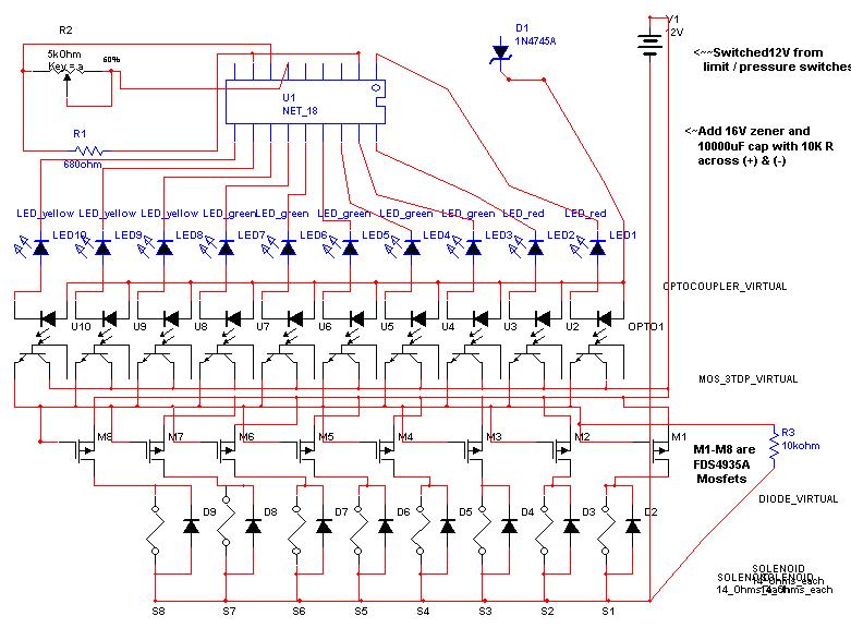

Yeah you're right, didn't realize how much cap these things are (gosh darn these 5fF MOSFETs I'm used to... need reality check once in a while) they're in the 1E-9 range, thus measured in nF. Now you have 8 of them in parallel, so it's on the order of 1E-8 farads (I didn't include miller effect, which would basically double this). Your resistor is 1E4 ohms => RC constant of 1E-4. Looks like switch-on times on the order of .1 milliseconds, which is probably OK for automotive purposes.
My only other question is where the 10K R3 is located, do I use just that one or do I need to have one across each M1-M8 Mosfets? ALSO NOTE that in this drawing I did not add the "S" select switches but I do plan to add them as in the drawing with the one Mosfet design. The program I'm using is a student version and will not let me use more than 50 componets doing the drawings.
Do you know which way I need to go with this, one or 8 10K resistors across the 8 Mosfets? If all is well I'll order parts on Monday. Thanks, Floyd.

You make reference to a 1000uF, if you examine the pcb component printing its a 100uF.
If you use the 4N35 with a CTR of 1, then you could use a single 4K7 to the gates of the P MOSFET's, in place of the 10K0.
This will reduce the switching time slightly in the MOSFET's.
I would suggest that as your drawing program has limitations, dont put so much detail into drawing the opto's,
a simple box would be OK, likewise draw just one MOSFET configuration in detail,
the rest as boxes or just '*8' would get the job done.
Its important that you post a complete drawing so that we can check out the final circuit.
Eric

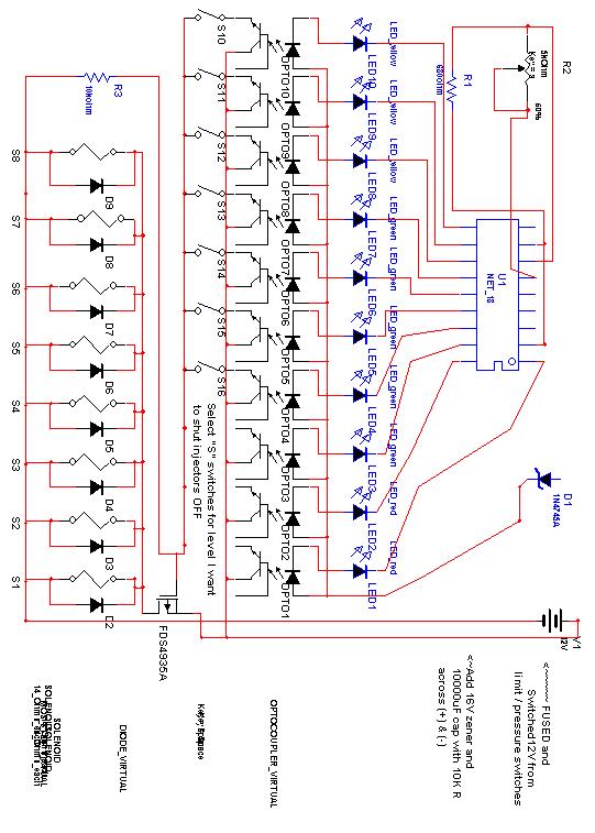

Drawing with just (1) Mosfet to control injectors:

Drawing with (8) Mosfets controling injectors(note I plan to add switches across ALL the OPTOs as did in the previous drawing):

I hate to say it but I think the program I'm using would count a box as a componet if it would let me add it. Is there a free program I can dowload that will let me do more? Electronics Workbench Multisim 2001 Textbook Edition is what I'm using. I'll check into getting the full version. the partial drawing is the same cropped from the original posted, https://www.electro-tech-online.com/attachments/o2-monitordriver-jpg.14051/
Yes, I can see where not having the entire drawing posted would be a bit of a pain, I'll start getting the entire prints posted, it may be a bit of a trick for me to do with being limited to 50 componets, but I'll figure out a way.
With both drawings, the (1) and the (8) mosfets contoling the injectors, the switches the theory of operation will be as follows:
System is armed when the 12V switched is closed turning the injectors ON all the time.
The LEDS light from right to left as the voltage from the O2 sensor input rises, I will leave lets say the left three OPTO switches closed, when the voltage level reaches the first OPTO with a closed switch it will cause the Mosfets to open the injector circuit. If voltages continues to rise it will still leave the injectors off, as the other two above the first will supply voltage to the Mosfets that already have 12V from when the first OPTO turned on. I'll get better at this I'm sure.

Ref the 4K7, you recall some other posts talking about gate capacitance?
If you are now using a 4N35, you could use a 4K7 in place of the 10K0 on the
gate of the MOSFET, this will decrease the charge time of the gate cap.[improve switch on speed]
For reference only, see attached dwg, its for when I suggested a single 20Amp N MOSFET, rather than 8 P MOSFET's.

I'm still using the 4N25s right now. You've lost me a little with this drawing. I'm to use the drawing I did with the (1) Mosfet design, see https://www.electro-tech-online.com/attachments/modified_injector_with_1_mosfets-jpg.14100/ for drawing info, but replace the FDS4935A Mosfet with a VNP20N07 Mosfet, Connect the source and drain for the VNP20N07 as you have drawn, see **broken link removed**, am I correct so far? If so looking at that drawing see https://www.electro-tech-online.com/attachments/modified_injector_with_1_mosfets-jpg.14100/ I've drawn a R3(10K resistor) from the gate to the ground coming out of the injectors that is taken back to my 12V source ground. If this is correct what else do I need to add? I like the To-220 mount a lot better also. https://www.st.com/stonline/books/pdf/docs/1607.pdf

I see that pin9 of the LM3914 is not connected, this means the LED's will form a single 'ON' dot display, not a 'bar' graph.
The effect on the solenoids would be,,,
As the O2 level rises and say, you have Sol#3 switch selected, when the #3 LED lights the solenoids will be de-energised,,, if for some reason the O2 continued to rise then #3 LED will go OFF and the solenoids will re-energise??
If you want the LED's to display as a 'bar' insert the copper link as shown on the pcb layout,,, so as #3 comes ON with a rise in O2, it will remain ON, [solenoids all OFF] until the O2 level falls below #3.
I am not sure which mode of operation you require, but have the choice.
Eric
As the voltage rises/O2 level going down, and it gets to the first , switch, say S-12 On drawing the injectors will cut off, if for some reason voltage rising/the O2 level falling, continues, with the switches S-11 and S-10 closed they will stay off. Then, when the O2 level rises/voltage falling, past the set point,S-12, they will fire again until the O2 level falls/Voltage rises to the S-12 switch level and the whole cycle starts over again. In theory this should happen in milliseconds if I do not have the primary fuel system calibrated correctly.
In closing I'm going to assume the drawing is correct and I will order the parts this afternoon.
