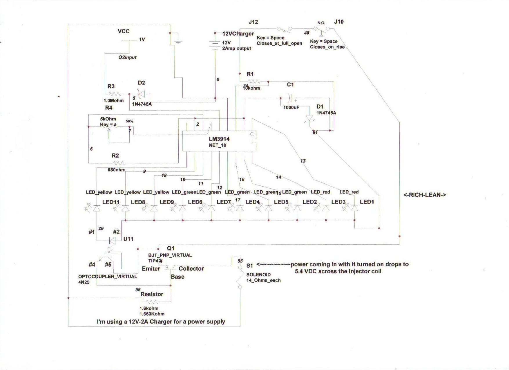

I'm really new at working with elecronics so please bear with me. This is my first project and I need some help. I've built an O2 monitor that I want to drive a set of solenoids,(injectors) from it. I want to use individual TIP42 transistors for the switching. I have the thing working now driving one injector but want to drive a total of 8 from the same source. I'm using a 4N25Optoisolator driven from the LED on the monitor to turn on/off the TIP42. How do you parallel the 8 TIP42 Transistors so they will all work? Do they need some sort of isolation? At the present time I have the Terminal #5 on the 4N25 from the Voltage source,12VDC, also on the TIP42 Emiiter, going into the 4n25, coming out Terminal #4 going to the base of the TIP42, ahead of the resistor, to switch it off when the 4N25 is turned on from the O2 monitor. I have a 1663 Ohm resistor from the Base on the TIP42 to ground. The injector is connected to the Collector and to ground. Basicily I have the load on all the time and the Opto cuts it off by making the base more (+) than (-). Thanks, Floyd.

I hope this works, I printed the diagram, then scanned to get it into a jpg. format. The injector coils are 14 Ohms. I'm thinking the bulk of the load will be on the transistor. I see what you mean about the Opto not being able to supply enough for the TIP42, I thought that might be a problem, I'm really new at this though.

Will you confirm that the attached pic is how you have the solenoid driver connected?
The voltages on your pic suggest that you are not fully switching the TIP, are the solenoids a proportional type??
Which pin of the LM3914 is LED11 connected to?
Eric
EDIT: Drawing corrected, deleted +5V connection, added 10K

I don't see a protection diode across the injector solenoid to stop the high voltage it generates when it turns off from destroying the TIP42 transistor.
I am surprised that a '12V" injector works when it gets only 5.4V.
The TIP42 must get hot since it is not turning on completely.
The TIP42 is not turning on completely because the 1.6k resistor's value is too high. But if its value is lower then the opto might not work. The resistor should be about 270 ohms.
A TIP125 darlington PNP would work fine with the 1.6k ohm resistor to turn it on completely.
With darlington transistors, the 1.6k resistor sould be changed to 12k so that one opto can drive 8 of them in parallel.

I'm in class right now so this is from memory. In your drawing it is connected as you show, but when I checked the voltage going to the Opto from the LM3914 side it has 12VDC not 4.7VDC as in your drawing. As for if it's proportional,I have no idea what you mean. I connected my Fluke 87 Multi meter to the solenoid in series and tested it on a 12VDC battery reading ampereage. The result was the meter initaliy went OL then came back to .400mA and continued to drop to around .014 when it was saturated and started heating up.

This morning around 4am EST, I tried to lower the resistance of the
1663 Ohm, to raise the voltage level turning on the TIP42 with loadon, the voltage did go up but when I applied the voltage from the OPTO by adjusting the O2 level to where the last LED,#10 came on the thing started buzzing, like the injector was turning on and dropping out. My guess is the resistance was wrong for the TIP42 to stay turned on were wrong for the TIP42. What I did find when I unhooked the load and ran the collector open, just with my meter connected, the transistor was either on all the way, OPTO LED off, or off all the way when the OPTO LED on.

hi Floyd,
This is what you would expect to happen, basically the collector current thru the TIP is transistor is the base current multiplied by the transistor gain.
So when you removed the low resistance solenoid and inserted the high resistance meter, the lower current thru the TIP would switch off or saturate the TIP.
Example for explanation,
IF. the base current is say 10mA and the transistor gain is 40 then the collector current would be about 0.01*40= 400mA,
with a load resistance value of 14R, the voltage drop across the load would be about 0.4 * 14 = 5,6V [ which you measured]
If now you replace the 14R load with a higher resistor value of say 30R then you would get a voltage of 0.4 * 30 = 12V.
across the load [solenoid]
In order to get the same 12V across the 14R solenoid you will have to increase the base current to about 25mA. 0.25 * 40 = 1Amp.
Its important to note, that as the collector current is increased the transistor gain will fall.
