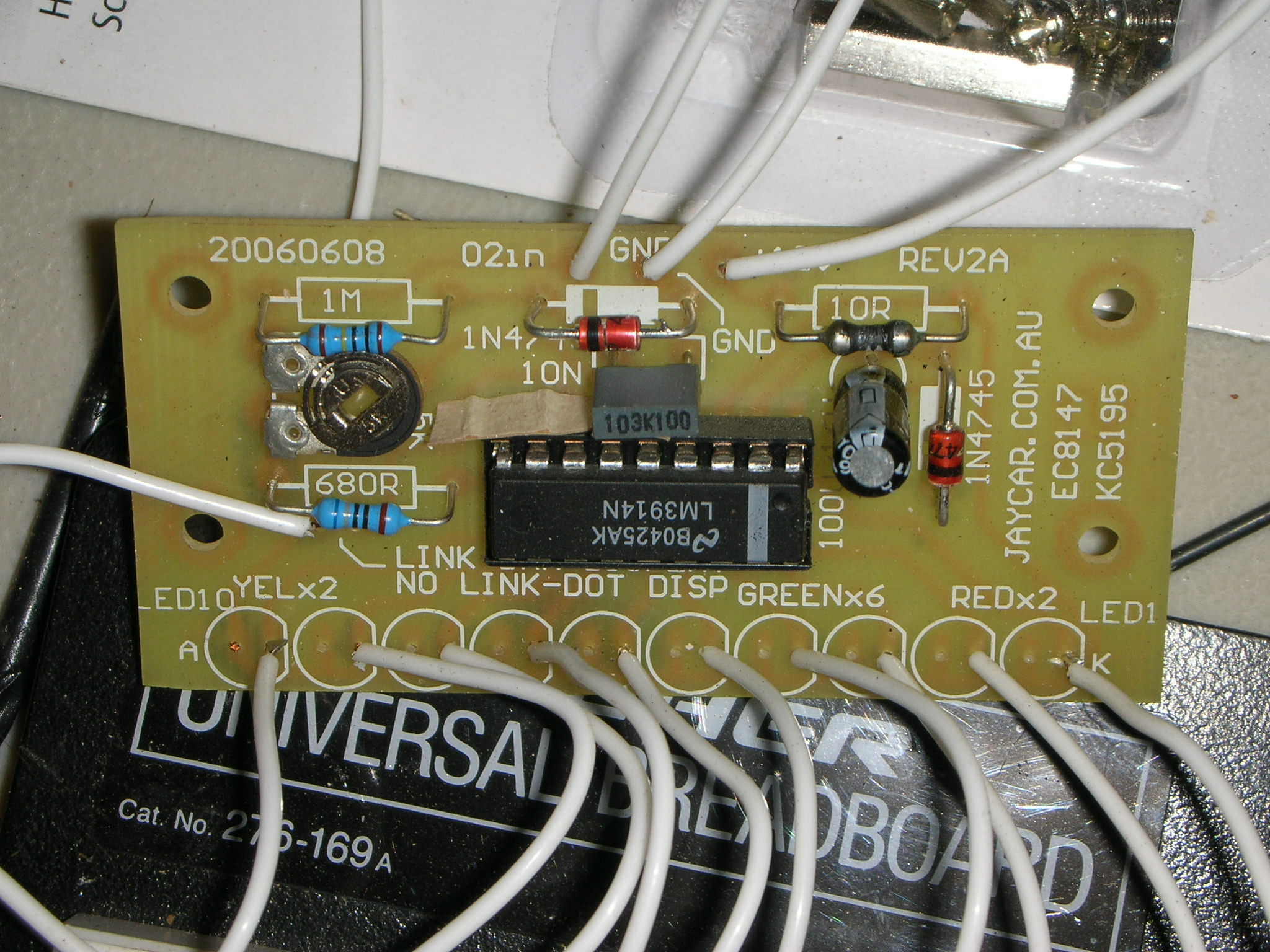

I think your circuit design has many parts on the edge of working or not working.
I wouldn't use it to protect the expensive pistons of my car from blowing up.

Here's a picture of the PCB w/o the transistors or Mosfets being in the picture, as it is presently assembled. I realise the 10R looks a "little used", that's what happens when you land a wire wrong! But it still works and is within specs, I'll replace it later on.
