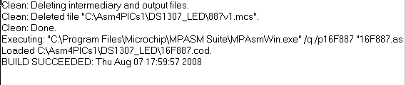

Hi Eric, Thanks for you time
please the program did not compile on my MPLAB IDE. Built failed. this was the result.
did you try it?
did you try it?
Yes I did Build it with MPLAB,, I will retry OK.
did you try it?
Redone with MPLAB OK.
See clip from MPLAB output.
What version of MPLAB are u using. I am using MPLAB IDE v8.00.
Look at the output i am getting from my MPLAB
HTML:
Clean: Deleting intermediary and output files.
Clean: Deleted file "C:\Program Files\Microchip\MPASM Suite\Template\Object\16F887TMPO.o".
Clean: Deleted file "C:\Program Files\Microchip\MPASM Suite\Template\Object\16F887TMPO.lst".
Clean: Done.
Executing: "C:\Program Files\Microchip\MPASM Suite\MPAsmWin.exe" /q /p16F887 "16F887TMPO.ASM" /l"16F887TMPO.lst" /e"16F887TMPO.err" /o"16F887TMPO.o"
Warning[203] C:\PROGRAM FILES\MICROCHIP\MPASM SUITE\TEMPLATE\OBJECT\16F887TMPO.ASM 66 : Found opcode in column 1. (goto)
Message[302] C:\PROGRAM FILES\MICROCHIP\MPASM SUITE\TEMPLATE\OBJECT\16F887TMPO.ASM 77 : Register in operand not in bank 0.  Ensure that bank bits are correct.
Message[302] C:\PROGRAM FILES\MICROCHIP\MPASM SUITE\TEMPLATE\OBJECT\16F887TMPO.ASM 78 : Register in operand not in bank 0.  Ensure that bank bits are correct.
Message[302] C:\PROGRAM FILES\MICROCHIP\MPASM SUITE\TEMPLATE\OBJECT\16F887TMPO.ASM 108 : Register in operand not in bank 0.  Ensure that bank bits are correct.
Message[302] C:\PROGRAM FILES\MICROCHIP\MPASM SUITE\TEMPLATE\OBJECT\16F887TMPO.ASM 111 : Register in operand not in bank 0.  Ensure that bank bits are correct.
Executing: "C:\Program Files\Microchip\MPASM Suite\MPLink.exe" "C:\Program Files\Microchip\MPASM Suite\LKR\16f887.lkr" "C:\Program Files\Microchip\MPASM Suite\Template\Object\16F887TMPO.o" /o"16F887TMPO.ASM.cof" /M"16F887TMPO.ASM.map" /W
MPLINK 4.14, Linker
Copyright (c) 2007 Microchip Technology Inc.
Error - section '.org_1' can not fit the absolute section. Section '.org_1' start=0x00000004, length=0x00000062
Errors    : 1
Link step failed.
BUILD FAILED: Fri Aug 08 09:06:42 2008
This was the code i built. i.e. from the sugestion you gave.
