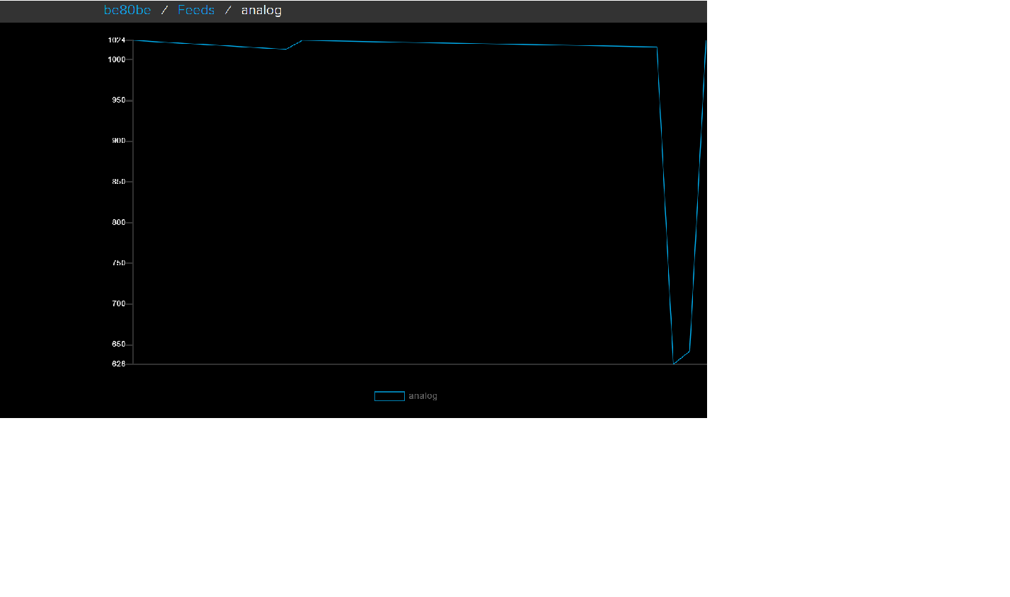

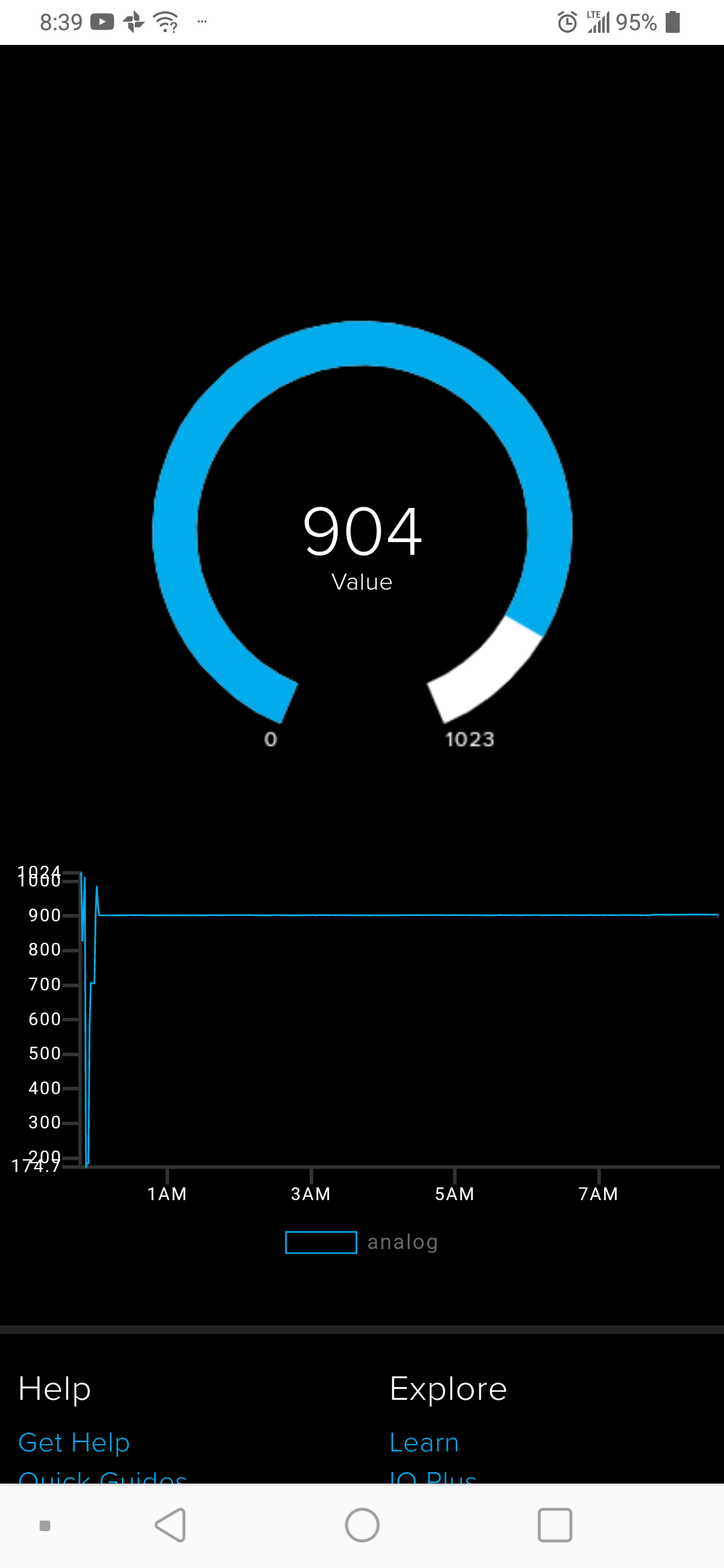

That's really cool I been playing around with some nano 33 IOT Wish I was good at writing code for pc side too.
I using the Arduino cloud
There is no code on the PC side. It just opens the page in a browser.
