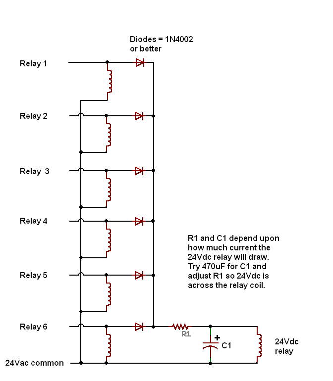

I have a hot water heat project that has 6 zones.6 seperate pumps are powered by six seperate spst 24v coil relays.I now have added another circuit that I want powered whenever any ONE relay is energized.
Can I just use six diodes one off of each hot leg of coils down to the added circuit relay.
Is there another way or am i way off track?
Im trying to avoid having to buy 6 dpdt or dpst relays since I already have panel wired and just currently want to add circuit.

If the relay coils are all fed by a common rail, then you could use diodes to half wave rectify the AC from each relay into DC to switch one DC relay. Do you have a schematic of how the 6 24Vac relay coils are wired?
basically the common leg on all relays are daisy chained together.Each thermostat will close when ther is a call for heat and 24 vac goes to other leg of coil.I want to power one more relay with 24vac off each thermostat relays without the current backfeeding to unenergized coils.Im not an electronics person whatsoever,just good with relay logic and am trying to keep from changing all the relays to accomplish this task

Here is a concept circuit:

If you leave the capacitor out and add a catch diode, you would get an average of 10.6V pulsating DC across the coil. The relay may chatter and hum a lot. If you use a capacitor (Rated for 50V) as shown in my diagram, then you get around around 33V of relatively smooth DC. You'd use a resistor (R1 in my diagram) to drop this down to 24V.
thank you thank you ok lets say I have a relay coil 2000 ohm then how would i size cap and resistor
