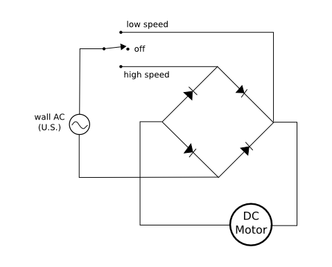

A cheap hand blender I got from Walmart broke down after two years of use,
so I crack it open. The circuit is very simple. Just a diode bridge rectifier,
a switch, and a DC motor (circuit schematic in attached image).
The interesting part is, it has two speeds: "high" and "low". The high speed is
just a standard diode bridge. My question is, why does it work at low speed?
I looks to me like driving the motor half of the time and short circuit half of the time.
The diodes are "N5399 MIC" and the motor is "HRS 5512SP".
On half speed it's fed via a half wave rectifier (a single diode), on full speed it's fed from a full wave rectifier (a bridge).
It's as simple as that - the half wave diode is the bottom left one.

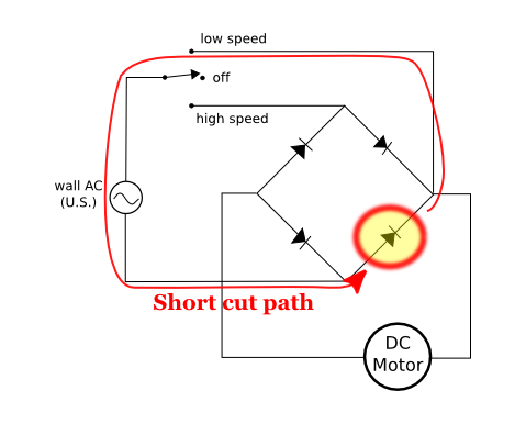

Hi Nigel. Thanks for a quick reply. You are right. Half of the time, the bottom left diode works as a half-wave rectifier.
What about the other half of the time? Don't we have a short-circuit on the bottom right diode?
Thanks again Nigel. You are right. I didn't look careful enough initially. Taking a second look, I found
another diode hiding under a heat-shrink tube on the "low speed" wire. Now everything makes sense.
