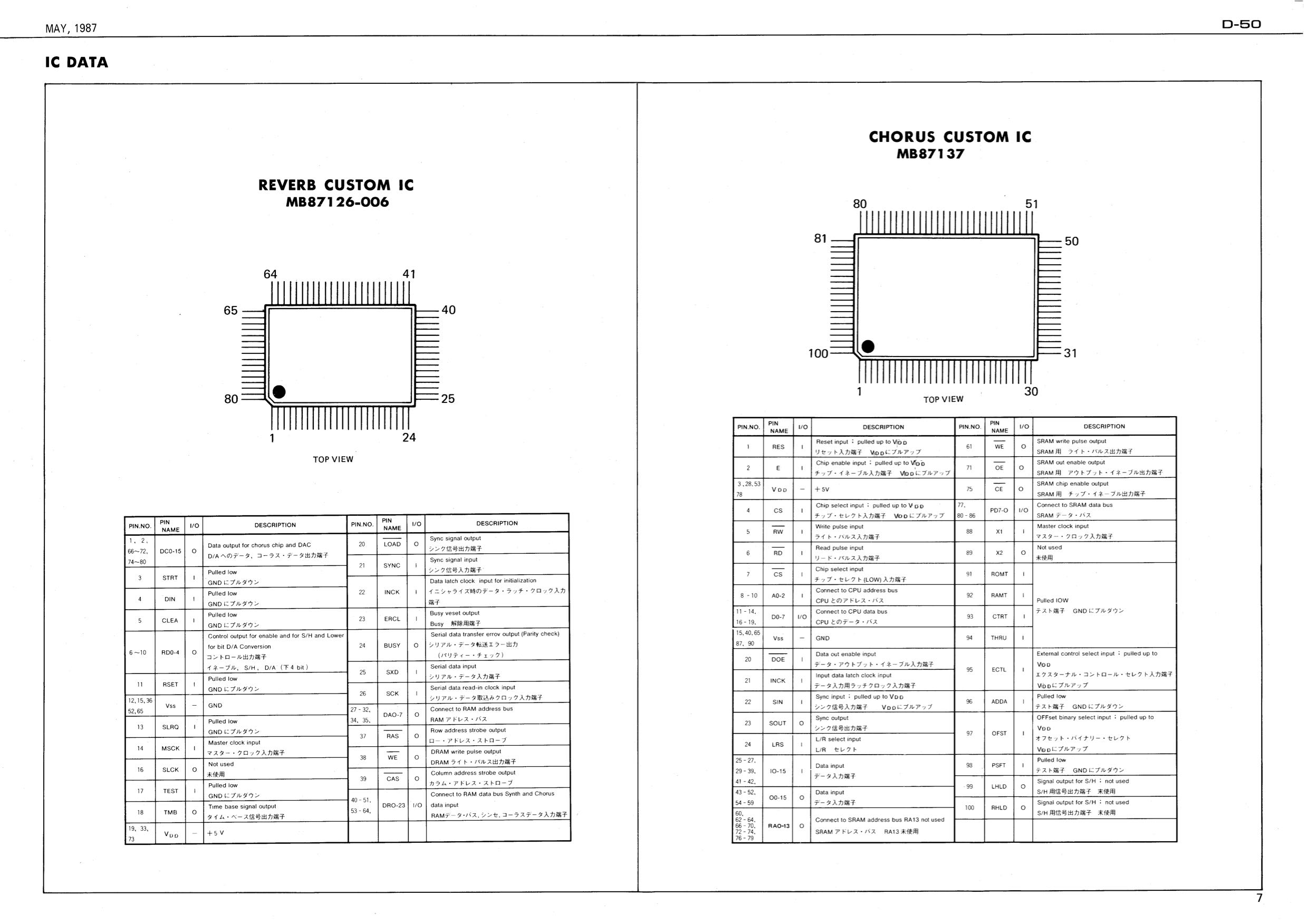

Is it possible to know just from the pins descriptions bellow what results I should expect from a logic probe?
In terms of low, high or pulse? In order to diagnose if the IC is working?
It's the IC8 Chorus.

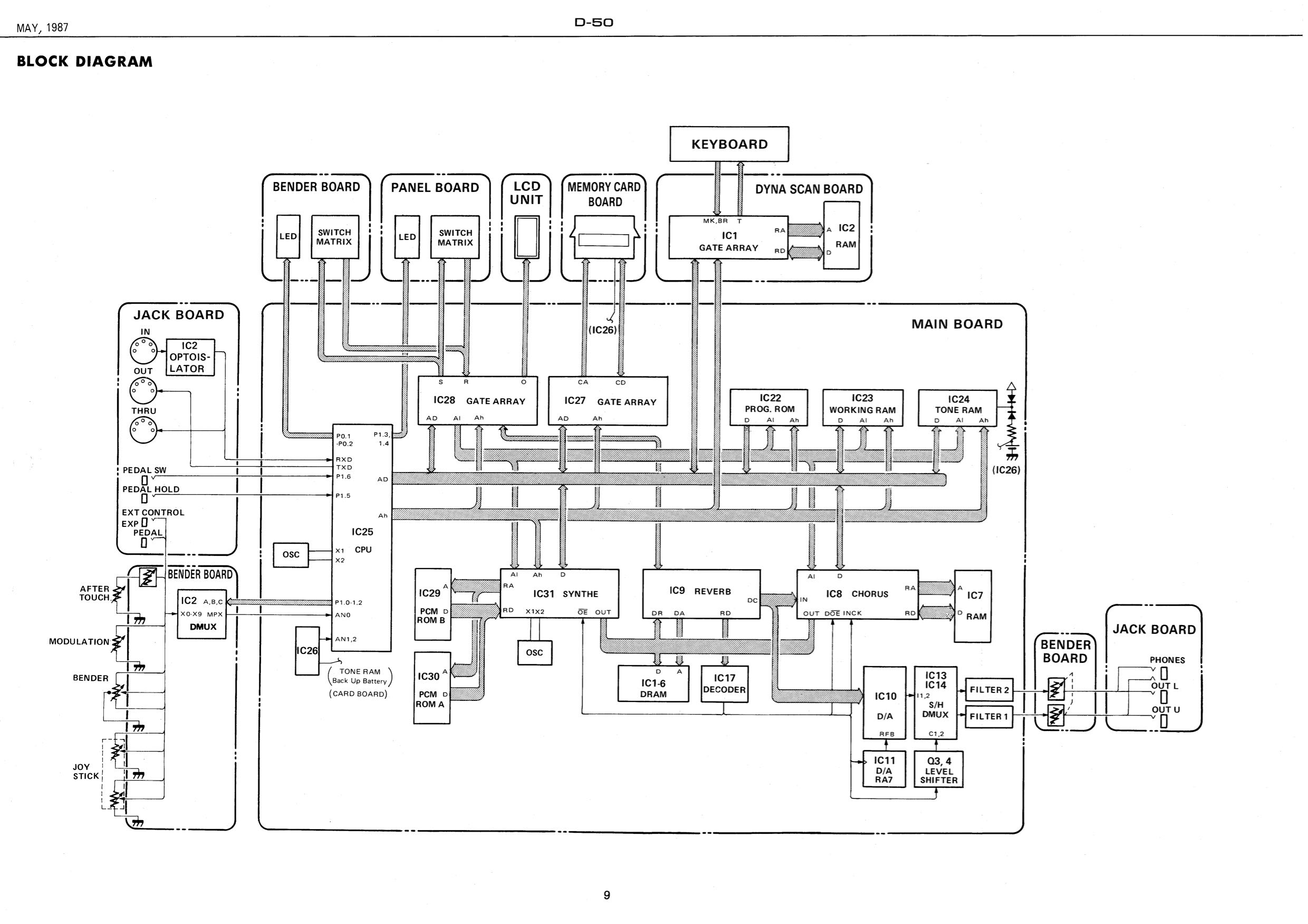

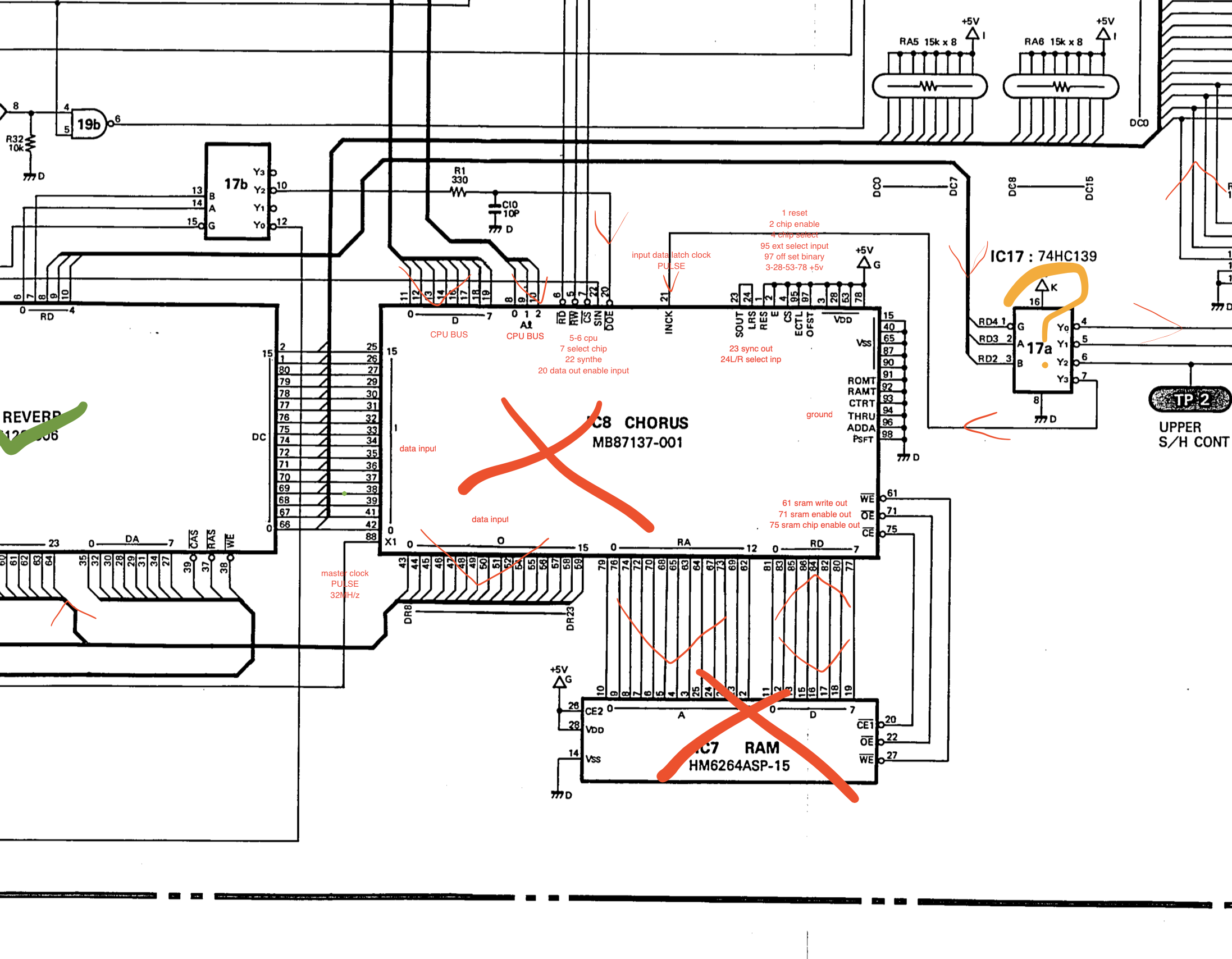

That IC controls the Chorus on the Keyboard. When chorus is enabled in the software the sounds gets cracked. When chorus is disabled in the software it sounds perfect.
The chorus IC has also 6 dedicated RAM ICs. I need to check how it communicates with these ICs. The passive components between them have been tested and are fine.
The synth, Reverb, CPU, DAC blocks seem to be working just fine when Chorus is disabled.
I cannot replace that IC, very rare. But I can replace the RAM. But overall it is just a good exercise to learn more about electronics and understand better how to diagnose when you don't have a lot of data available.

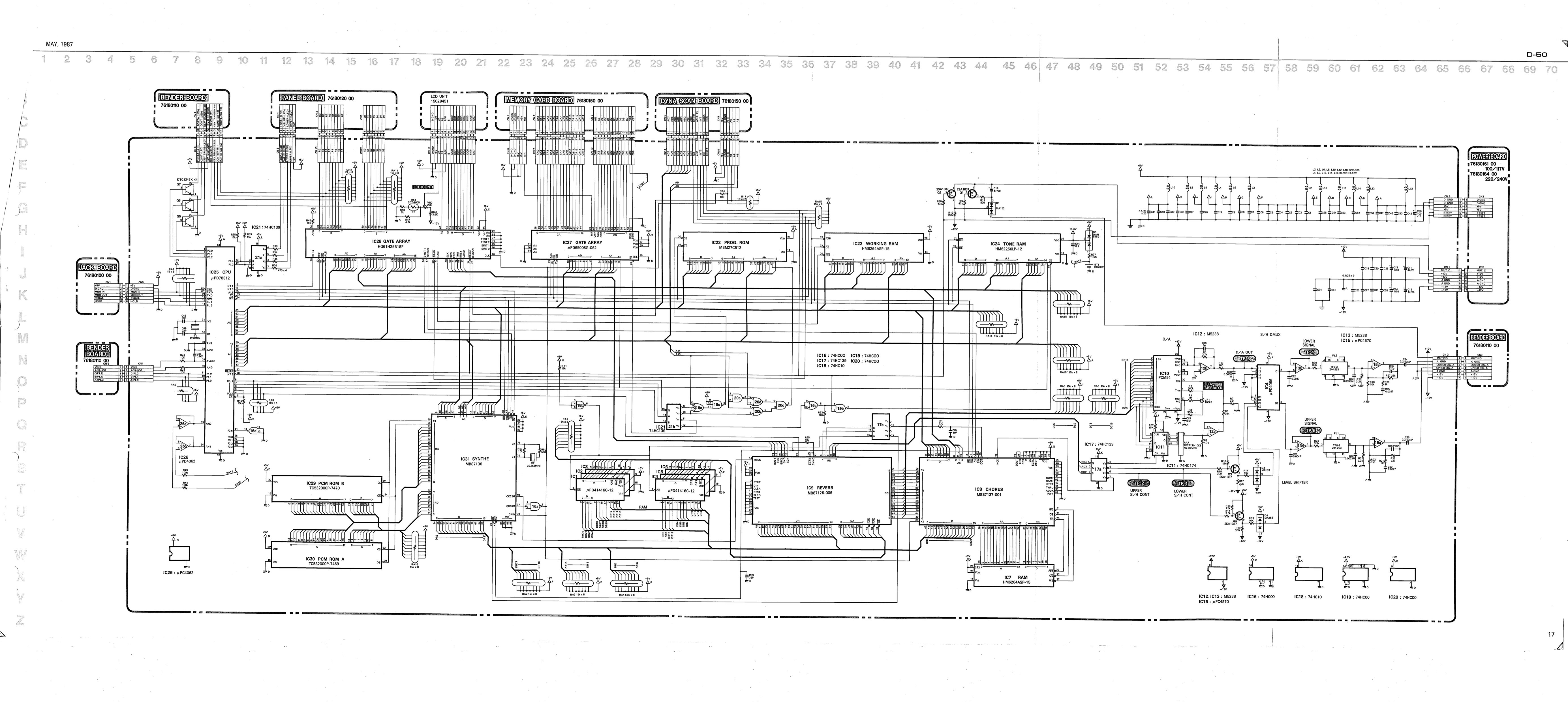

It's very unlikely to have anything to do with the 139 chip as that just selects the chorus chip to read/write to it. Do you have the complete schematic that you can post?
Hi Mike, here they go! Thanks for helping!
