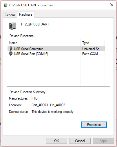

It really absolutely depends on EXACTLY what is in the GPS module.
As I see it there are basically two options:
1) The module is a 'proper' USB slave, and needs a host computer running a suitable driver in order to work - in which case the OP is stuffed!.
2) The module includes a simple serial output internally, which connects to an FTDI (or similar) chip, thus providing a USB/Serial output to connect to the PC as a serial port.
Probably the best thing for the OP to do is to look in Control Panel, under devices and see what it says when you plug the module in.
I just plugged an FTDI module in, and this is what it says:
Clearly showing it's an FTDI serial port.

I am not 100% sure where to look. When I plug & unplug the device the only change I see is an additional COM port

The prolific does the same thing as FTDI if you open up the case you'd find that its sending a serial signal to the prolific chip
Pin 1 and 5 is the serial data from the GPS pin1 is TX and pin5 is RX
Ah - OK so it is a matter of locating the pins. I guess that soldering some leads on to the IC will not be easy unless there are pads accessible. I will take a look. Thanks
