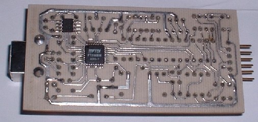

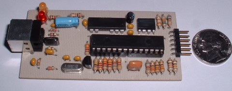

Here is ICD2 clone - USB to serial FT232BM based version.
Very small.
Single sided board, no external PS required,
EEPROM chip added.
All parts you see here, except FT and EEPROM (mounted at the bottom).

Hi Andy,
I saw this picture on Lothar's site in the Forum... A very nice looking implementation...
I'm curious about the DC-to-DC convertor and other components you used... Do you have a schematic and BOM posted somewhere?

I will post PCB and schematics in a few days - I made small changes to accomodate different DC-DC converters on the same board.
The DC-DC converter shown is very expensive - $9 each - it is Burr-Brown 1W, but I have bunch of them here I got relatively cheap.
New board can handle in addition C&D converters as well as any 4 pin converters with 0.1" pin spacing.

Expensive? Not really.
For your clone add cost of external power supply with wall transformer, 5V and 13V regulators and it will be not that cheap.
USB version has no external wires at all, 5V taken from USB.
