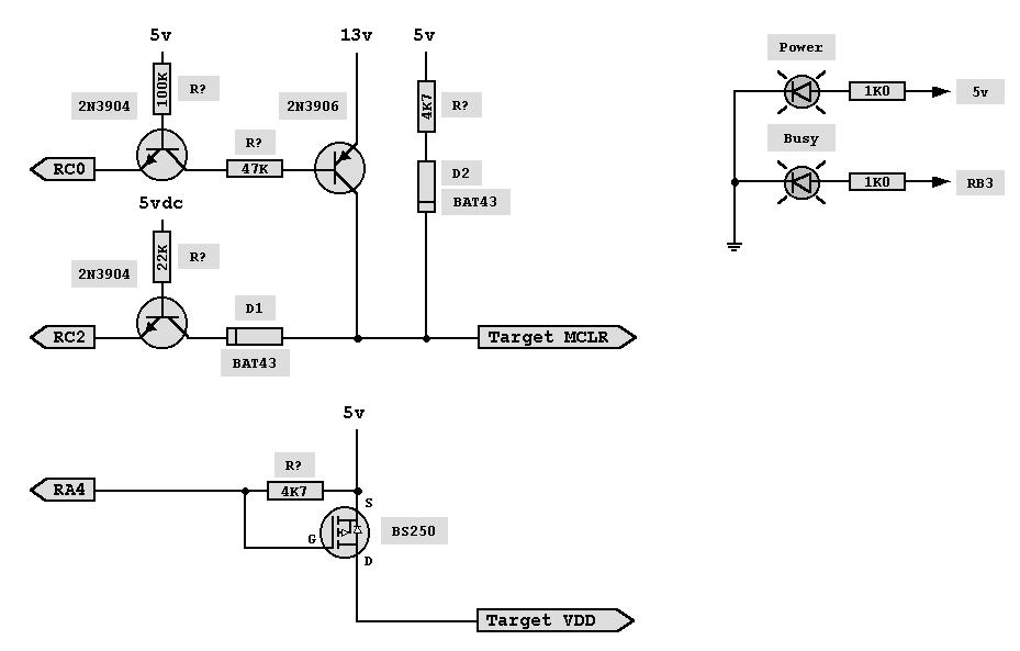

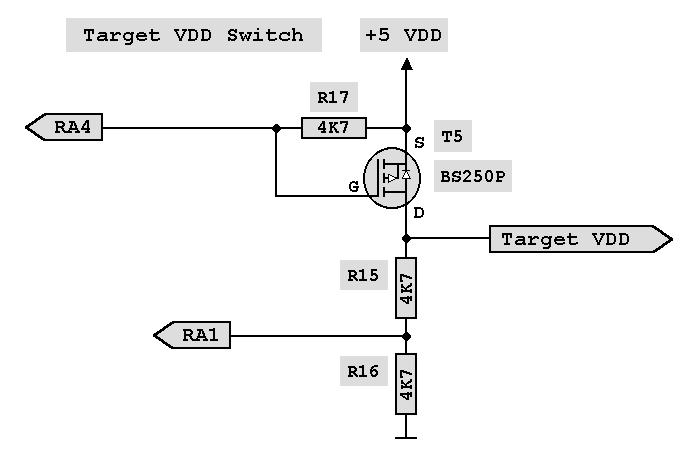

I use 12F683 (and other PICs) with INTOSC and MCLR disabled for I/O function and these devices will not enter High Voltage Program/Verify mode if VDD is "always on" so I definately need ICD2 controlled Target VDD functionality for programmer operation...
I also prefer P-Channel MOSFET High-Side switches in a TO-92 package but they seem to be dissappearing fast only to be replaced with much more expensive part numbers... I used to buy TP0610L in TO-92 package (very similar to BS250 or BSS84 specs') for well under $1 USD but they have become discontinued... The BSS84 is still relatively inexpensive but only comes in an SO-23 package...
So, does your RA4 Target VDD PNP circuit look like the PNP drawing below? Do you think a 2N2907A PNP would work ok with these values to provide <100-ma to the Target?
Does the drawing using a P-Channel MOSFET look ok? The low Drain-Source resistance should allow higher current to the target, yes, no?

That pull-up resistor should be *before* the base resistor, otherwise you are making voltage divider which could prevent the transistor to get into saturation. If you move that pull-up resistor, it wil l definitely work. That MOSFET diagram looks OK, I would increase value of that resistor to 4K7, 1K5 is kind of low, but it's not critical and will work with it.

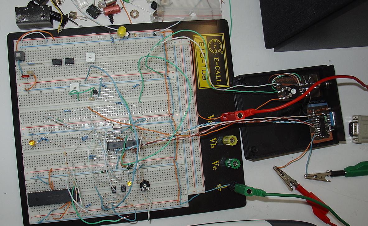

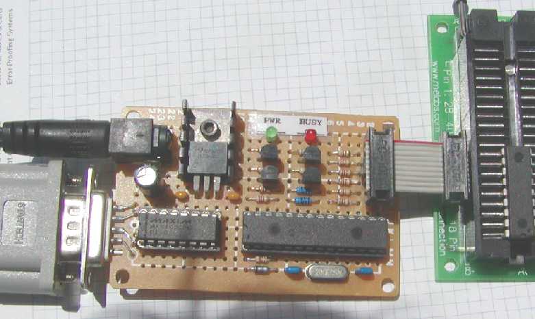

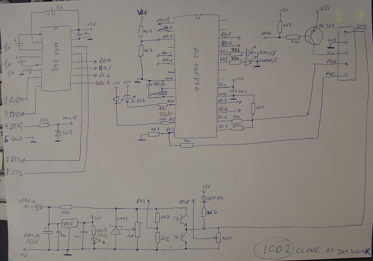

Here are some PICs of my ICD2 (Under construction)
Jay.slovak said:
That pull-up resistor should be *before* the base resistor, otherwise you are making voltage divider which could prevent the transistor to get into saturation. If you move that pull-up resistor, it will definitely work.
I disagree! - it's perfectly OK as it was, and I would design it that way - it's the standard way that type of circuit is normally used. As the Vbe of the transistor limits the voltage to 0.7V, then your voltage divider argument doesn't have any relevance.

Your way will probably work OK, but it has no advantages over the conventional way? - my concern was that you were casting doubts on the original circuit, when it had nothing wrong with it!.

I am sorry for that :oops: , the thing is I learned everything without assistance of any Teacher... so there is a chance that I "see" things differently.
Jay (and gang),
Thank you for all the help and guidance... I think I've finalized the last bit of circuitry to finish up the ICD2 clone (drawing below)...
Now I'm trying to figure out the best way to squeeze those four transistors, 2 LEDs, and other components into that tiny 3/4 inch by 3/4 inch blank area on the prototype board (picture below)... Wish me luck...
If you're wondering -- I use machined pin sockets and I put the five 0.1 uf monolythic caps' in the socket open space under the RS232 chip and I put the bypass cap' and the six ADC resistors in the open space under the 16F876 chip... T'was the only way I could think of to squeeze everything onto this tiny prototype board...
Regards, Mike

I see that you decided for Transistor tree solution, why led you to do so?

Jay,
It works... Yippee!!! I'm pretty 'geeked' (grin)... I thought I might have had a problem but then realized I had to tell MPLAB to power the Target from the ICD2... I successfully erased, programmed and verified a '628A and will check it out in much more detail in coming days...
Thank you again for helping me brain-storm the final Target MCLR circuits...
Regards, Mike
Jay,
I'm sorry, I missed this post as it jumped onto a new page...
I didn't use the Op Amp circuit because I would have to adjust the VPP voltage every time I used a different power brick... I have three different ones on the Lab Bench, each with a slightly different voltage between 15 and 18 volts...
I really liked your opto-isolator scheme... T'was very compact and elegant but I didn't have any nice 4-pin opto's and I also worry that switching time may be slower than bipolar or mosfet switches...
I used transistors because I had them... I used the BAT43 and 3K6 on the Target MCLR line to eliminate one transistor...
Regards, Mike

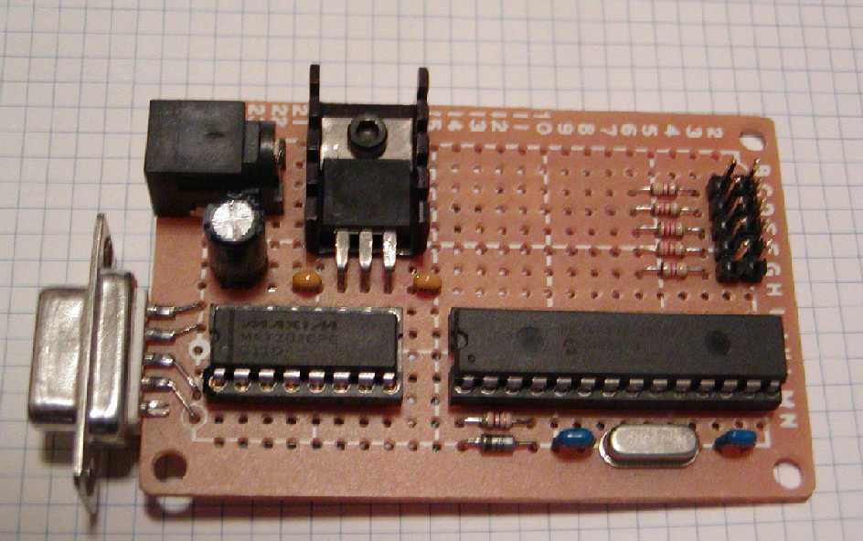

Jay (and gang),
The Serial ICD2 Clone has been working well and I even tested it on a 12F683 with INTOSC selected and MCLR disabled...
The only "annoyance" is that MPLAB will not remember my COM1 setting for the ICD2... It always defaults to USB... I even tried using the ICD2 Installation Wizard but still "no joy" getting the COM1 setting to "stick"...
As Evandude suggested, a PCB would be nice and probably would have cut down my assembly time from four hours total over several days to about a half-hour in a single sitting, provided you had all the parts on hand...
Regards, Mike

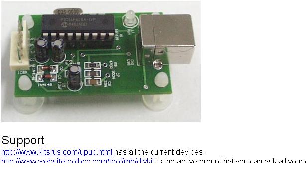

I've been reading this thread all along ..
and Correct me if i'm wrong , but no one seems to be using USB , mikes latest design , which is nice work btw , is serial ? no??
And Jays design is clearly serial , also very nice work ,
so my question is
why isnt anyone using the USB port??
this doesnt look to hard to copy.. granted it is just a USB programmer , with no ICD2 capabilities , but one of us should be able to at least figure out what is so mysterious about USB..
ALL the USB PIC programmers that I have seen so far simply use a USB-serial adapter chip. (usually FTDI or similar)
for instance, that one in the picture does. (as do all the other ones by that manufacturer) and if you look at the latest ICD2 clone design, it too has a USB-RS232 chip on there (small surface-mount chip with leads on all 4 sides)
it's just some extra circuitry to interface it with an otherwise serial-port-oriented design.
however, those chips aren't all that easy to find, or cheap. I got a couple as free samples by emailing the compnay, but to purchase them, I believe is expensive.
and that programmer you posted only does low-voltage programming. so it can only do pics with FLASH memory that support LVP, and you also need a separate programmer to program them the first time to enable LVP. (and do it again, if you ever accidentally change it)
