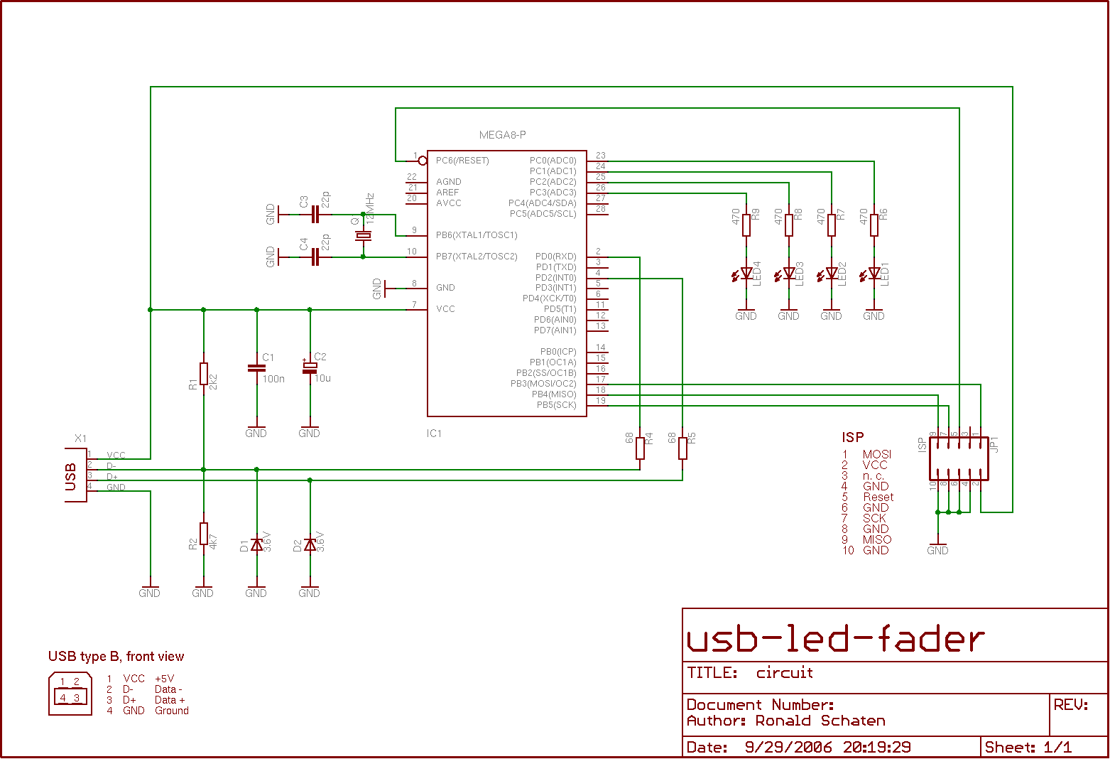

Hello guys. im trying to the attached project. I made the circuit, but now im stucked. In the description it says i should upload the firmware on an atmega8. the problem is the main.hex file is 16 kb.... and i know the flash of the atmega8 is only 8kb... what are the steps involved further? thanks alot

I flashed the atmega8 with the hex and it's working.. the led's are fading once. then i tried to write the command "make" in the directory commandline, but it displays me this error, though i have installed libusb:
gcc 'libusb-config --cflags' -O -Wall -I../common -c usb-led-fader.c
/bin/sh: libusb-config: command not found
/bin/sh: gcc: command not found
make: *** [usb-led-fader.o] error 127
what should i do?

I dont use 'C' but I would say as you have only got the *.hex file and not any of the include files to rebuild the hex thats why are getting those error messages.
i have all the files....so the hex it aint the problem, i think this libusb i didn't install it correctly or something, because it cant find this libusb-config... hmm..don't know
I don't know 'C', but usually a .hex files is what you burn to the chip, it's already complied. The .hex file can be much larger than the chips capacity, because it contains other information, that isn't sent to the chip. You post a link, of where you found this, maybe we can help from there.
found it! When you unpack it, rename the .Tar_02 file, to .tar, and you can extracted the contents...
Seems like all you have to do is burn the hex file, install the USB driver on your computer....
The size of the .hex file don't mean anything with regard to the space it will occupy in memory. the hex file contains at least 2 or 3 times more information that what is actually written to the chip.
