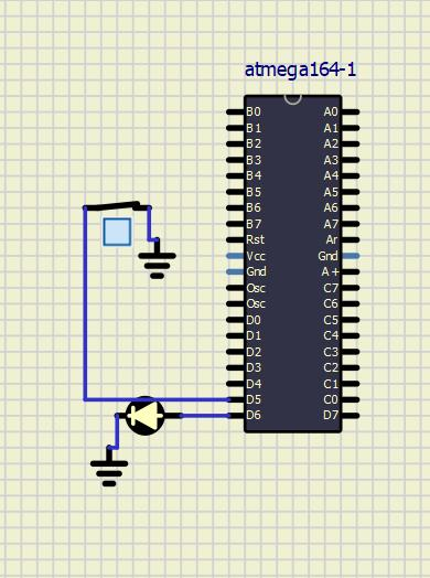

Hello guys, I'm trying to make a led blink at 3 different frequencies, upon successive keypresses. My problem right now it's that it's only blinking 2 times and I don't understand why. D6 is LED, D4 is the test output. Here it's my main function:

And this is how my minimalistic setup looks like:
What am I doing wrong?
How do you think you'll get three frequencies from this code?

I'm not familiar with ATmega registers so I don't exactly how can I get 3 frequencies...I only have 1 there
I don't know the ATmega registers either but I know C and so I can modify the above code to give three frequencies. So you don't know ATmega or C?
More random stuff. If you'd have answered the questions things would be different.

What question man?? To show a message in C it's very simple, you're asking me if I know to code in C but you didn't mention exactly what should I code...
I was trying to work out your abilities and asked three different questions above. You are claiming to know how to program (not type) in C but can't modify the simple code above!!!
Because I'm not an expert in this and I don't know what to modify..It may be simple, but not for me..
This is not expert level coding but really simple stuff. I suggest you do one of the online C tutorials so you at least know the basics.
In the above code the values 0x1310 and 0x4C40 are being written to the timer register. The average of these two values is 0x2FA9 so to make it flash at three rates requires the three values to be written sequentially,

Thanks for your code but the leds are still blinking at a chaotic rate(sometimes 3 times, sometimes 4 times)...
They should blink at three different frequencies as you stated in your original post.
