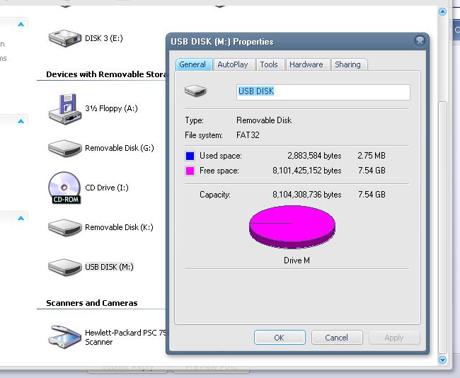

Hi all,
I just got one of those 8gb thumb-drives but seems like it won't take more than 2gb's. How can I find out the capacity of the drive? Got it off of Ebay and it said it was 8gb's and not I'm not sure it is.
Most DVD movies are about 4.3gb in size (just the main movie) and that's what I wanted to load onto the thumb drive and watch it at work. Ther are othe files on ther but only add up to 785mb's.
TIA

They probably advertised it as an 8gb flash stick. The devil is in the notation. An 8gb flash drive is only 1gB's The lower case b indicates bits, the upper case B would indicate bytes. You probably bought a 1 gigbyte drive. You can right click on the drive in the "My Computer" folder to bring up the used and available capacity. Either that or they just outright lied. There are 8 gigabyte drives out there, but they cost more than 600 US.

Many of these fake drives have modified software so they report the larger memory capacity.
You could try a checker such as the one you can download from **broken link removed**

Could be that it won't format under FAT to more than 2GB. Try FAT32, and failing that NTFS. Failing that, boot Ubuntu Linux, or any of the bootable CD linices, and use the tools they provide (like fdisk) to examine the device.

i personally own a 8gb one myself which i bought from www.scan.co.uk for only £35, which is about $70 USD i think.
look at the attachtment,
also dvds are almost always 4-4.7 gb and rarely 9gb becaue of compatibility issues with old dvd players, even LOTR extended had to go on 4 dvds of 4.7gb instead of 2 of 9gb
