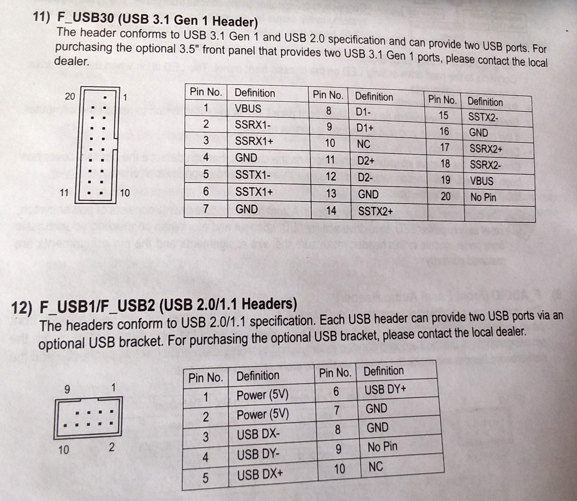

My motherboard has three USB Connection points.
There are two number 12 and one number 11.
I want to connect the two for the front panel.

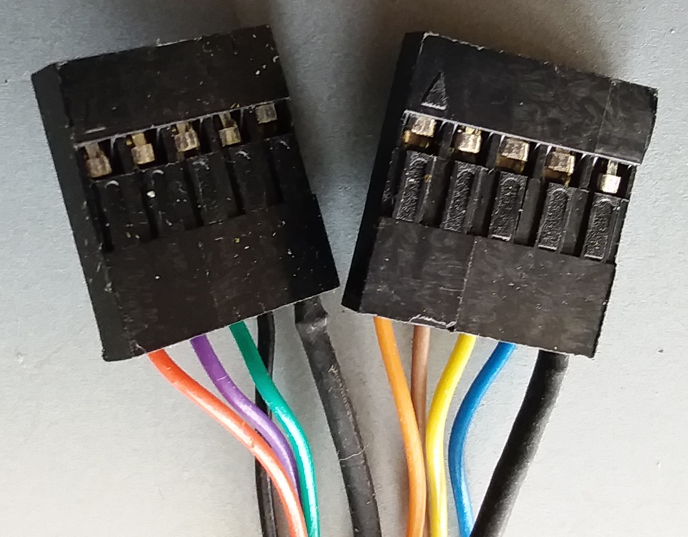

I expected the two front panel connectors to have the same wire color code.
They do not.
I am a little confused as to what goes where. Please help.
The wires/connectors you show are to fit the USB2 header (12).
The thick sleeved connection at the right in the photo is an extra ground "screen", not always used.
The go to the pin 9 / Pin 10 positions at the left in that header.
