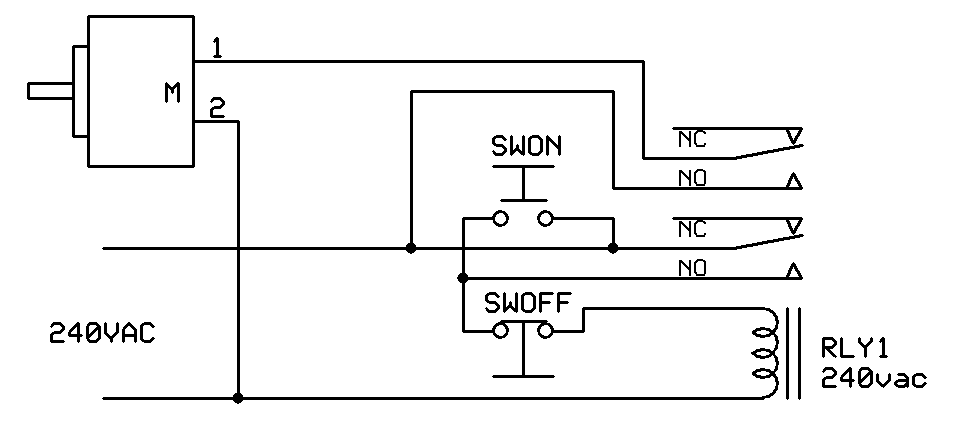

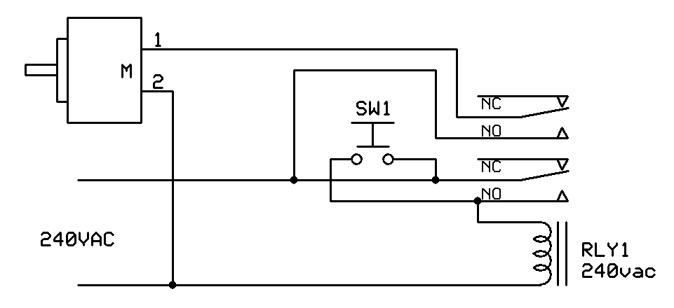

urgent help! is there such a "one-push-button" for on and off switch for 240V?
drew1900
Meaning to say, i can press the same button to turn ON the device, and the same button to turn OFF the device? And also, when the power supply is cut and re-powered back, the device must be in turn OFF mode whether prior before that it was turn ON or OFF (due to safety reasons for my setup)
I saw youtube that there were a lot of DIY tutorials to make the circuit. But is there such a circuit (the push button) available to readily buy off the shelf in the market?
Any inputs will be greatly appreciated.
Andrew
I don't know of a single switch unit that is mechanical that will do that. A N.O. pushbutton rated for 240VAC (low current) and a 240VAC DPDT relay rated for your load will work.
OOPS! You wanted "Push Off" too. That would require an second N.C. pushbutton in series with relay coil. :(
The term you want is "alternate-action". That is a mechanical switch that closes the circuit on one press and opens the circuit on the next press. They come with all kinds of ratings: AC, DC, low current, high current, lighted, etc.
BUT ...
Separate from that is your requirement that the switch go to the off position when source power is interrupted. No standard mechanical switch can do this. In terms of an electronic circuit, this is a toggle (T) flipflop with power-on reset (POR).

there, you've covered the first criteria, but can you show me how it resets to off position on power failure?

ok i found the solution.
No you have not.
What you have found is two switch no volt release, I was about to suggest that some time ago but then I realised that it did not match your "one push on and off" requirement.
Unless of course I mis-understood what you really wanted.
