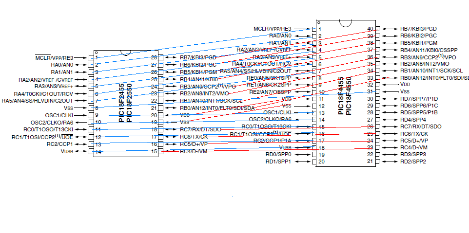

Hello,
Escuse me but I saw this article just now.
I would like to build this mini oscilloscope but with only the executable for PIC18f4550 I can not see how the connections between pic and GLCD.
Could I have the schema?
In the site of semifluid there are only connection to the PIC18F2550.
Ciao
Antonio
Tanks but this connection are referred to the pic18F2550 my pic is the 18F4550, with the same port it don't work.
Bye
Antonio
Use the same pins it will work just fine there the same chip core only the 18F4550 has more ports the
same pins are on both the hex will work too.
There just no PORTD on little brother 18F2550
I try but It don't works.
I loaded with my pickit2 the file .hex of this old post "18F4550 GLCD Oscilloscope DR1r1 - no bootloader, GLCD4550, 20MHz, bl" and I connected all as a scheme.
Antonio
You can use this hex you have to load the boot-loader it doesn't mater if it said 18f2550 it will work

Show only the positive part of a sine wave and it is positioned at the bottom.
bye
Antonio
The problem is solved with a bias created by a resistive divider and a capacitor.
