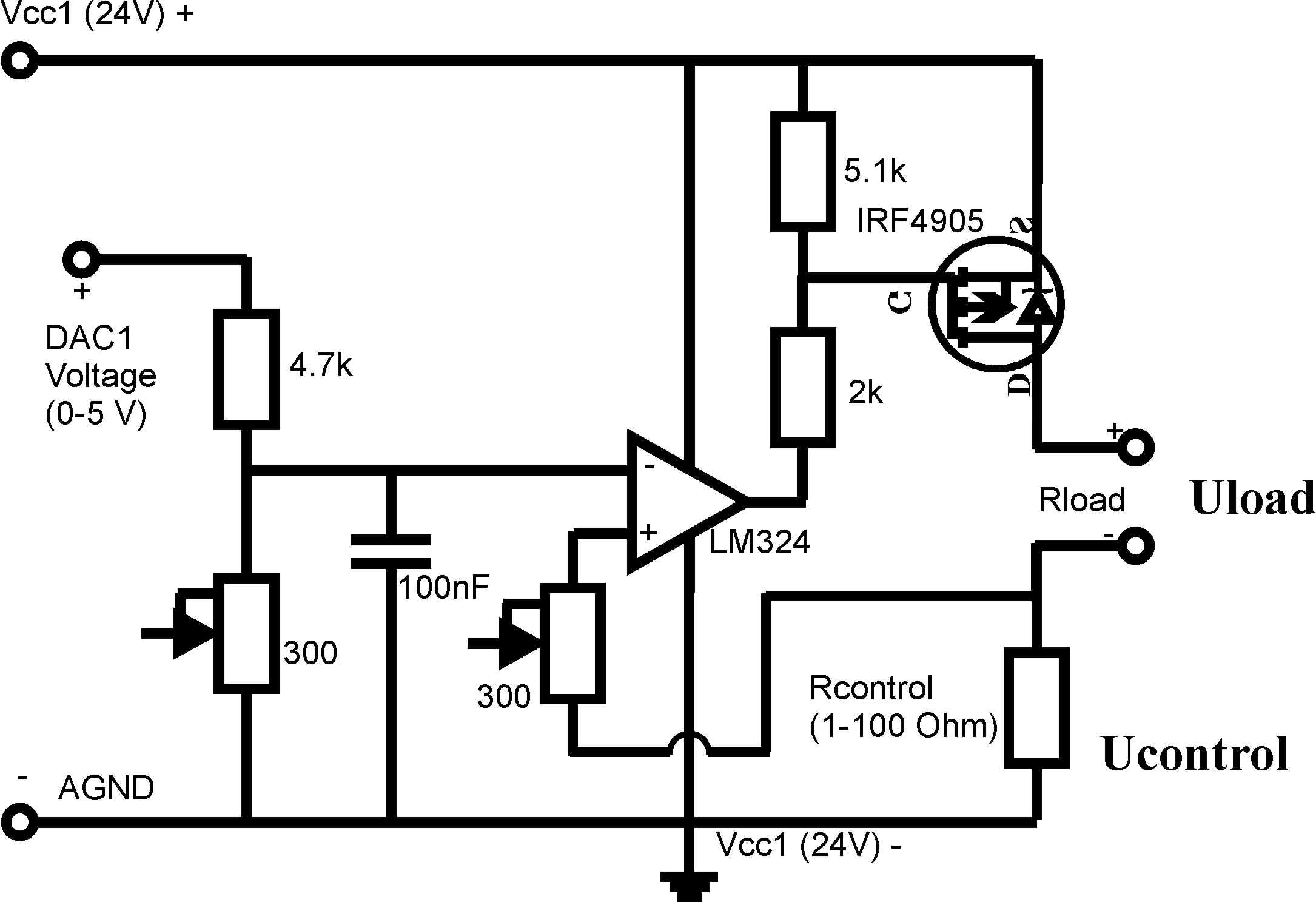

I am unable to make a voltage controlled constant current source.
So I am using the following scheme (Sorry for bad sketch drawing):
The constant control voltage varies in the range of 0 to 5 V is applied by constant voltage supply (like HY3002 from e-bay) or (in what follows) by DAC output of PC-controlled board. So the control voltage is rather constant and linear.
The desired output parameters: constant current on load from 0.5 to 150 mA.

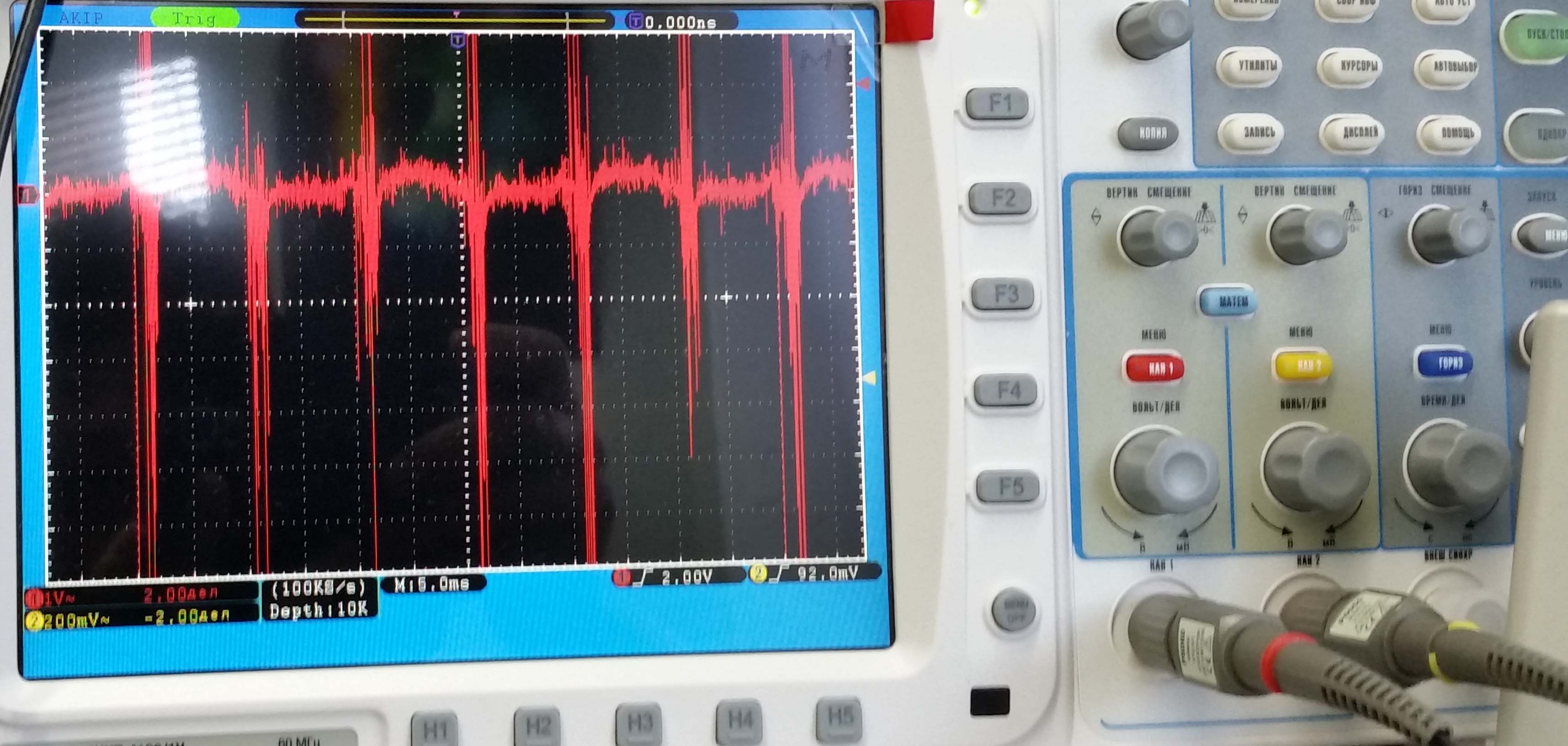

So, as a result, at the load resistance I have got the following signal.
The questions:
What is the source of this large noise in output signal and the signal spikes and drops?
It is possible to tune the scheme to obtain constant current or the used scheme is completely incorrect for constant current supply?
I suspect the opamp is oscillating doe to the delay caused be the capacitance of the FET gate.
Try adding a small capacitor between the output an negative input of the opamp; at a guess something between 10n and 100n should stabilise it.
Too small a value will not stop it oscillating, too large will make it slow to respond to load changes (of there are any).
the circuit is oscillating because you have positive feedback and no negative feedback. swap the inputs on the op amp.
An addition source of the oscillations is that the MOSFET provides added loop gain which is not compensated.
The added capacitor that rjenkinsgb mentioned should help.

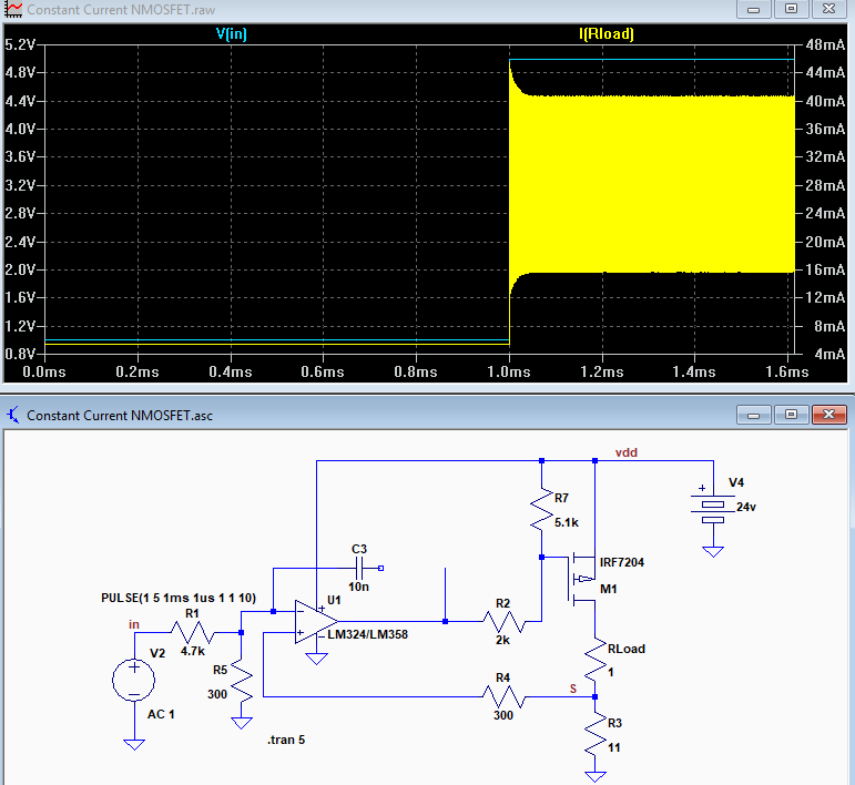

Here's an LTspice simulation with capacitor unconnected;

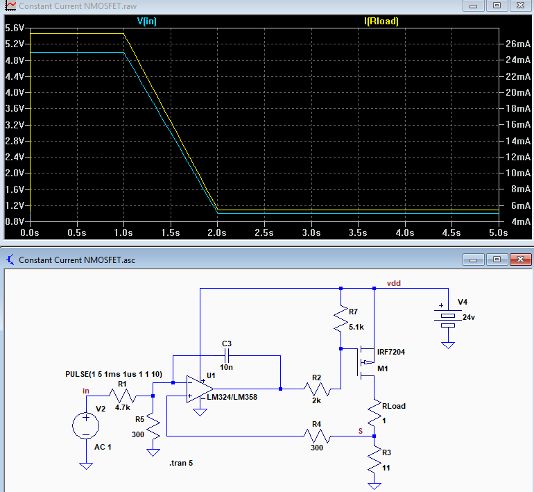

and capacitor connected:

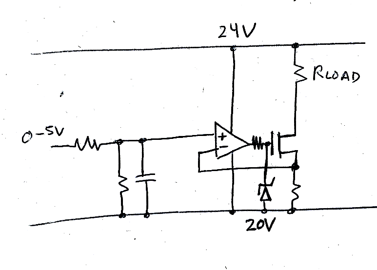

It is hard to make a current source like you did. The total gain is (op-amp gain X MOSFET voltage gain). I switched to N-FET or use a npn transistor so there is no voltage gain and no inversion.
The Gate-Source max voltage should be held down. Many MOSFETs are rated for 20V and that op-amp will produce 22.5V when Rload is open so I added a resistor Zener.

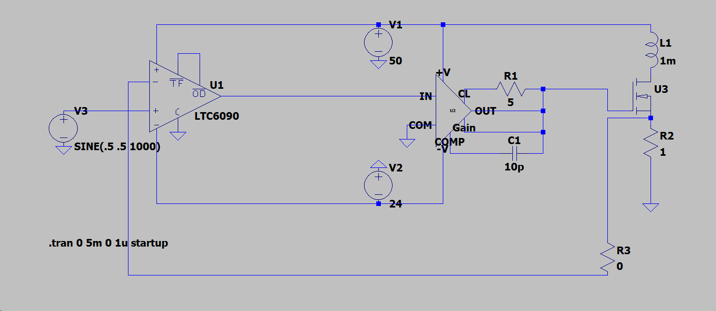

Yeah, I think stability was definitely an issue. I've had a few versions of the circuit and some worked better than others. The one that worked best used just an LTC6090 driving a linear-optimized power NMOS + heatsink block (not shown but was basically the circuit below without the power op-amp in the middle).
Unlike the schematic shown, it used multiple LTC6090 in parallel with thermal shutdown enabled but in the LTC6090 was very prone to overheating and dying. So I added in a heatsinked power-op amp to get the circuit below and it became even more finicky. The negative power-rail of the circuit got blown while I was trying to get it to work so it has a offset now and haven't replaced the power-amp because it's like $130. Super finicky and really noisy. You can practically see the control loop trying to do its thing looking at the waveform.

Looks like the inductor could use some back emf clamping. It's a boost converter with no load in one operational mode :)
Schematic in post #12; why a power amp to drive a Gate? Why +50 volts and -24 volts to drive the gate. If the load is removed the mosfet dies. Quickly removing the current kills the fet. The power driver is hot because of oscillation. Two amps?
The actual circuit has TVS diodes across the power NMOS, amp, but not across the inductor because it was physically impractical without really long lead wires. Otherwise, yeah, the circuit would have blown from voltage spikes long ago.
The -24V could have been a lot less but was the most convenient supply I had and is just there to provide a little negative supply since I needed to work close to 0V but the LTC6090 is not a rail-to-rail op amp.
50V is what was required to produce the necessary slopes to produce the current waveforms we wanted in the inductor. THe LTC6090 is powered off 50V so it can accept the worst case current sense voltage even though it never actually outputs that during normal operation, resulting in a volt of voltage drop across it, which I think was the reason it overheated.
The power NMOS was a IXYS IXTN200N10L2
https://ixapps.ixys.com/DataSheet/DS100238(IXTN200N10L2).pdf
The power-amp was an Apex PB58:
https://www.apexanalog.com/resources/products/pb58u.pdf
Now that I type this out, I realize some details were left out. The actual setup has six power NMOSs in parallel which I forgot to put into the simulation schematic above. I need to add that.
Note that in all this, there were TWO versions of the circuit. The schematic shown in is the SECOND version (but omits the six parallel power NMOSs which the actual circuit has).
The first circuit is essentially the same thing, but without the power-amp in the output path of the LTC6090 wired as a unity buffer, and with four LTC6090s in parallel. This circuit was less finicky than the one containing the power-amp but suffered from the LTC6090s overheating. The second circuit with the power-amp (aka the schematic above) did not overheat but was even more finicky.
You mention oscillations. Are you referring to oscillations due to instability? Or just the regular oscillating nature of the signals coming from our source signal? Because whenever the LTC6090s circuits died due to heat it was stable (or maybe only marginal stable, since as I previously mentioned, there was a lot of noise riding on the waveform. It almost looked like it wasn't noise but was the control loop visibly fighting to keep the circuit under control). This "noise" was present in both versions of the circuit.
