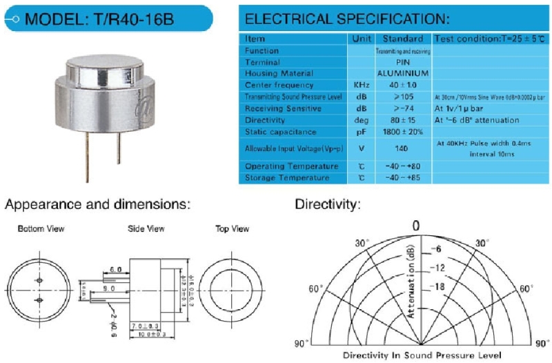

A few months ago I got a few T/R40-16B ultrasonic transducers which send and recieve ultrasonic signals in the same package. Now the problem I'm facing is the transducer is so new there isn't any information on applications on the net (that I can find atleast). Idealy I want to set them up as rainwater tank level sensors and transmit the levels to a pic microcontroller via 433mhz wireless.
Question:- Has anybody seen or used these transducers and maybe point me to a few application notes or circuit schametics???
Cheers Bryan1

They look the same as any other ultrasonic transducers, there are plenty of designs on the net.

True there are a few schematics on the net but all the ones I found use 1 transducer for transmitting and another for recieving. I was hoping I could get a link to show a circuit using the transducer I have but when I google the part number for ideas it comes up blank or just gives links to suppliers. If you or someone else has links to application notes would it be possible to post them as I keep drawing blanks when I try :oops:

It's normal to use seperate transducers, particularly as they have very different characteristics - the transmitter is series resonant, and the receiver is parallel resonant.
As a minimum to use the same transducer you would need to either switch the transducer between the transmitter and receiver, or arrange a configuration that connects to both without causing interference with each other.
Looking at this device, I'm not so sure it is Ment to be a Reciever/Transmitter Simutanously.
I would be more inclined to believe that you can use it as a Reciever, Or as a Transmitter. In other words I Think you need Two of them.
Just my opinion.

I know this is a basic question but with the transducer in the photo is the long lead negative or positive? . As this is my first time playing around with transducers I dont want to short circuit the guys in my first attempt. After looking again at some sites I've got a good idea on how set up a test circuit .
Cheers Bryan1 :D

They aren't usually polarised, but one lead normally connects to the metal can, this should obviously be used as the ground connection.

You will have great difficulty in using then for short range as they don't shut-down fast enough for you to start to listen. That's why they use two for short range.
