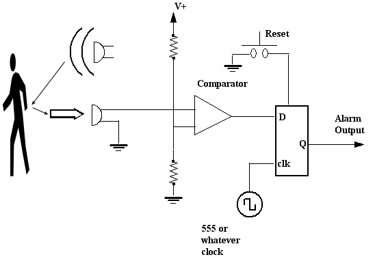

Here is a basic functional block I came up with. it is by no means a design, just a concept drawing.

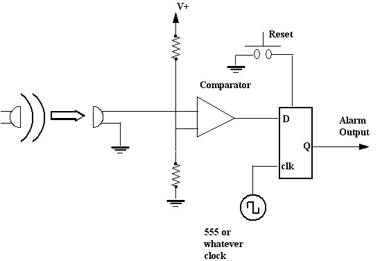

I just noticed something. This circuit that I was referring to that only uses transistors is used in a different configuration than what I want. The transducers are pointed at each other and when someone steps inbetween, the signal is interrupted. This is not what I want so maybe what I want is too much :rolleyes:
Well, maybe my first image was not clear, and I have never built such a thing, but you should be able to keep TX and RX in one unit. You will just have to test for smaller RX changes.
Assuming Signal has a wall or some such to reflect. I dunno.
You might be right mneary. I was just looking at my concept and people may be sonic reflectors instead of absorbers in which case the circuit might have to detect an increase in RX power. Anyways, I think I am out of suggestions :)
