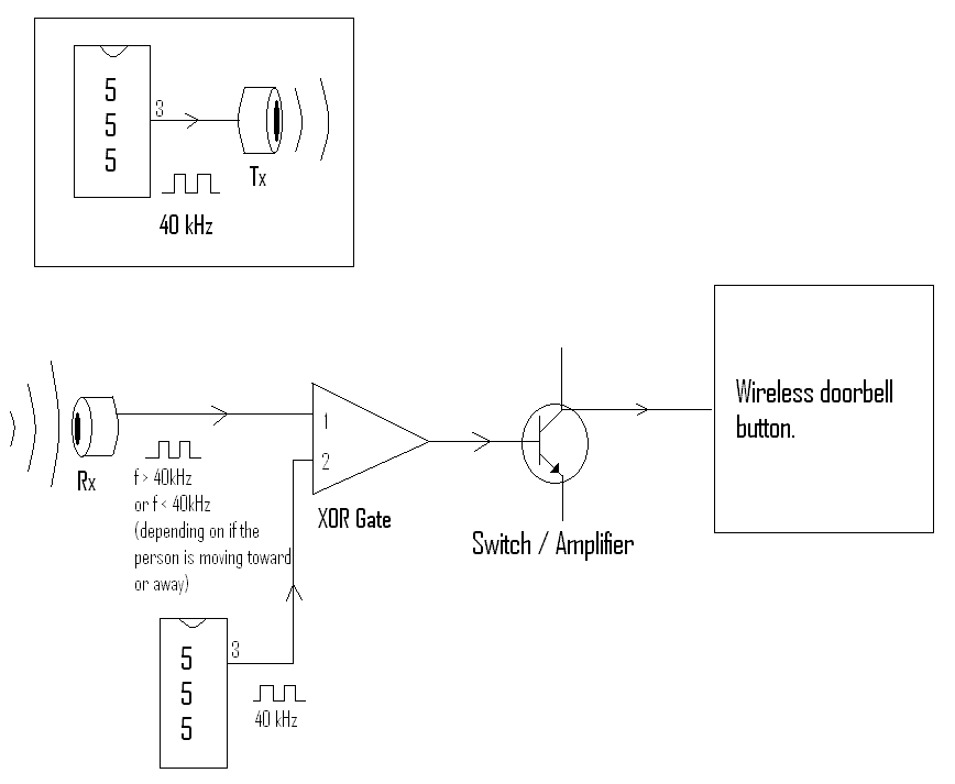

Well here is a rough sort of flow diagram on how I think my circuit might be able to work. I made this in paint but I think I did a damned good job :D
Let me know if there is anything I am missing besides the obvious components like resistors, capacitors, etc.
I believe the signal coming out of the 555 timer is essentially a square wave correct? If so, I would not have to convert analog to digital. Or does the reflected signal come back analog and so I have to convert it to digital before passing it through the XOR gate? Also, is it okay to connect the output of the XOR gate to a transistor?
Thanks again for all of your help.
Edit: The ultrasonic transducers will not be placed facing each other. They will be placed next to each other so that the signal has to bounce off the target and come back to the receiving transducer.

That circuit will never work. Without some way of locking the two signals together, they will never be in phase with each other. An XOR will only work if you can guarantee it is phased and frequency locked. Due to the fact that a 555 is thermally unstable your two oscillators will never be the same frequency. Even if the frequency was dead nuts on, you would still have to be phase locked.

I knew it was too easy :)
Time to brain storm again.

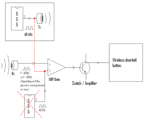

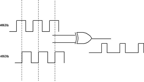

See here is your problem. Notice in the diagram, both inputs to the XOR are same frequency but different phase so XOR outputs a false detection.
In order for this to even have a hope of working, you need to use the same oscillator for your TX and RX, see modified image of your original drawing.
The XOR itself will almost always have a voltage on its output. You have detected a moving object when that voltage changes. You need a band pass filter at the output of the XOR so you only respond to frequencies between about 20 Hz and 500 Hz. I explained this earlier. If you read it and still don't understand, please ask questions.

I understood your side of it but i was wondering if I could do this without the filter. I thought the XOR gate only outputed high when inputs differed and remained low when inputs were equal. I know low does not mean 0V but if the difference between low and high is reasonable enough, then i can just add a resistor so that the low voltage is dropped enough so that it does not "activate" the transistor while the high voltage is still large enough after the drop to activate the transistor.
Correct me if I am wrong in anything I have said. I do not mean to dismiss the information you have given me, I am just merely playing around with the circuit to gain a better understanding of what is possible and what is not. I really appreciate all of your input. It has been very helpful.
