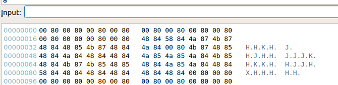

Im getting this now

In the first post the PC appears to be displaying the hex value but in the second it's trying to display the ascii character. You should get values like 37 82 for the hex value 137 and 00 80 for zero.

USARTWrite(a & 127); this at ground sends 00
USARTWrite((a>>7) | 128); this if at ground sends 80
With both in main I get 00 80 00 80 so on

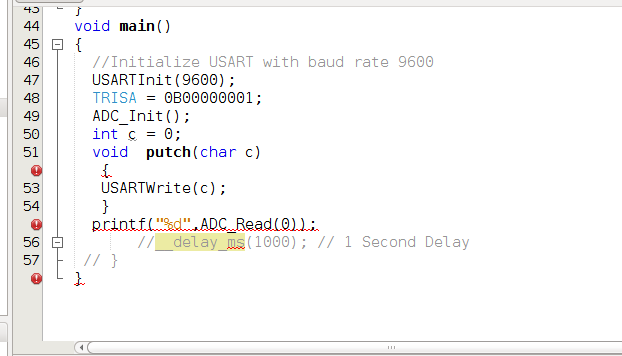

There is a function that directs the output to the output of choice But you must write it!
C:
void  putch(char c)
   USARTWrite(c);
write this above your main.. Then you can just do this..
printf("%d",ADC_Read(0));
I get this
usart_test.c:52: error: (314) ";" expected
usart_test.c:55: error: (194) ")" expected

Above the main... Not in it!!!
void  putch(char c)
   USARTWrite(c);
void main()
  //Initialize USART with baud rate 9600
  USARTInit(9600);
  TRISA = 0B00000001;
  ADC_Init();
  int c = 0;
       //__delay_ms(1000); // 1 Second Delay

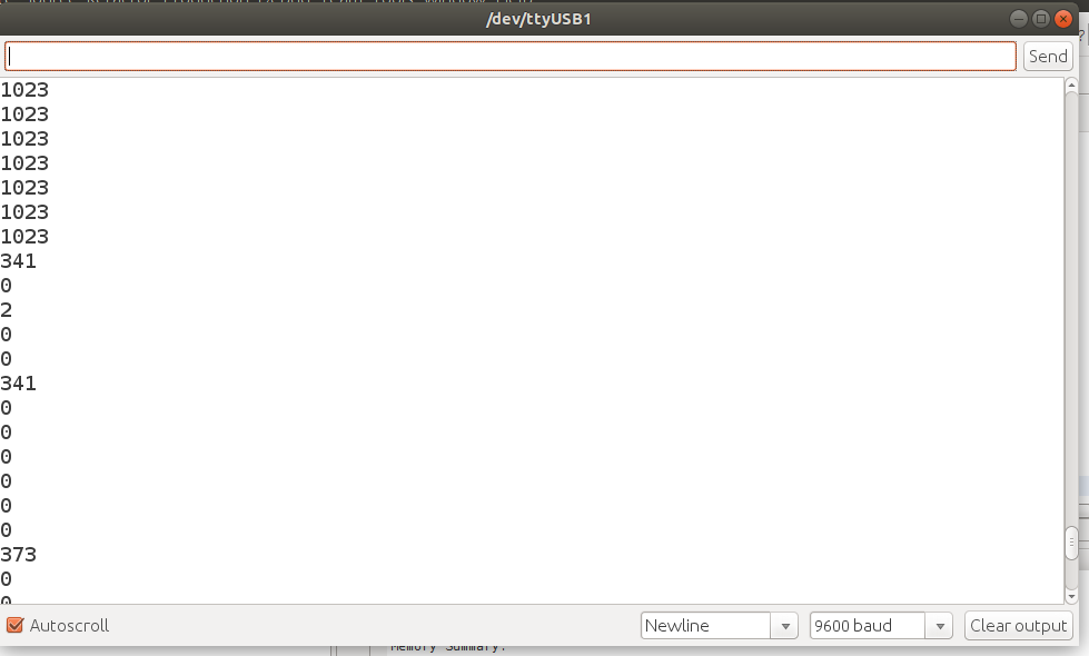

That works now it figure new line
printf("%d\n",100);
That works

I changed chips I now only get to reading 0 and 1023 there is nothing showing if I move the pot
no range there
I have the pot set to 2.3 volts its shows 1023
