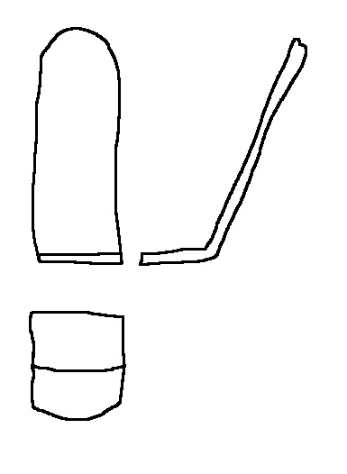

I'm looking for this type of terminal, what is the proper name for it? I've gone through digikey terminals, but wasn't able to find what I'm after.
You solder the pad and then you're able to have the terminal rub against a wall like a spring. The wall is vertical, so the terminal won't be on a 135 degree angle but 90 degrees, thereby ensuring contact if you know what I mean.
Simple thing, but I don't really want to make them myself.

I've seen things like that used in equipment but never seen them sold as such.
Depending on the size of the individual contacts, you could possibly cut up some form of grounding spring strip "finger" type material into individual sections?
There are thousands of variations of style and shape of that stuff..

Thanks for the links, Orbel EMI CONTACT RINGS (MALE) looks pretty close to what I'm after depending on how much they cost. At least another option on the table.
I've looked at that style for my requirements; they tend to be very high force - OK for retaining an AA cell but not good for a movable contact.
It depends on your application & how much side load it can stand?
The nearest battery contacts I found that could possibly be suitable have a "Z" bend so rather more flexibility, but the manufacturer has ignored requests for prices.
The type with a sideways coil spring are cheap and readily available.
On the down side, they all seem to have a chrome plating which is not ideal for electrical reliability.
