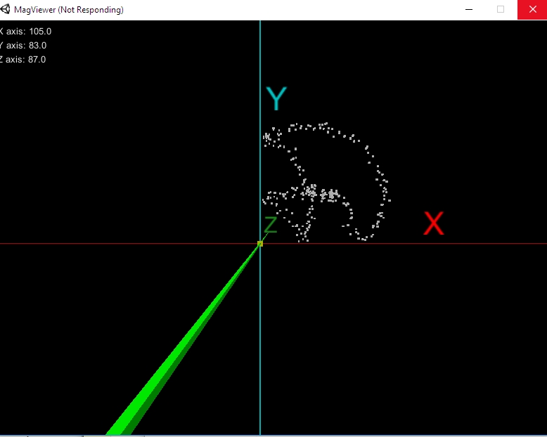

They are as the image in #52.
Once these are running, they show in the top bar.
Move the compass module around in these 12 orientations, (see image), while pressing the nearby button to enter each READing into Magmaster.
The Magviewer only needs the DATA as #52.

I've puzzled myself about the 255s. I get the impression that the sensor needs 9x BITs to get 360DEG, but simply fills up the BYTE, giving 255. This also give the twos compliment BIT.
Here is the program I used to get those figures on that date:
I am pretty sure there are errors in the program (I do get a bit mixed up:confused:), but I think the HSEROUT gives the correct order for Magviewer. I also 'stuck in' a comma into HSEROUT to see if any DOTs in Magviewer crossed any line, DOTs did cross the line.

HI J,
I've re-written the program:
Here is a more interesting Magview, but still no line crossing.
There needs to be a way of programming 'negative sign'

Hi J,
I changed the program but the Magviewer shape is the same?
I think the problem still revolves around the lack of negatives. I'm pretty sure Oshonsoft can't produce them.

Of course Oshonsoft can produce negative values if the word in twos complement is negative.
This means that the sensor doesn't produce negative values or you are not using the sensor in 16bit mode.
Did you rotate the sensor when getting these values?
Can you show Xlow, Xhigh, Ylow, Yhigh, Zlow, Zhigh bytes and the code again.

Hi J and M,
Here is the latest program:
360 CW + CNTL1 shows:
BYTES = 3x Outputs after twos compliment calc inside [ ], then the CNTL1 BYTE=18 shows the compass is in CONTINUOUS MODE and 16BIT.
DATA = 6x RAW BYTEs
All from a Terminal while rotating 360 CW.
