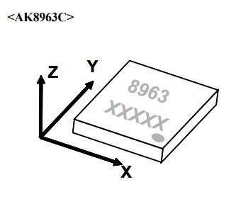

Finding a compass module has been a bit of a puzzle. It needs to be SPI configured, which isn't always straight forward.
I found a likely one, used in iphones AK8963C. This appears to be working, here is a TXT of READings, showing the registers: Xx2 Yx2 Zx2. First I rotated as a compass, then a 'barrel roll' then head over heals.
Can someone verify, that the BYTE which is mainly 0 or 1 or 254 or 255, is the SIGN BYTE, before I proceed please?
C.

I'd say it's a 16 bit twos complement number & the mostly 0 / 255 byte is the top half of the value.
It look like the range is about +/- 360 so the high byte does not have a large range.
so eg. for a line with varied values:
DATA 253 254 101 255 151 0
In hex that is:
FD FE
65 FF
97 0
Swap bytes and you get:
FEFD = -259
FF65 = -155
0097 = 151
In hex that is:
FD FE
65 FF
97 0
FEFD = -259
FF65 = -155
0097 = 151
Hi R,
Yes, it's definitely twos compliment, and I guessed the BYTEs were the wrong way round, but I don't have confidence in maths, so I'm glad you verified it.
I'll swap the two BYTEs round and carry on, thanks.
C.
