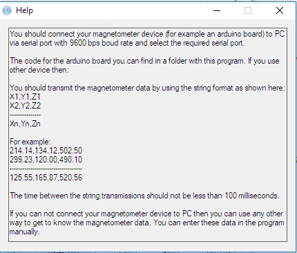

Hi J,
The Magmaster needs 6x values.
C.
J and P,
Yes, a bit confusing!
It needs the 6x measurement register READings, in this format. ( I added the - to the HSEROUT, so not real, but it worked)
255, 255, 255
78, 230, 138
255, 255, 255
89, 225, 137
255, 255, 255
84, 230, 146
255, 255, 255
84, 228, 150
255, 255, 255
87, 231, 149
255, 255, 255
81, 231, 143

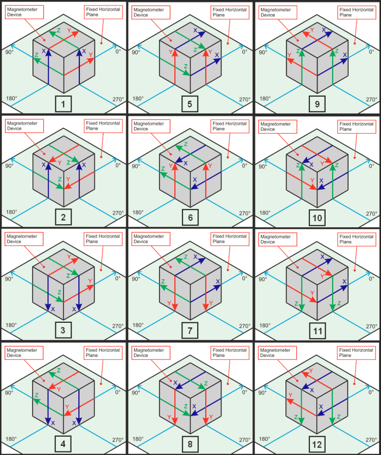

They are as the image in #52.
Once these are running, they show in the top bar.
Move the compass module around in these 12 orientations, (see image), while pressing the nearby button to enter each READing into Magmaster.
The Magviewer only needs the DATA as #52.
C

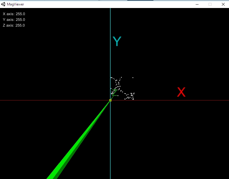

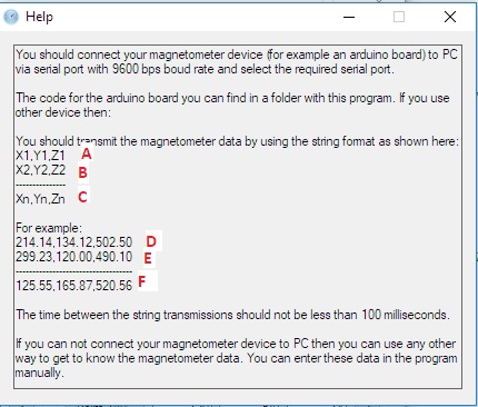

Hi M and J,
Stuck again :banghead:
Here is the Magmaster DATA again:
Will someone tell me where twos compliment and floating point starts and ends in ABCDEF please?
(I have the calculation for twos compliment)
If I enter A and B I get this (Magviewer)
There are no negatives. so all of the DOTs are in the same quadrant!#
I use the Magviewer LIVE as I send the DATA via serial and radio modules. Once I get DOTs in all 4 quadrants, I'll follow the 12 orientations in the instructions while entering DATA into Magmaster.
EDIT: In yellow
C

Hi M and J,
I use the Magviewer LIVE as I send the DATA via serial and radio modules. Once I get sensible results, I'll follow the 12 orientations in the instructions while entering DATA.
C
The coordinates before the calibration is done can be floating point or 16bit signed integers
When the calbration is done you get the correction coefficients M11 - M33, which are in floating point, see pictures 1 and 9.
Because Oshonsoft does not handle signed integers, it is easier to convert the twos complement coordinates to floating point from the beginning and then send them to Magmaster, something like
Hserout #Xf, #Yf, #Zf.... etc
Converting to floating point can be done in the same way as in the pressure sensor program:
- make 16bit integer from Xlowbyte, Xhighbyte-> Xraw
Xfloat = Xraw
if Xfoat > 32767 then // is it negative
Xfloat = xfloat-65536
edit: corrected the xfoat negative calculation
