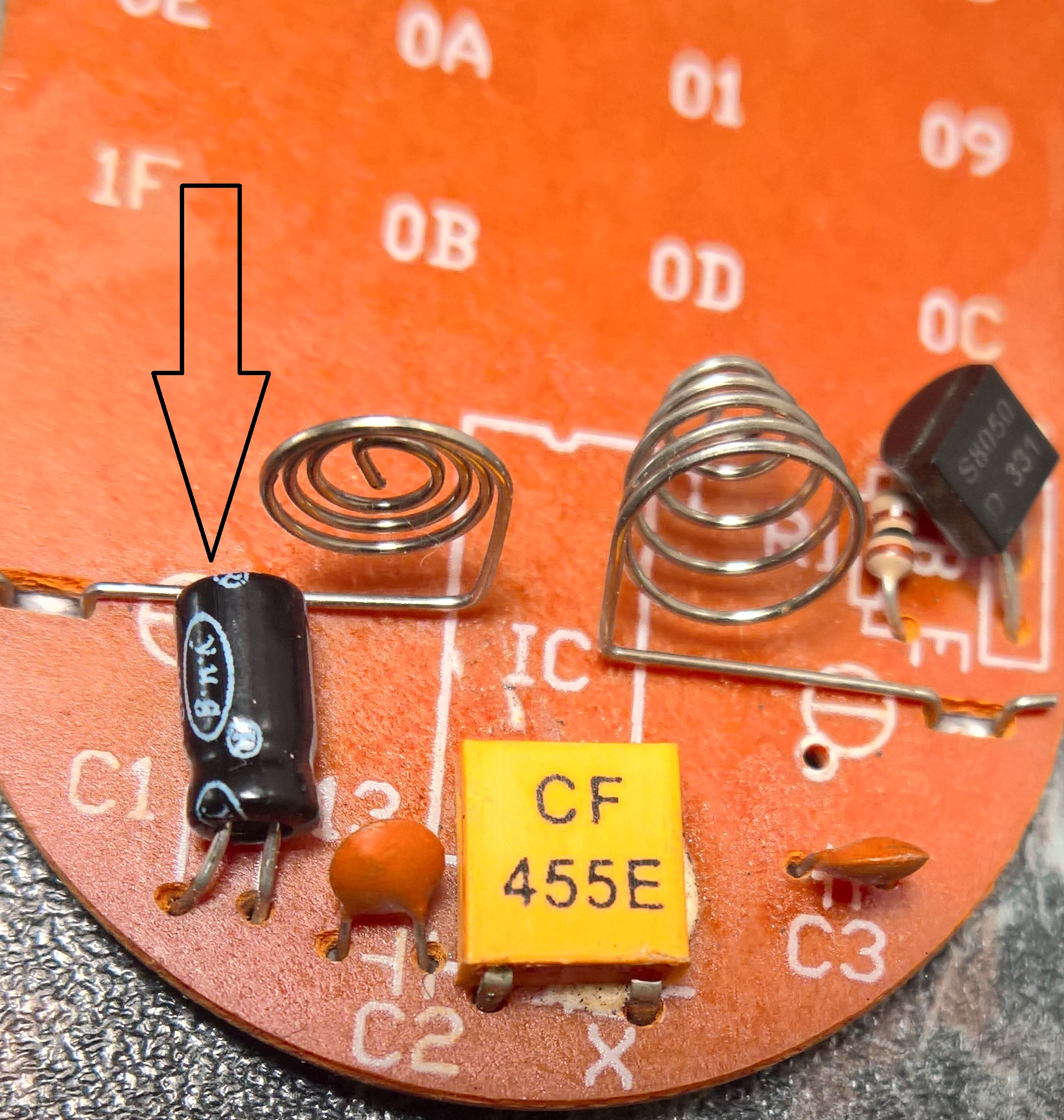

I second, third, quad, Nigels comments regarding the electrolytic. If you can't test it get a new capacitor.
Most remotes are 3 or 6 volts so a 16 or 35 Volts cap should suffice, as long the size is about the same and fits.
There should be zero leakage current when no buttons are depressed.
I had a similar condition with Sat Remote that eradicated by replacing the capacitor ( 10V 47uF ) on the remote Board with an equal one.
For better understanding I gonna include an image too.
