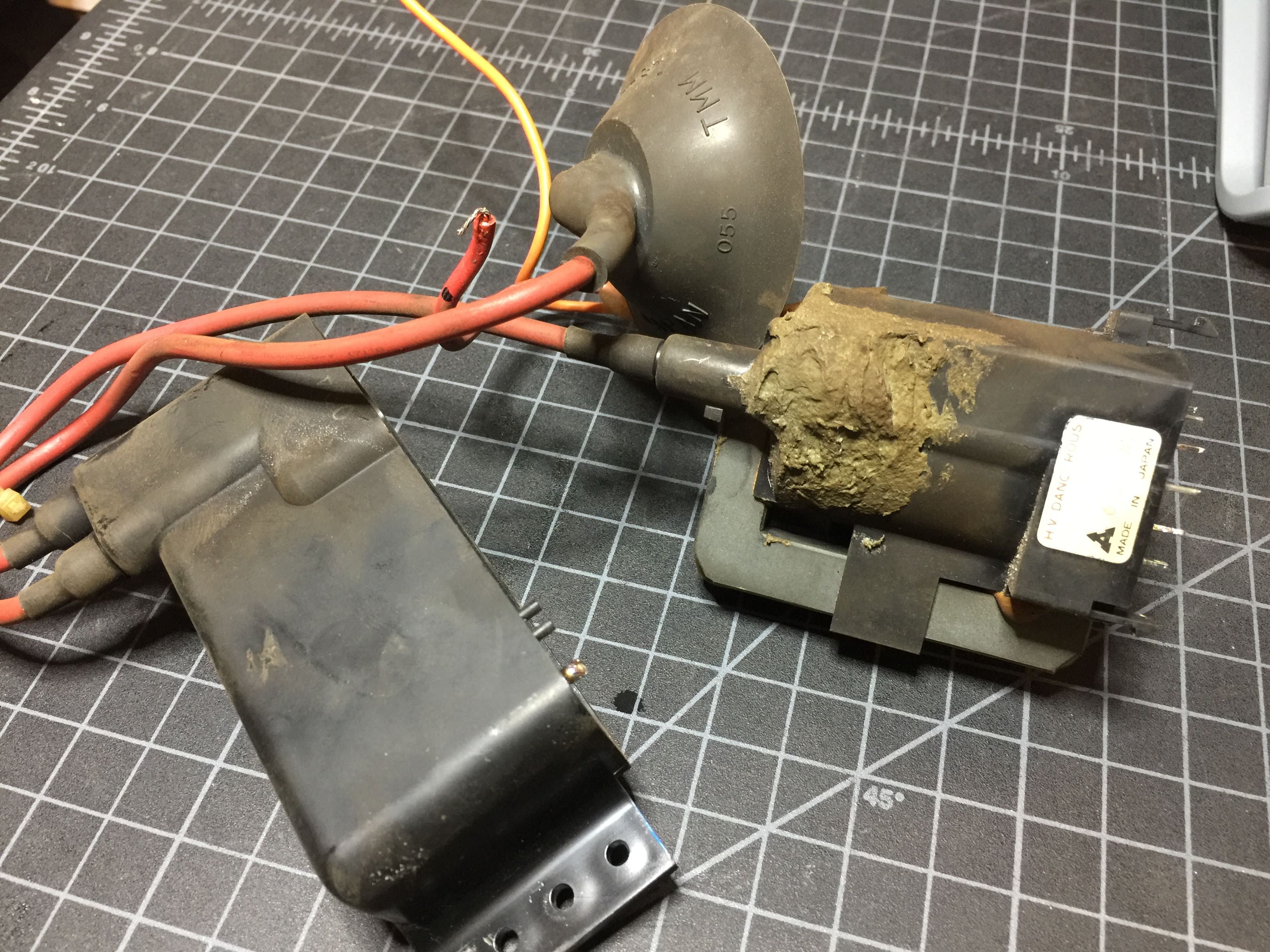

I need to replace the flyback transformer on my Atari SC1224 CRT monitor. The flyback I removed from this monitor has a model number of Kf4825G, and has an RC snubber attached to it, which does not seem to be easily removable. The high voltage cable goes through this to the CRT. Here is a picture of the bad flyback:

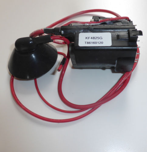

The only replacement flyback I've found, which according to the eBay listing it's a replacement Kf4825G flybacks, does not come with the RC snubber. This is the eBay listing for it. And here's a picture:
Is it possible that with this replacement flyback, the RC snubber is not needed? Or, should I attach the existing RC snubber to the new flyback? It does not seem to be easily disconnected from the flyback. Looks like I would have to cut the thick red HV cable? (I don't think that's a good idea)
I already messaged the seller asking this, but he has no idea.

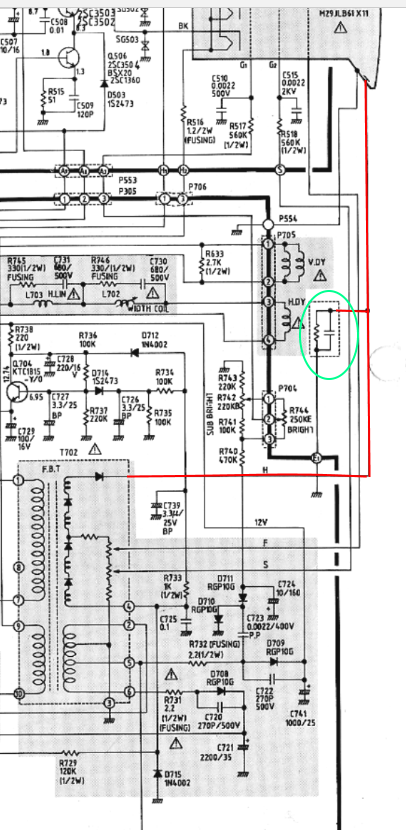

the RC snubber
Not a snubber.
I marked in red the high voltage wire. From the flyback to the CRT. The bleader resistor is to discharge the high voltage before you can get shocked. And it helps regulate the high voltage supply by placing a minimum load on it. The capacitor is like the capacitor on any power supply after the diode-transformer. (There is more capacitance inside the CRT but the external one adds to the regulation)
It is possible you can get a transformer with the R & C inside the transformer.
From the ebay picture I can not tell if the transformer has the RC inside but I think it does. Does it have the F and C pots. I can not see and there is no data. From every where I checked there is no data on the new transformer and that is not good. "Flyback for China TV" That is not enough information.
Basically all you can do is try it and see if it works - and as already mentioned, it's not a snubber.
Performance wise the only differences if those components are not inside the transformer are:
1 - the CRT will stayed charged up - this is extremely common anyway.
2 - without the capacitor the picture may experience more 'blooming' (picture size varying with brightness).
Most CRT sets didn't include either of those two components, relying on the CRT capacitance (between aquadag and final anode) to provide enough.
if it's any help, the original part is a Panasonic flyback. it's likely (if the replacement flyback works) you will notice nothing different. you will need to adjust the focus and screen controls. the screen control adjusts the background. with a raster with no video (black background) you should adjust Screen until the background just barely disappears. for focus, you need a test pattern, or a screen full of text, and adjust for the sharpest overall image. since the flyback provides power supplies for other circuits in the monitor, you may need to readjust a few things like H size, H linearity (since the FBT is the horizontal output transformer it's very likely these will need adjustment). V size and V lin may need some adjustment, but probably not much as long as the power supply rail voltage doesn't change much. some
