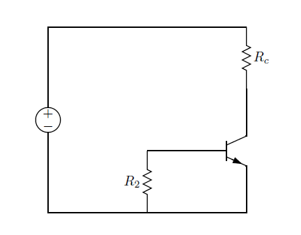

My question involved transistors. Specifically, the book discusses using transistors as high-speed switches controlled by a mechanical switch. When the switch is open and the BJT is OFF, the attached diagram is shown in the book. My question specifically is Why does base have to be grounded (rather then just disconnected) and assuming it is grounded, why is R_2 necessary at all?.
If the switch was open and line was not grounded, there still wouldn't be any base current and therefore the transistor would still be OFF. I don't understand.
Can anyone explain? :confused:

A transistor has capacitance between each pin. If you let a base float then its capacitance to the collector and emitter keep it turned on for a while when the base current is turned off. A resistor from the base to the emitter discharges this capacitance quickly so the transistor can turn off quickly.
Thanks for the quick response. :) I'm going to ask some more (possibly very stupid) questions. Please excuse my ignorance.
Why would capacitance keep the transistor on with no current? Does it have to do with a voltage between the base and the collector?
Why not just make it a short? Why the resistor? Does it have to do with not overheating a wire with excess current?
Because the capacitance provides the base current to kerep the transistor turned on while the capacitance is discharged by the base current.
a short will discharge the capacitance extremely quicjkly but then the transistor will never turn on again until the short is removed.
With a resistor then the signal source can drive the resistor and turn on the transistor then the resistor turns off the transistor.

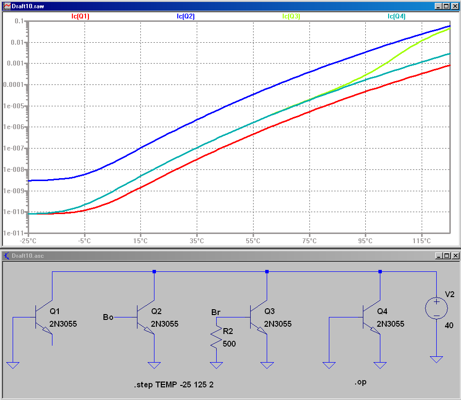

There is another, more insidious reason for providing a DC path to ground for a transistor that is supposed to be OFF. That is the reverse leakage through the collector to base junction, especially at elevated temperatures. Having a resistive path to ground prevents the current gain (β) of the transistor from amplifying the reverse C-B leakage. If there is no path from base to ground, then all of the leakage gets amplified by β.

Stare at the four cases below. I plotted the collector current for all four cases as a function of temperature. Note that case 1 is just the reverse CB leakage. Look at what happens to it depending on what is going on with the base (floating, grounded through a resistor or hard grounded)

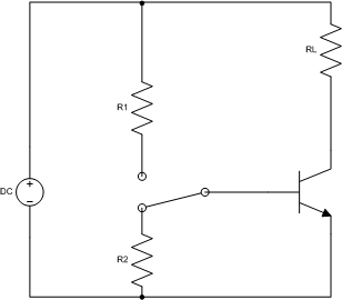

I have a feeling that my initial drawing wasn't as clear as it could be. Theres a SPDT switch involved that I failed to draw initially.
I don't have use of my laptop until Monday, but when I get it back I'll be sure to post a more accurate drawing and ask a few more questions about everything you have all posted in order to make sure that I understand it.
Thanks again! :)
Sorry for my absence. School started up and I got very busy very fast.
I'm attaching a full circuit diagram. Do the above explanations still make sense in this new context? I'm afraid I'm still not very clear on all this... :(
I've also emailed the author himself (with a link to this thread), but I haven't heard back yet.
As always, help is appreciated. :)
Hello there,
As others have pointed out collectively, there are two main reasons for wanting to
ground the base of a transistor either directly or more usually through a resistor.
1. To turn the transistor off fast.
2. To keep the transistor from turning back on through it's collector to base leakage.
With 2 above, the resistor keeps the voltage at the base low so that it can not
get up to the required 0.6v or so that would start to turn the transistor back on
again.
With 1 above, the resistor 'sweeps' the charge out of the base region faster than
it would if it were left open or instead connected to a much larger resistance.
I must say though that even a resistor is not the ideal choice for turning off a
bipolar transistor as fast as possible. The best way is a resistor connected to
a minus (negative) power supply source like for example -5v or so. This causes
the charge to leave the base faster and thus turn it off faster than connecting
the resistor to ground. Once this action is deemed complete, the resistor can
again be connected to ground and this property gives rise to a turn off mechanism
sometimes known as "snap off", and is made with a little circuit to store just enough
energy to make this happen and not always require a negative supply.
The limiting factor when doing this is the reverse base emitter voltage rating, which
unfortunately for many transistors isnt very high at all so we can not connect it to
very low minus dc sources which would turn it off even faster.
There are also biasing techniques that can prevent the transistor from entering
saturation, which also speeds up the overall switching speed of the device.
