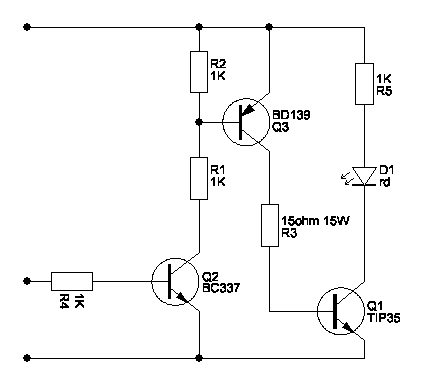

Ok, have decided to go back to the idea of transistors. Attached is my completed circuit. Your thoughts please!

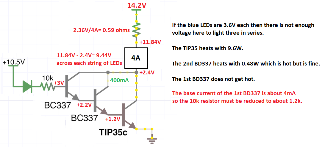

There is so much voltage loss that there is not enough voltage to turn on three 3.6V blue LEDs.
The TIP35 will get VERY hot (it will need a pretty big heatsink) and the 2nd BC337 will get hot but will be fine:

I'll say again, as I did in the previous similar thread, it's very poor to use a darlington in that way, as there's very little collector voltage on the BC337 collectors, and thus little current to drive the TIP35. It's FAR better to drive the BC337 collectors from the higher supply rails.
Even better, as there's three transistors, is to make the middle one PNP, fed from the collector of the first one, both of course powered directly from the supply rail - maximising base current for the TIP35.
Or, as you say, use a suitable MOSFET.

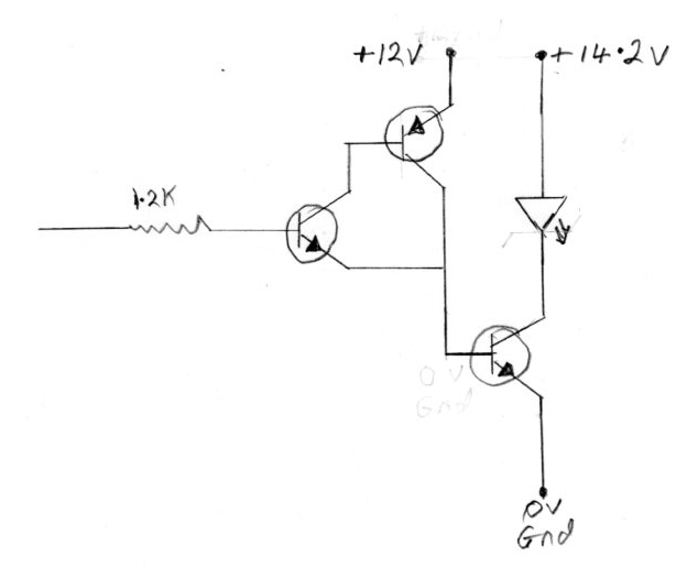

Forgive my ignorance. Below I have drawn what I think you mean and have changed the resistor to the base of the first npn from 10k to 1.2k.

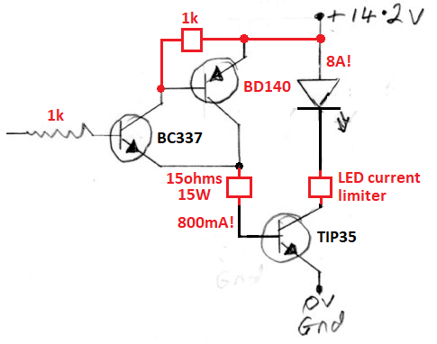

Using ordinary transistors providing a massive 8A of current when driven from a weak Cmos CD4017 you need the circuit to be like this:
EDIT; Driver transistor is a PNP BD140.

Thank you for your clarification and details for the circuit. I am an electrician in New Zealand so more used to 230vac or 3phase. My electronics kniwledge is quite limited but something I do find interesting.

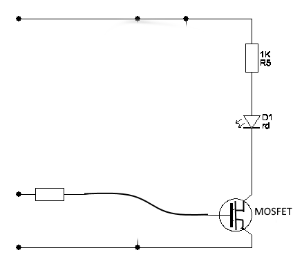

OK I have managed to find a supplier for the IRFP3206PBF mosfet. So lets start again. 10k between the 4017 and the mosfet?
no, you can use much smaller value resistor from CD4017 to gate. Like 1000 ohm for your slow switching speed. But use a 10k to 100k (any sizein between) from gate to ground).
note: the Mosfet gate is essentially a 1nF capacitor that you are charging, no continuous current flow like your other transistor..
