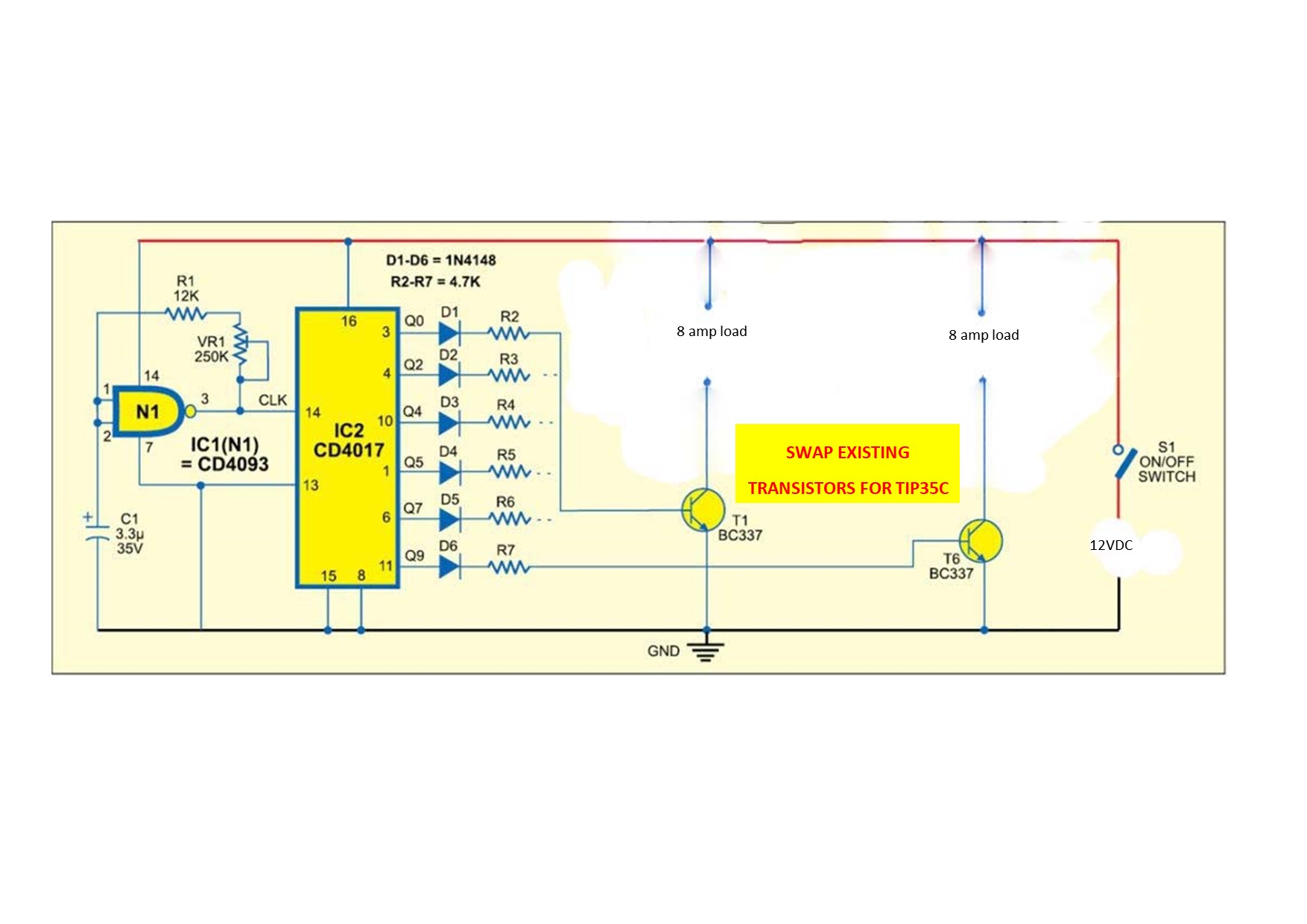

I have adapted a circuit for my own purpose. Currently the outputs of the CD4017 go to a 4k7 resistor and then to the base of a BC337 transistor. Can I swap out the BC337 for a TIP35C? Do I need to change the resistor value? Do I have to drive the TIP35c via a smaller transistor like the BC337? Your help would be much appreciated. Thanks.

I have attached the circuit. The supply voltage will be 12vdc. I am looking at a load of 8 amps max. According to the book TIP35c is 125w, 100v, Ic cont 15A, Hfe 15/75.

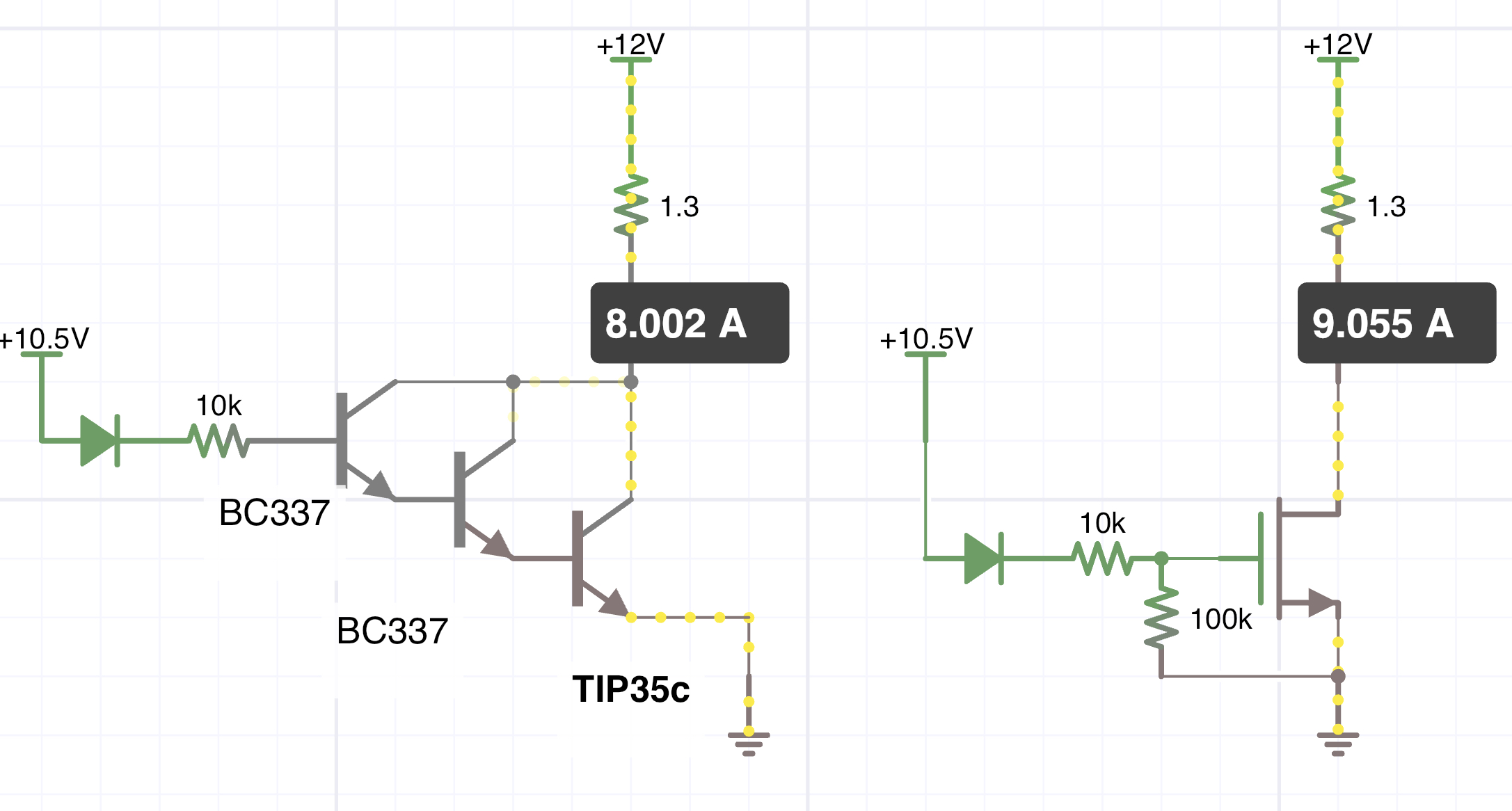

The recommended current source on the cd4017B is about 1mA to 1.2mA. So, you need current gain ~of 6700.
also, when switching is done, we generally want more than the minimum gain. So let's boost the 6700 to about 10,000 to 15000.
To do that, you'll need a darlington transistor or a pair of transistors connected as a Darlington before your TIP35c. transistor (left circuit).
Alternatively, if your goal is to power the 8A load (instead of powering the 8-amp load specifically with the TIP35c transistor, you could use a MOSFET transistor. A mosfet only needs a voltage change (essentially no current flow) at the GATE pin (instead of a current flow at the base like the TIP35c will need) - (right circuit)
I'll say again, as I did in the previous similar thread, it's very poor to use a darlington in that way, as there's very little collector voltage on the BC337 collectors, and thus little current to drive the TIP35. It's FAR better to drive the BC337 collectors from the higher supply rails.
Even better, as there's three transistors, is to make the middle one PNP, fed from the collector of the first one, both of course powered directly from the supply rail - maximising base current for the TIP35.
Or, as you say, use a suitable MOSFET.
Since your supply is already 12v, I would use a Mosfet.
The higher supply voltage would allow to properly enhance any power Mosfet, and would not require logic-level Mosfets.

The new MOSFETS have less than 5 milli-Ohms of on resistance so I^2*R = P = 8*8*.005 = 0.32W. No heat sink needed.
The datasheet of the CD4017 and most other CD4000 Cmos shows that with a 12V supply, an output of as high as 24mA is available which will fry it. If a current-limiting resistor is used then it can produce an output current of 12mA without getting hot.
The datasheet of the TIP35 and most other transistors shows that hFE is used when it is an amplifier with a collector voltage of at least 4V. But you want the load to get most of the voltage then the transistor must be saturated. The datasheet shows it saturating fairly well when its base current is 1/10th its collector current. Then 800mA is crazy, use a Mosfet instead.

The outputs of the 4017 Q0, Q2, Q4 turn on and off sequentially at about 0.25 second intervals all controlling 1 transistor or mosfet and then Q5, Q7 & Q9 do the same for a second transistor or mosfet. Then repeat. The exact speed can be adjusted by the trimpot vr1 on the 4093. This produces 2 flashing channels for led emergency or safety vehicle lights. Each channel is 30 x 3w leds, set up as 10 arrays of 3 x 3w.
Ok, have decided to go back to the idea of transistors. Attached is my completed circuit. Your thoughts please!

I refer you back to post #6, it's a VERY poor way to do it - the TIP35 won't turn ON very hard, there will be a considerable voltage loss across it, and you will lose a lot of the power through it as heat.
