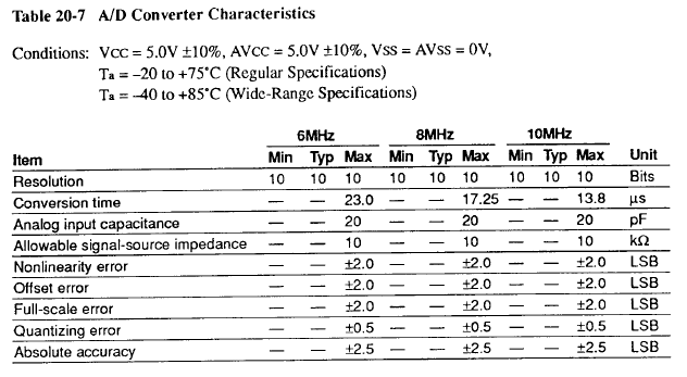

Yeah I understand the joystick was always changing its output impedances in real-time. I don't have a way of measuring that output or the CPU input impedance but the signal does have a 1k resistor (and 0.01uf to ground) before it reaches CPU pins. The input themselves have a capacitance of 15 pF. And I did find this:
And I'm sure the diode circuit has its own effect. I am only used to impedance as an audio consideration where things are okay if the output impedance is roughly at least 10x the next input stage impedance and regularly accept some gains and losses through passive attenuation and mixing etc. So it's confusing for me to see an "Allowable signal-source impedance" with a maximum but no minimum. The clocks are 20MHz and 12.5MHz but it looks like that doesn't change the impedance.
0 for a minimum would work, but 0 is unobtainable except in simulation.
