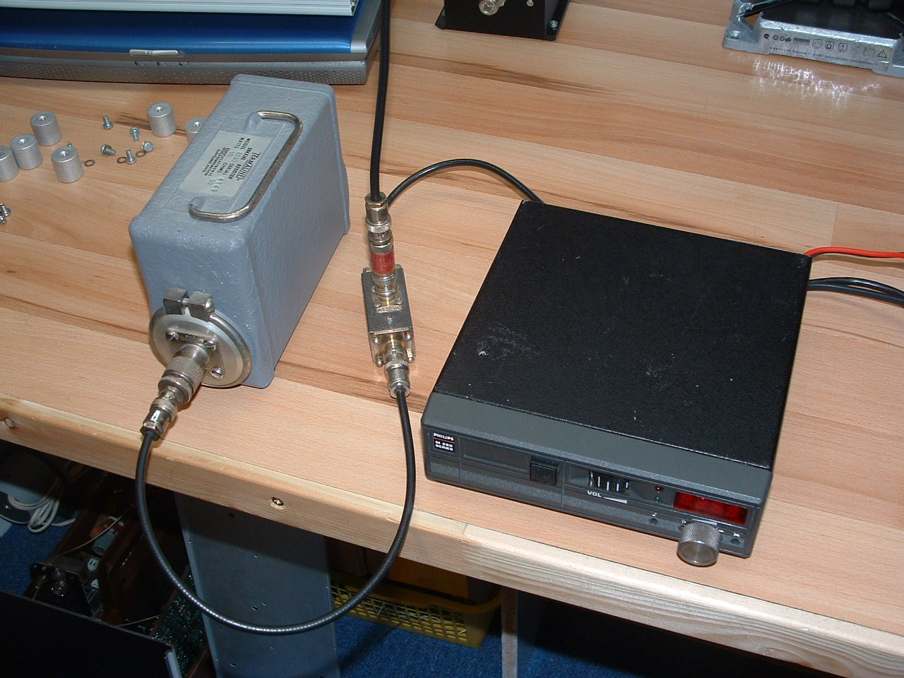

Say we were testing a transmitter which had an output of 100watts.
We would connect the transmitter to a dummy load via a 30dB coupler.
The coupler will create a tap and direct 100mW of power towards the test equipment.

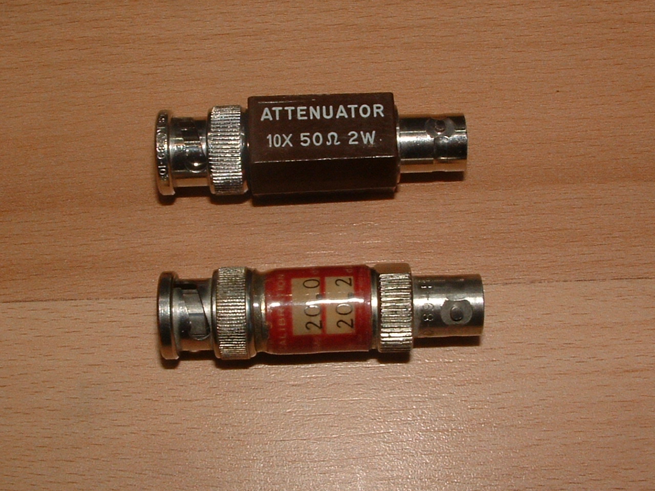

100mW is still a bit much, so maybe put a 20dB attenuator between the coupler and the test equipment.
We will now have 1mW to feed into our spectrum analyser, frequency counter, modulation meter, oscilloscope or w.h.y.
Connect it up like this:
(No, that radio will not produce 100Watts!)

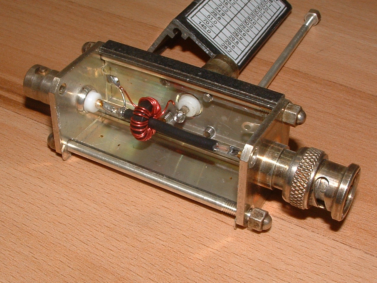

The insides of the 30dB coupler:

A couple of 20dB in-line attenuators:

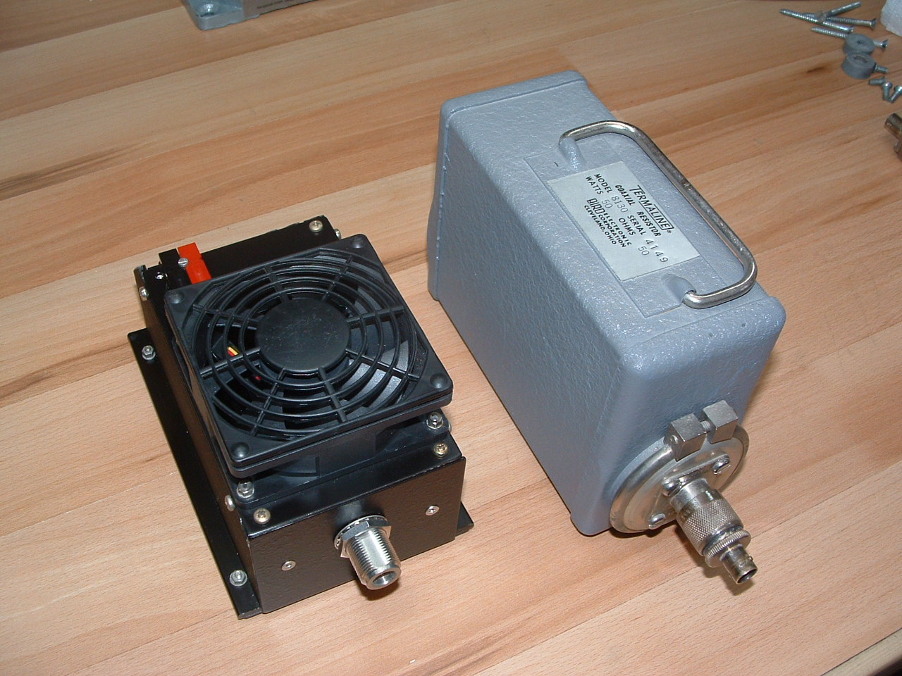

And a couple of dummy loads.
A Bird "Termaline" coaxial resistor as they call it, rated at 50 Ohms 50 Watts, and a home made one which is fan cooled rated at 50 Ohms and 100 Watts (ish).

The coupler is easy to make, you need:
A small ferrite toroid (of the correct mix)
A suitable box.
Three coax connectors, I use BNC.
A short length of coax for the through line.
Wire for the winding on the toroid. 10 turns for a 20dB coupler and 31 turns (from bad memory) for a 30dB coupler.

I used FT37-61. The 37 is the diameter (0.37") and the mix is 61.
Box
Aluminium or a diecast box is fine.
If you are feeling lucky, you could build one from double sided circuit board material.
Attenuators
Are also quite easy to make, only three resistors. But you have to have the right resistors. Sometimes it is necessary to parallel up some standard values to get the correct value.
