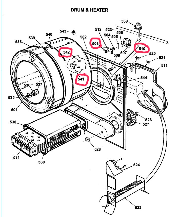

Can someone out there put me straight, I’ve got an old Hotpoint TDC 60N tumble dryer and it keeps blowing the thermostats at the back of the machine where the heating elements are and I'm trying to find out what’s causing them to blow, they are the one shot type.

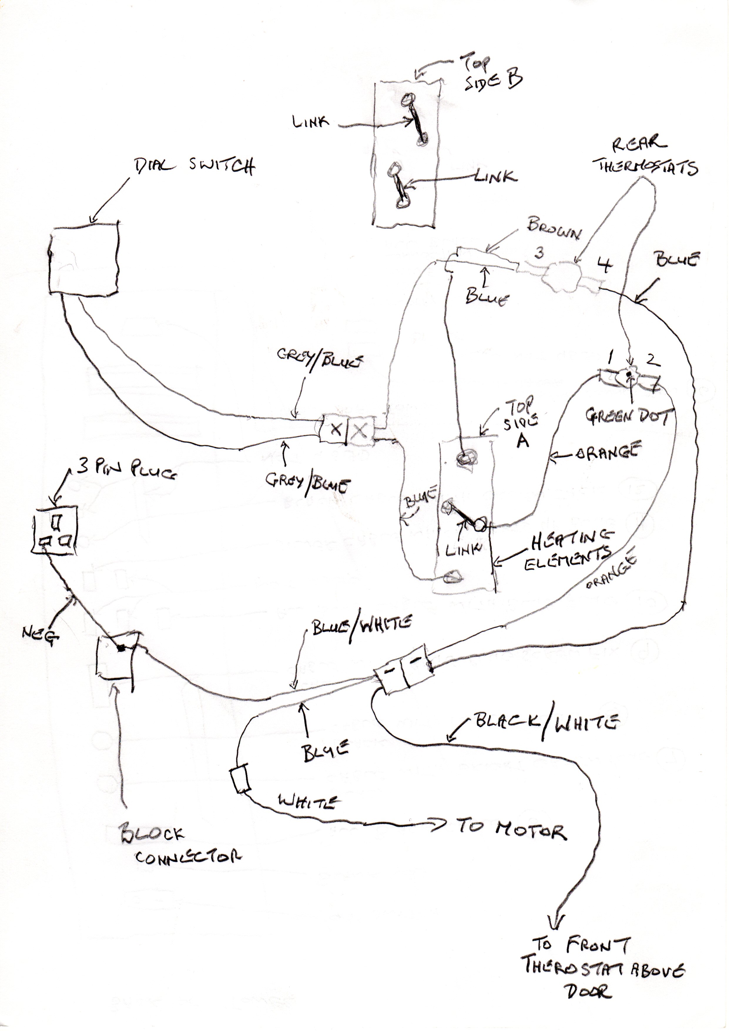

I'm only guessing here but could the cause be the heating elements themselves, I have seen on a website it said for a working heater the resistance should be between 20 and 50 ohms.
Can someone tell me how to perform this test using a multimeter, I’ve included a sketch of the wiring coming from the elements but I'm uncertain where I should place the test leads in order to perform the test, if someone could mark on my sketch where I should place them that would be great, well at least I will be able to eliminate the heating elements.

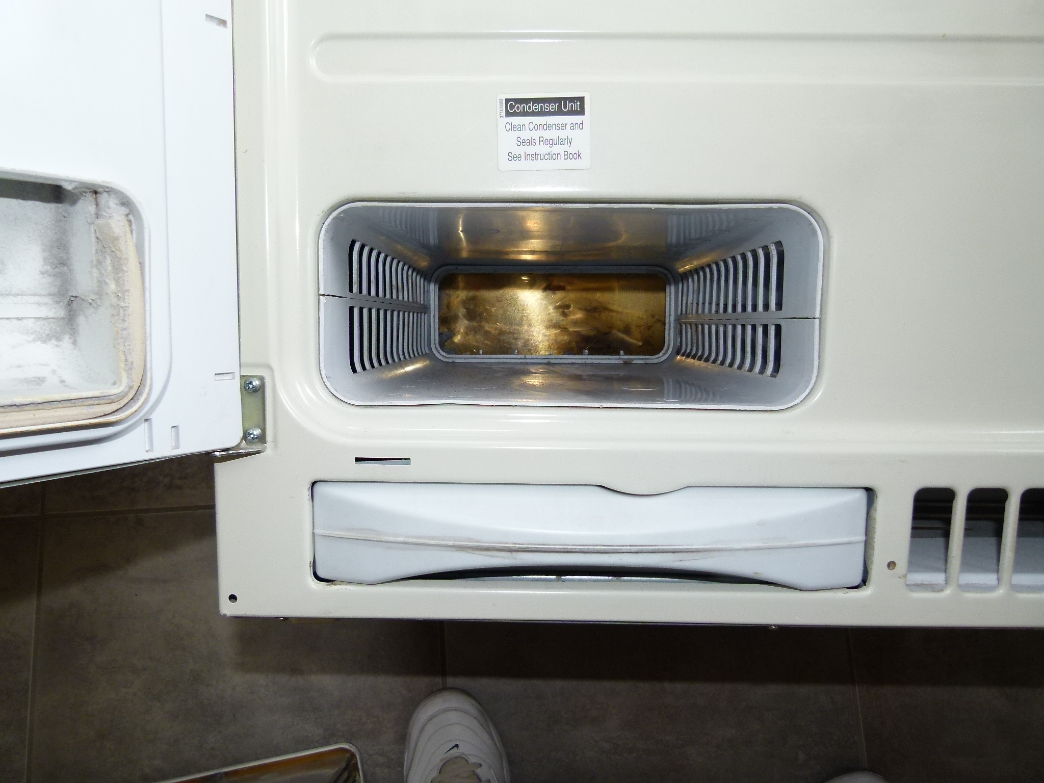

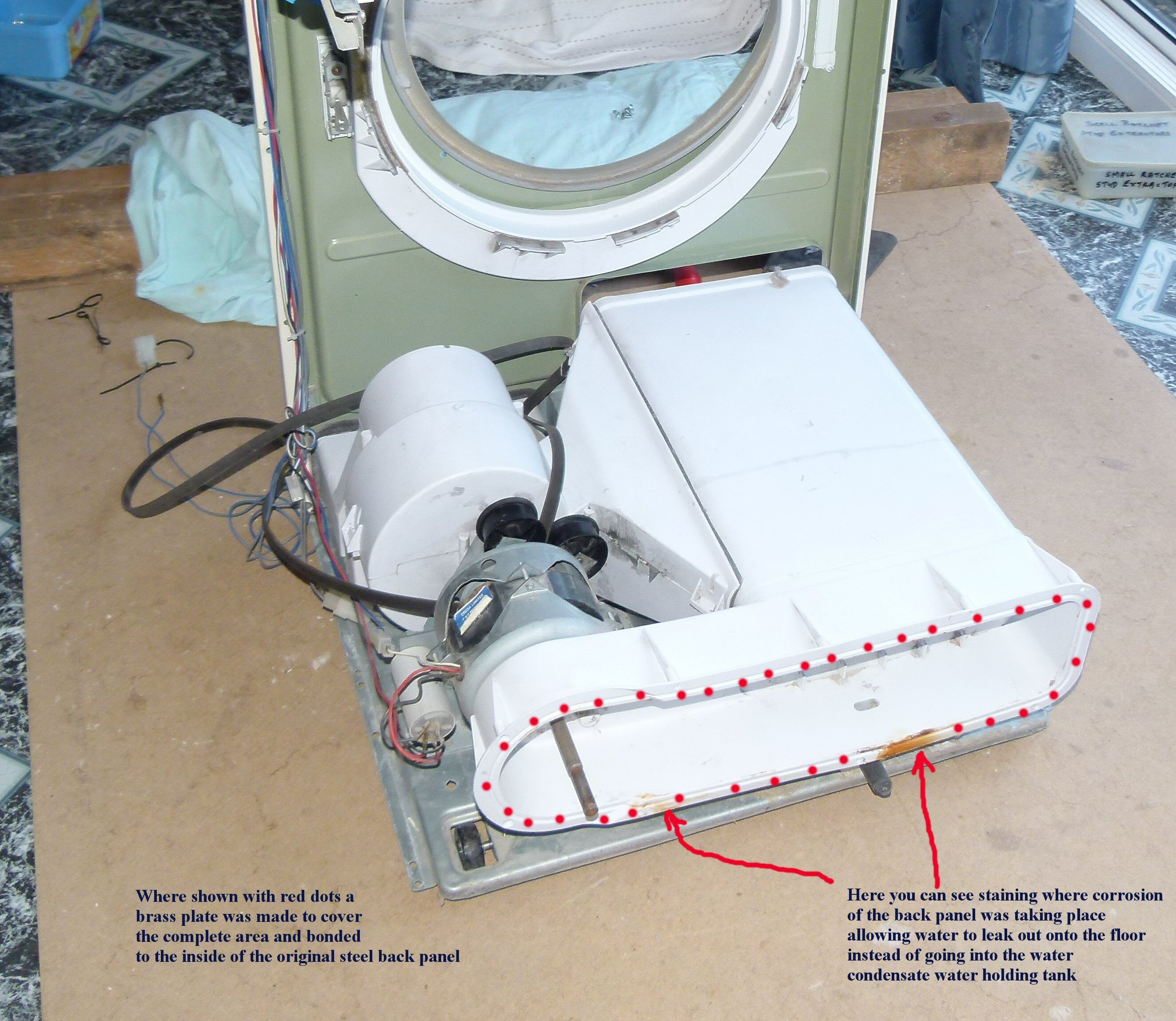

JonSea there are no blockages as the machine has recently been completely striped down because the steel back panel had corroded through as it’s a condenser dryer not a vented one and the steel had become porous where the condenser contacted the back panel to which I’ve bonded a thin brass plate to the inside see photo, also the fan is working fine which is driven by the drum belt.

Which brings me back to where do I need to put the probs of the test meter in order to check the heating elements are within the correct resistance range.

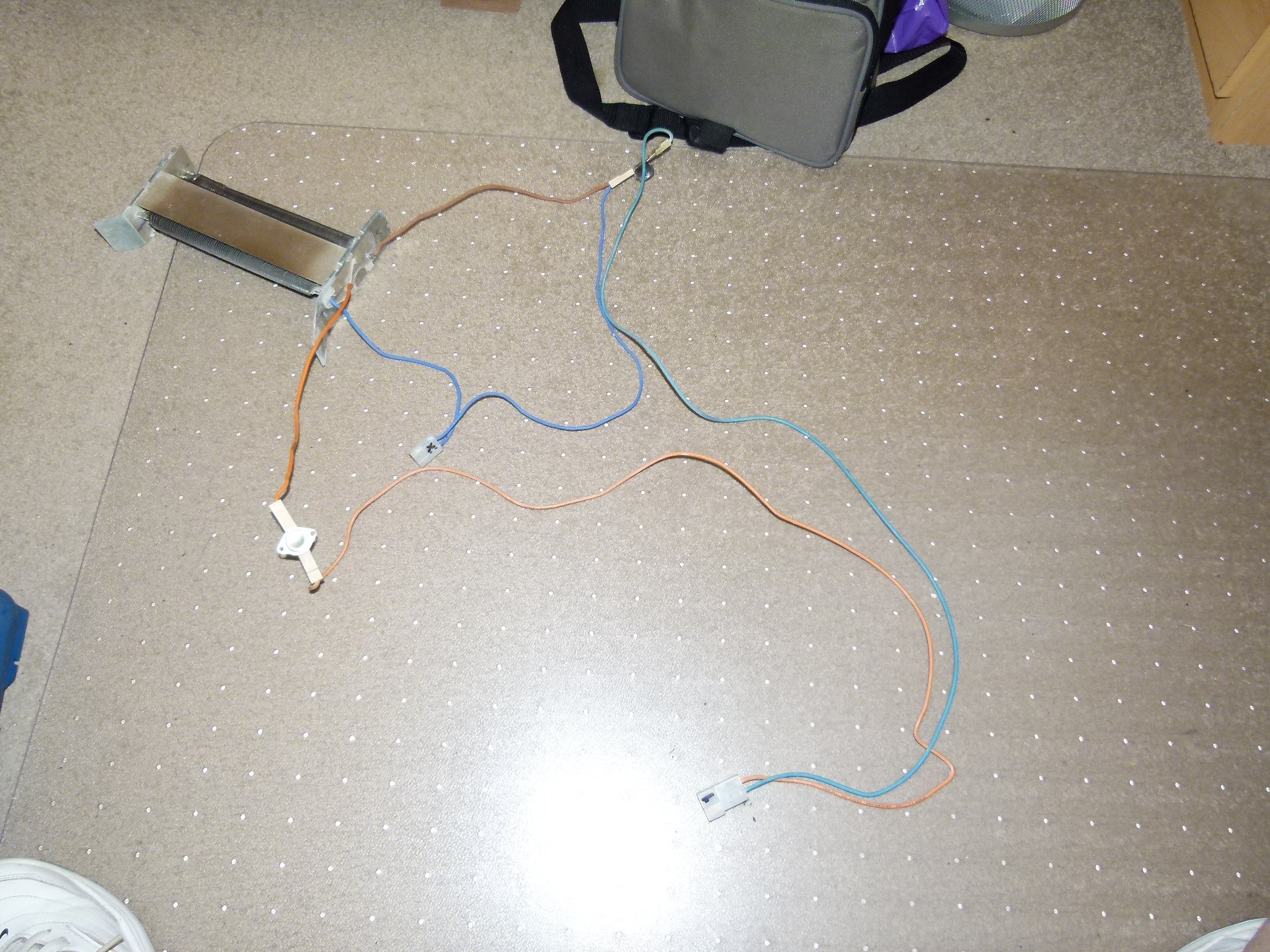

I know I’ve not shown the wiring circuit for the complete machine, only the wiring from the two thermostats and the heating elements which consists of four coils but I still need to know where I need to attach the multimeter probes in order to perform the test.

I can;t tell what's going on, BUT you have three wires going to the heating element. take the resistance to all three.
You will likely find 1-R-C-R-2
call it 1 for element 1, Some R, Common, Some R and 2 for element 2.
So, if the element's resistance is too low, your going to ruin a contact (thermostat - whatever).
So, i would EXPECT both elements to be the same R and it's possible that only one element is used sometimes. e.g. A high/low heat setting.
Look also for conductive paths to ground. e.g. a discoloration that gets wet.
Loose wires will kill contacts too.
