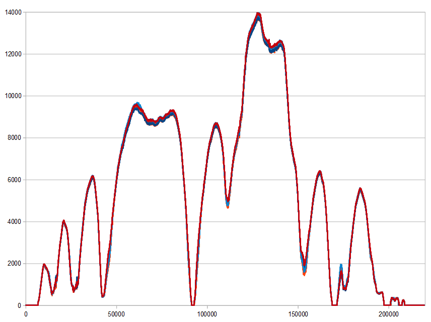

That comes from TRACERT FORD EDGE - Driving some minutes-2.
It is from frame ID 0x260 byte 1 concatenated with the top nibble of byte 2
For instance, at 17493.8 ms, frame 260 had a value of 00 1F E0 00 00 00 00 00, so they signal I took would have been 0x1FE. That has a decimal value of 510.
My best guess is that the signal represent throttle position.
Later I will take video of the ODO (of the Ford Edge) while I drive so you have a better idea of the trace.
I ask, how do you transform the tracer data into that graph??
I used a spreadsheet to sort the data so that all the frames from one ID were together, and in time order.
Then I looked for data that was changing. Within the changing data, I looked for where values went from FF to 00 and then found other values that increased by 1 each time that happened.
Here byte 2, the right hand column only has the top half changing. There are two instances where it goes from a larger number to a smaller number and at the same time byte 1 increases by 1.
F -> 4 while 0 -> 1
C - >7 while 1 -> 2
( A very short time later byte 2 goes from B to A and byte 1 does not change, but I think that the value being represented had stopped changing at that point, as there were two instances of B before that)
Anyhow, I used that observation to apply this formula to all the data.
=HEX2DEC(E1)*16+HEX2DEC(F1)/16
(column E is byte 2 and column F is byte 3. I copied that down the whole of the data from the 0x260 frame, and plotted a graph of that against the time from the first column.
I've found what I am virtually certain are the speed signals from the four wheels.
Frame 0x215 has the four speeds, each as a 2 byte number, in units of 0.01 kph and it is sent every 10 ms. This is what I have seen on other cars, such as a Jaguar X-type, which was Ford based architecture.
All four wheel speeds are similar, but there are slight differences when you look in detail, likely due to slight differences in wheel diameter, plus the speed differential in corners.
There may be other speed signals, so these might not be what the speedometer responds to.

The Excel sheet for the whole log is quite large. The one for the speed only is here:-
https://mtrak.co.uk/pictures/215_frame.xls
You can use Excel or Notepad++ to sort the data so that all the frames with the same ID are together. In Notepad ++ you can search the .trc files for
Rx 0215
Just select one instance of that from the file, then copy, ctrl-F to find, paste into the find box, and click on "Find All in Current Document
I have found it better to have short traces of about 30 seconds where you have made something happen during the trace. Maybe altered the speed, or started the engine or something. Files of that size are much easier to handle in Excel. If you have a 5 minute trace with a video that will be much more difficult to find events in than 10 traces and 10 videos, each of which has a known event in.
Your car has the wheel speeds on the frame with ID 0x215. The Jaguar X-type that I looked at before had the wheel speeds on ID 0x4B0, which is the same as on the list that you found. However other details are not. You have to check any IDs that you use as they may change between models and years.
I think that there is some confusion between decimal IDs and hexadecimal IDs. On cars, the 11 bit CANbus IDs are used, which go up to 0x7FF, which is 2047 in decimal. The last item in your list is 1425, which is 0x591 in hexadecimal. That is the frame number of the message used to keep the speedo awake. I suggest you stick to hexadecimal IDs.
