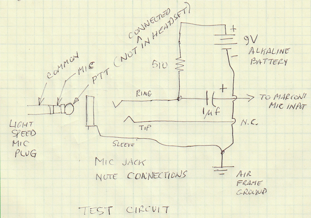

Re our phone conversation about how to cobble a test circuit to see if you can get audio from the Lightspeed mic into the Marconi: Look at the attached circuit. Note that the Lightspeed's mic is between Ring and Sleeve. Tip would be the PTT contact (to Sleeve) if the headset had a PTT button, which AFIK your's does not.
See if you get any audio out of the Marconi with this temporary test circuit. The level may be way too high, but I have a fix for that. Goal is to get any audio at all. If you get audio, let me know and I will design an interface...
Tried the circuit (I used a 470 ohm resistor) - nothing - even tried shouting. For troubleshooting purposes:
Using Lightspeeds - 9V battery connected or disconnected - can hear yourself in headsets when xmt NOT pressed (ie intercom mode)
Using Lightspeeds - 9V battery disconnected - can't hear yourself in headset when press xmt.
Using Lightspeeds - 9V battery connected - can hear yourself in headsets when press xmt.
Bias voltage across mic is 4v when using intercom function, and 4-3 volts when xmit pressed.
I modified the circuit to run from the 28v aircraft buss by dropping the voltage using a resistor/potentiometer combo of between 1000 to 1400 ohms. Still nothing but now you get a steady 4v across the mic.

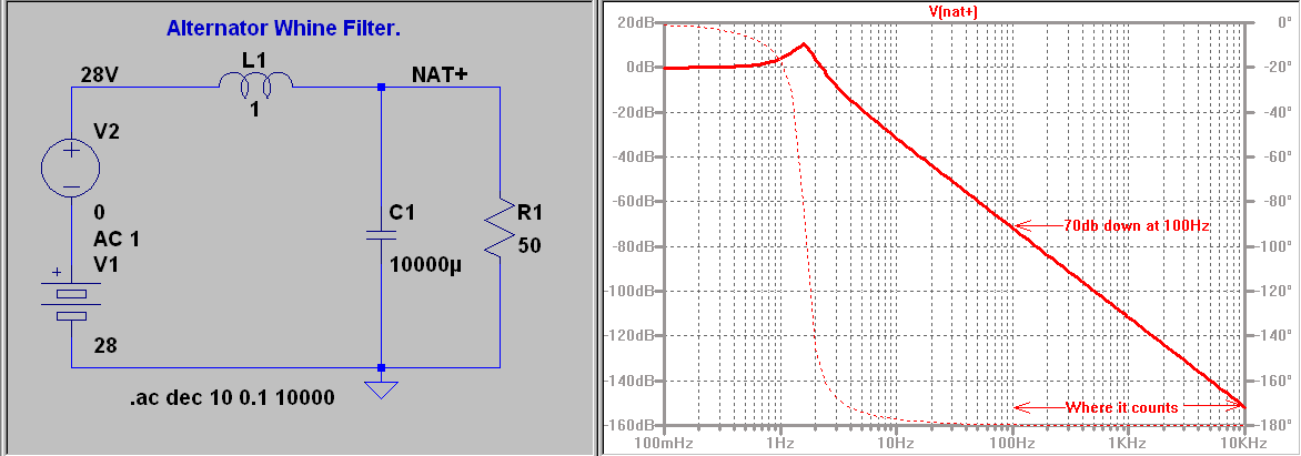

Here is some more evidence that some avionics installers don't know what they are doing.
Also attached is a simulation of the whine filter.

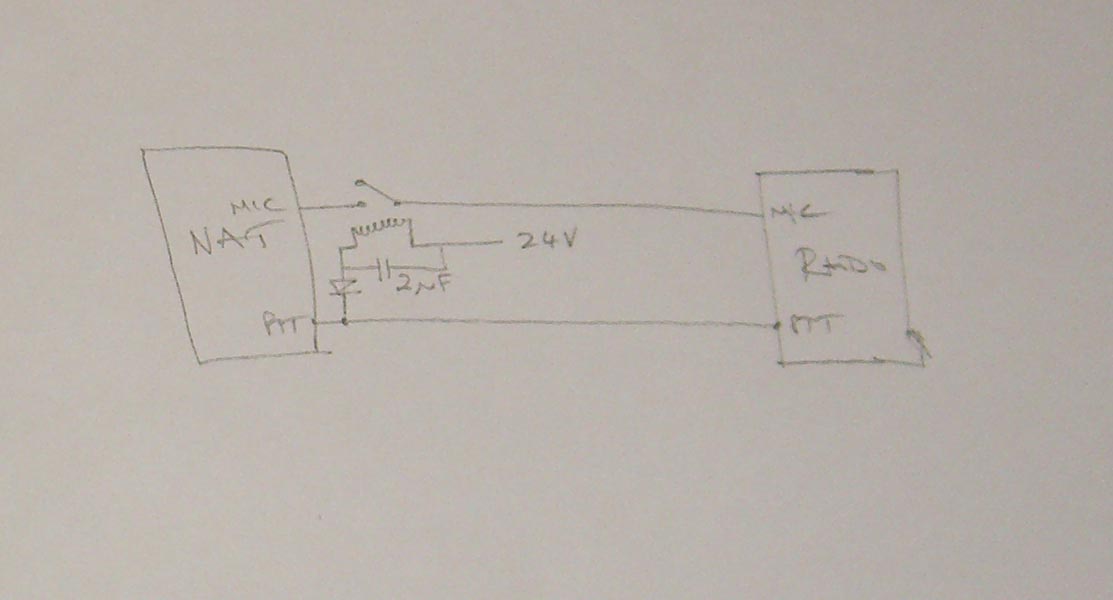

solution to alternator whine
here is a wildly simple solution to the alternator noise I hear in the headsets. You can only hear it when NOT transmitting. That's because in non-xmit mode you have two pieces of equipment connected with grounds that are physically separated but in xmit mode the headsets are connected directly to the radio so only one ground in that mode. At least that's my diagnosis.
The relay is a 24 volt. Do you agree with the 2 micro-farad capacitor across the relay (will that reduce bounce currents?) and the diode? Just a gut feeling.
For more reliability, I may add a second relay in parallel?

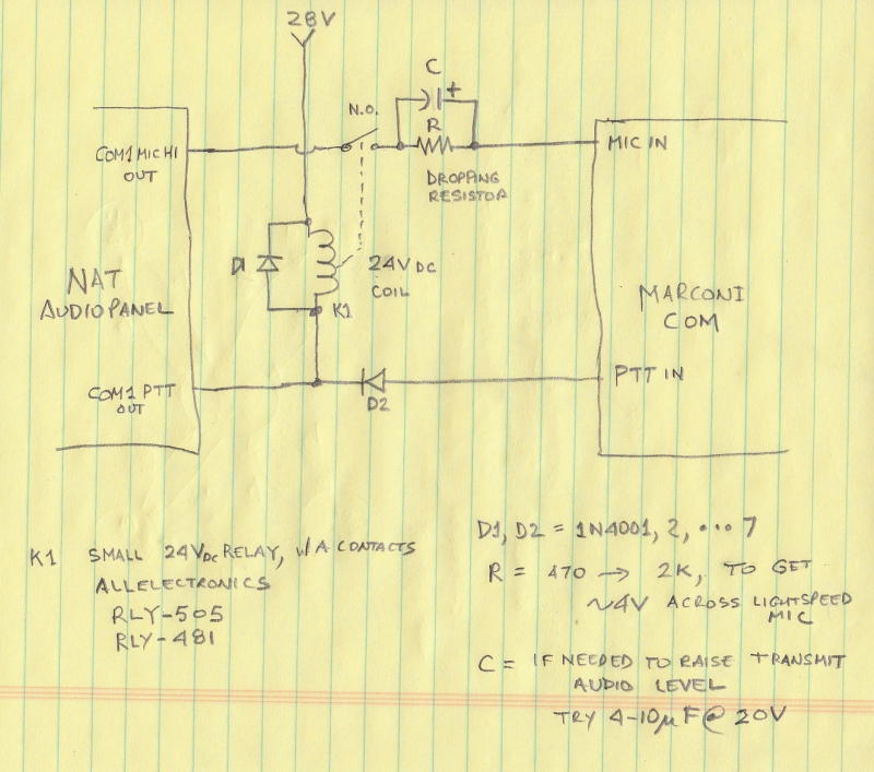

OK. That is a useful observation. However, I have lost the bubble regarding what is the current state of the Mic connection between the Marconi COM and the Nat Audio Panel? Have you bypassed the mysterious resistor/capacitor network and replaced it with a direct connection?
If so, do you have a resistor between the Nat "Com1 Mic Hi" and the mic wire to the Marconi to reduce the DC voltage across the Lightspeed Mic during PTT? If so, it is desirable to keep the Lightspeed Mic voltage at 8V or less while transmitting.
No. The capacitor there will harm the PTT switch. It is not needed. A 1N4001 through 1N4007 diode across the relay coil (cathode to +28V, anode to the switched end) will suppress the voltage spike produced by the relay coil as the PTT switch opens.
I would add a second diode as shown in my diagram below. This is to prevent the relay coil sourcing current into the Marconi's PTT line.
I wouldn't. Putting two of anything doubles the probability of a failure. The relay below is cheap, so buy two and keep a spare :D
Suggested relay has Double Pole, so just parallel the two normally-open contacts. That relay may have an internal suppression diode across the coil built-in inside the relay. If so it matters which end of the coil goes to +28V and which end goes to the PTT line. If the relay does have the internal diode, leave off D1.

To bring you up to speed:
Bypassed the mystery capacitor/resisitor network with a new shielded line to the NAT.
Used a resistor (1.4K ohms) with capacitor in parallel to drop bias voltage to about 4v when xmiting.
I can hear several noises in the Mic audio line, 90% is the alternator.
If you pull the mic line in to the NAT, noise ceases.
If you shut of the alternator in flight, noise ceases.
If you press PPT, noise ceases (this, I imagine, is because by pressing PPT you connect the mic directly to the radio, bypassing the NAT and so eliminating for that moment the ground loop).
EVERYTHING is grounded! NAT to NAT case, all shields, radio to radio case, shields at radio end plus I think the headset shields also. This relay idea seems to be a reliable, simple solution.
The circuit with the relay is a success. No more noise.
