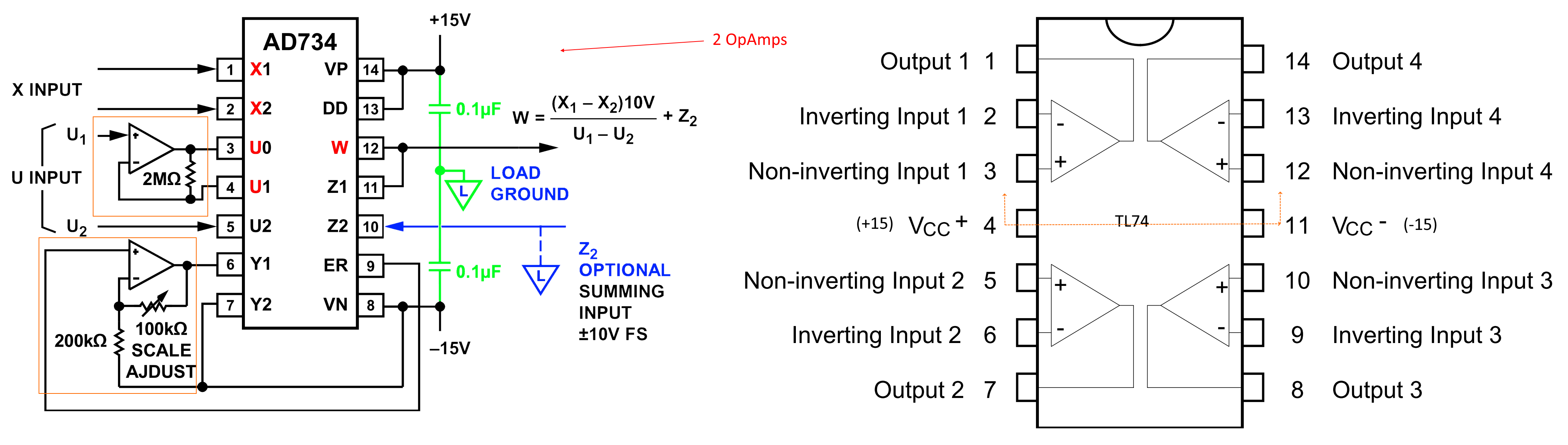

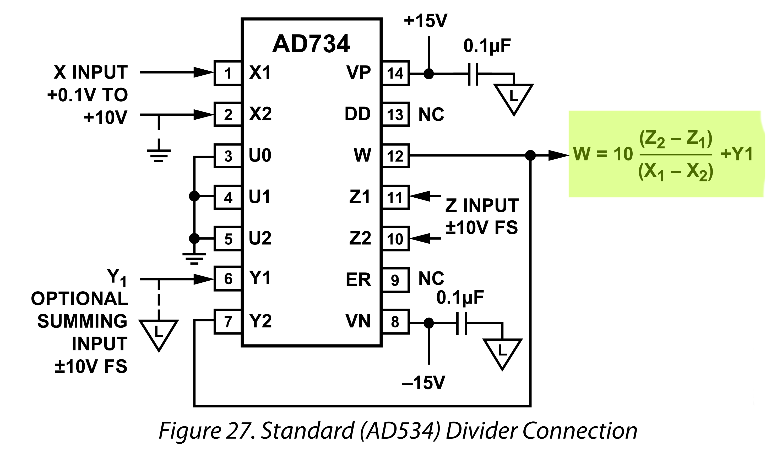

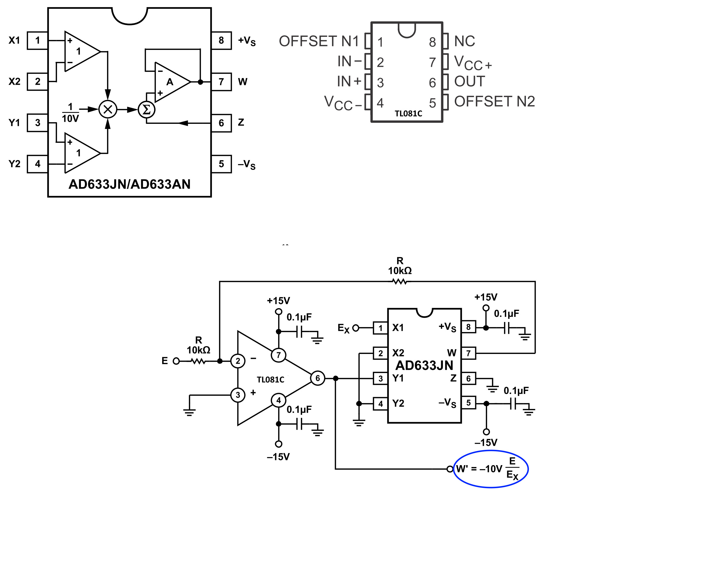

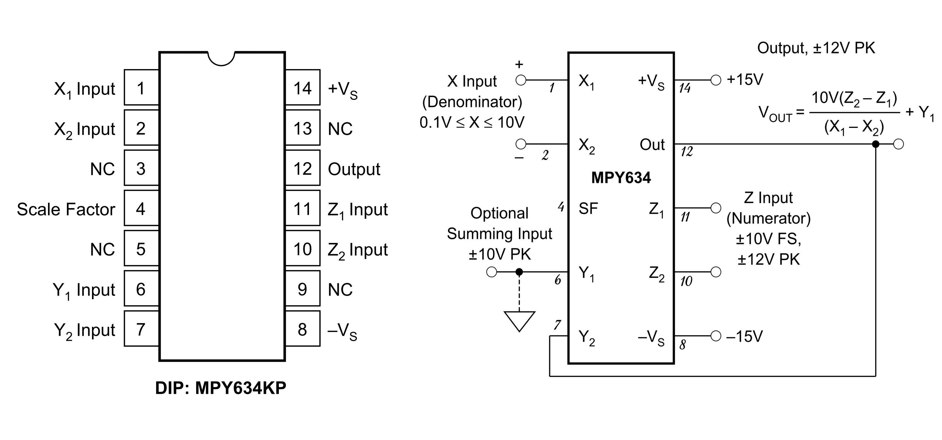

Hi guys,
I'm stuck.
I tried using the following scheme conficurations on a breadboard, but always get a the unique ~ 14V result, without any influence of the two voltage sources:
Attached are the implemntation circuits I used.

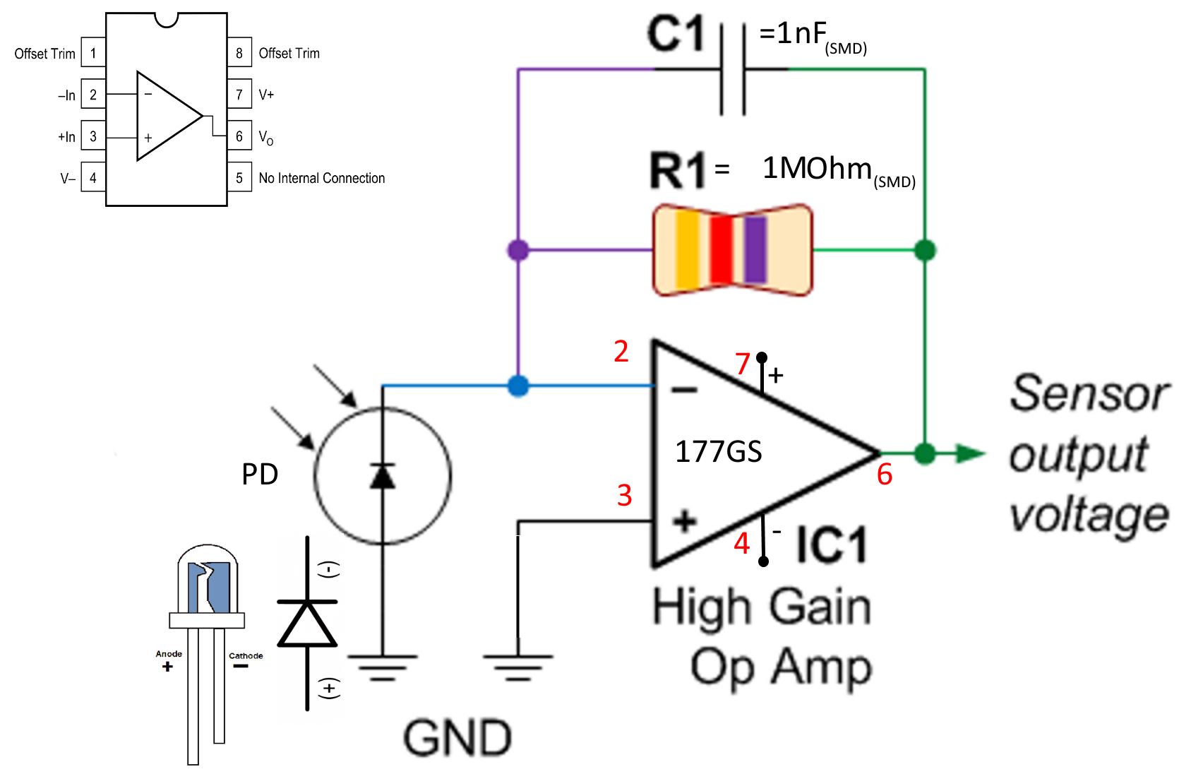

- "loads" are the same - preamped photodiodes of the same nature and with a 100KOhm feedback resistor (& parallel 0.1uF capacitor - which give bot when connected to the circuit and when sampled on their own ~ 0.2V-14V, where the 14V is only under direct ilumination, so ambient light ~ 0.2-0.5V). Maybe I need to replace with 1MOhm to producemore than 1V, but I doubt that this is the problem.
I've checked that I'm getting the +15V, -15V and "0" as source to all circuits (my "0" is also my "grd", as I don't see how this can be implemnted otherwise).
I did not opt for the "optional" configs, just a straight wiring with jumpers, necessary resistors and capacitors as suggested.
Any help in understanding why this doesn't seem to work will be greatly appreciated.
-After posting, I switched the RC photodiode feedback to 1MOhm & 1nF (SMD), and got better ambient light response - but still "no cigar"..

it might be helpful if we saw the actual schematic of what you have built. the schematics shown are yanked from the data sheets. also, for LEDs to work properly as sensors, they LED's output spectrum (when it's used as an LED) should include the color of the laser. a red LED would make a good sensor for a red laser, but a green or blue LED would not.
There are no LEDs in the circuits. The only Q is if you can see why it would behave like this, and LEDs are NEVER used as PDs.

your sensor circuit shows an LED being used as a photodiode (as a matter of fact it actually references the sensor as LED1 ) helping you with your question isn't going to be easy since you haven't posted an actual schematic of what you have. you toss out 4 examples yanked from data sheets without showing any connections you have with any sensor circuits that you have assembled. then you rant in all caps because all we can do here is guess because you haven't provided any useful information. so, sit down take a breath, calm down, and post a schematic of exactly what you are working with.
Then Sir, you don't know a lot about the nature of LEDs vs. Photodiodes.

The thing is, that for roughly equal loads (provided by the two PDs) it should yield ~10V, and when you shine uppon the numerator, it should decrease, while increasing when the denominator gets more light.
If these configurations yiled 14V and are barely influenced by loads that repeatedly yield between 0.8V - 14V each, when hit by intensified light (such as shining a bright white LED closer and closer to each one), then something is not working, which in these cases is the situation.
I'm hoping that someone has the experience or just a discerning eye, that can shine a light as to what's wrong here.
