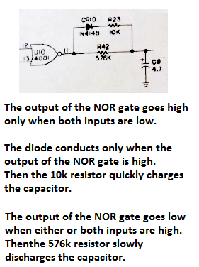

Why don't you know the function of a NOR gate? "When either or both inputs are high then the output is low. When both inputs are low then the output is high".

Take a look at the schematic again
do you see the RC network with the diode on the NOR gates output , what type is this?
What type of RC network is that , what does the Diode do? it discharges the cap?

The output is always low. Why do you say, "also not high"? Do you want the output of the NOR gate to be high?
It is a positive peak detector. The diode conducts when the output of the NOR gate goes high then the 10k resistor quickly charges the capacitor.
When the output of the NOR gate goes low then the 576k resistor slowly discharges the capacitor.
Why is their a positive peak detector? Without the diode what would make the difference? Having a peak detector does what for an RC network?

Why is there a positive peak detector? Without the diode what would make the difference? Having a peak detector does what for an RC network?
The peak detector function uses the words "quickly charges the capacitor" and "slowly discharges the capacitor".
Telling us the voltages at the pins of the NOR gate is meaningless since we do not know its supply voltages.
We don't even know what the circuit is supposed to do.
how does the peak detector charge the cap faster?
ii thought the diode just clamps the voltage, but the nor gates out is always low , so what is it peak at?

I guess you do not know what a diode does and you do not know Ohm's Law. See my attachment.
No.
The output of the NOR gate goes high when both of its inputs are low.

What I don't understand is how is the diode a Peak detector? is it clamping the HIGH state voltage when the NOR gate goes HIGH?
A silicon diode has a forward voltage drop of about 0.6V at low currents.
The output high of the NOR gate is about +12.5V and the diode voltage is 0.6V so when the capacitor is completely discharged then the voltage across the 10k resistor in series with the diode is 12.5V - 0.6V= 11.9V. When the output high at the output of the NOR gate makes the anode of the diode high then the diode is forward biased and it conducts. The capacitor is quickly charged by the NOR gate, diode and 10k resistor. The capacitor charges to a 11.9V peak.
When the capacitor is fully charged and the output of the NOR gate goes low then the cathode of the diode is more positive causing it to be reverse biased then it does not conduct and the 10k resistor does nothing. The 576k resistor slowly discharges the capacitor.
Their is the peak voltage , i get it now , so it does clamp the voltage
I wonder why they wanted to charge the voltage at 11.9 and not at 12.5 volts , any reason why?
It shortens the charging time it seems
